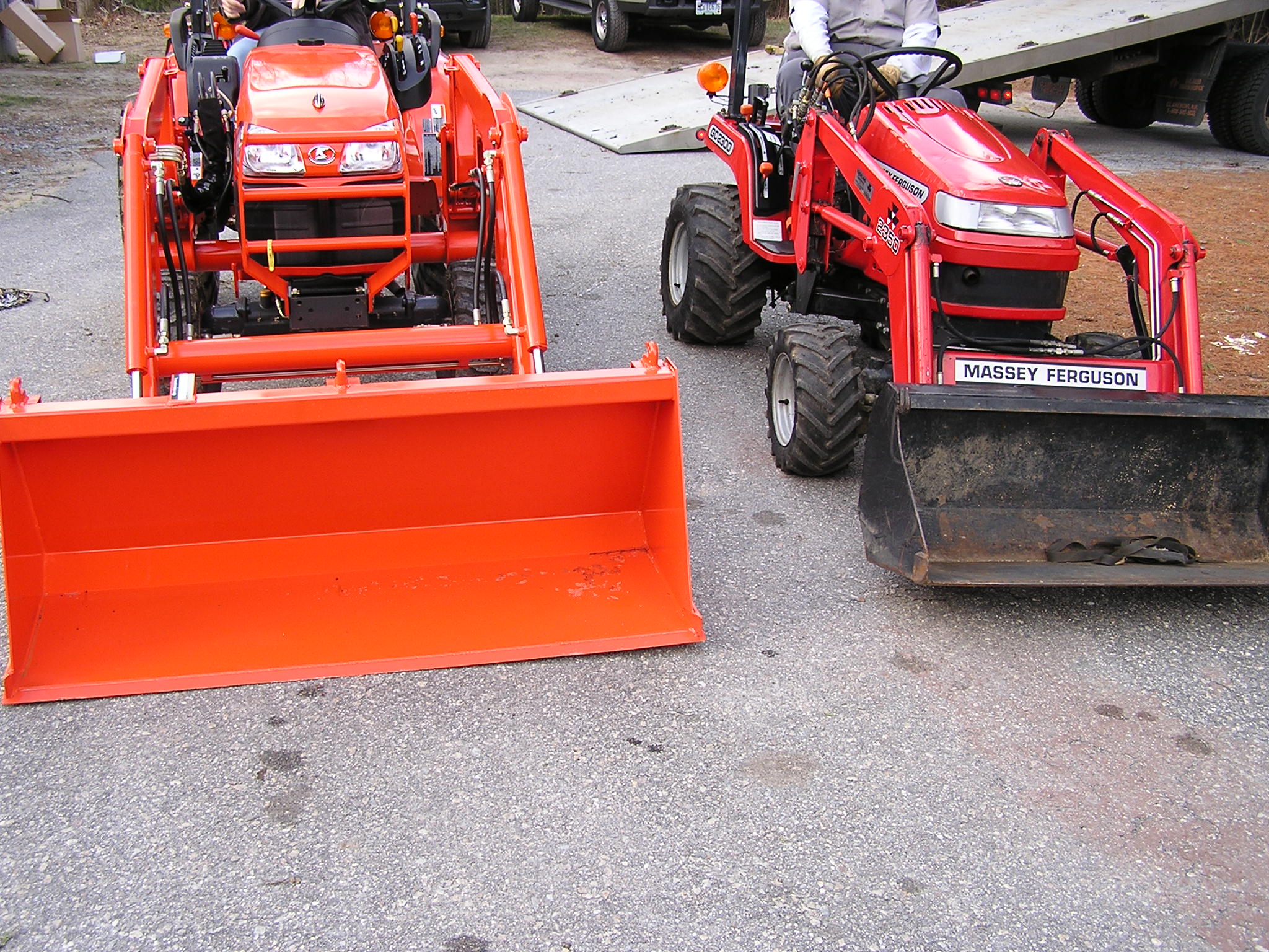

My dealer welds three short pieces of angle iron on the top of the bucket. One on each end, and one in the middle, and then mounts the hooks to those. I like that approach very much, and I haven't seen one of the buckets done that way damaged. Here is a photo of one he did. It's dark, and cold out there right now, but if you want closer photos, I'll take some of mine for you.

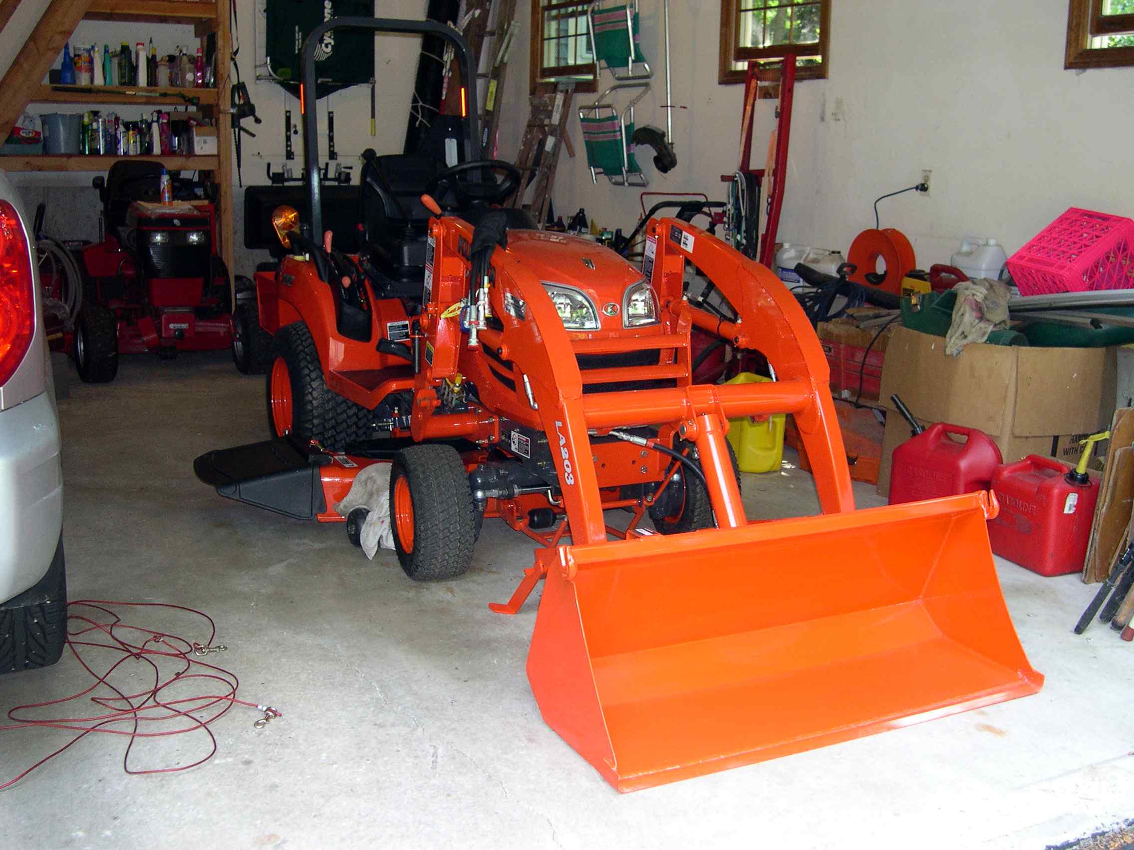

My dealer mounted my hooks similar to LearJets, except turned 90* up. I never specified where I wanted them and when it was delivered, the salesman said that where they put them was the best position for the BX loader. There really isn't a flat top edge on the BX loaders so it seemed to make sense to me. Never had any issues with clearance, but mine are tighter to the bucket than LJ's.
Here's a pic of the BX1850, prior to trading it back for an 1860. I kept the loader.
