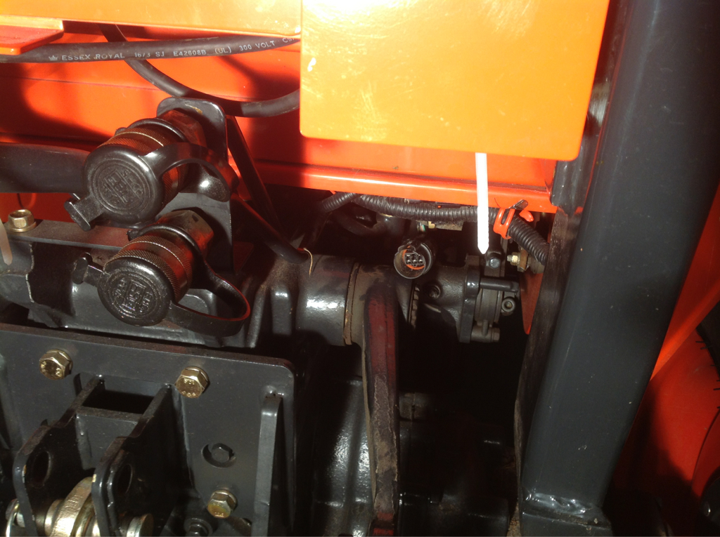

Kurt, I have an A and B remote on my ck35hst. I think the dealer is calling this one set. There is an A-N-B lever right side of seat. I love the idea of those stackable valve blocks. Looks like a simple install, not much hydro plumbing and only an electrical switch to run.
Correct, anyone could install it, if they can wire up an electrical switch. The rest is just some screws to mount the valve stack, and plug in the input hoses to your existing OEM remote. With no solenoids activated the flow goes right thru the stack out to the set of quick couplers on the right hand side of the stack. The input from the OEM remote quick couplers goes in on the left hand side, and when any solenoid is activated electrically, the face of that section's quick couplers has the flow path. You can have one valve for a total of 2 remotes, or 2 valves for a total of 3 remotes or 3 valves for a total of 4 remote outputs. You will need the proper stacking bolts for either a 2 or 3 valve stack.. If I ever get any money, I intend to get at least 2 valves for a total of 3 remotes.
