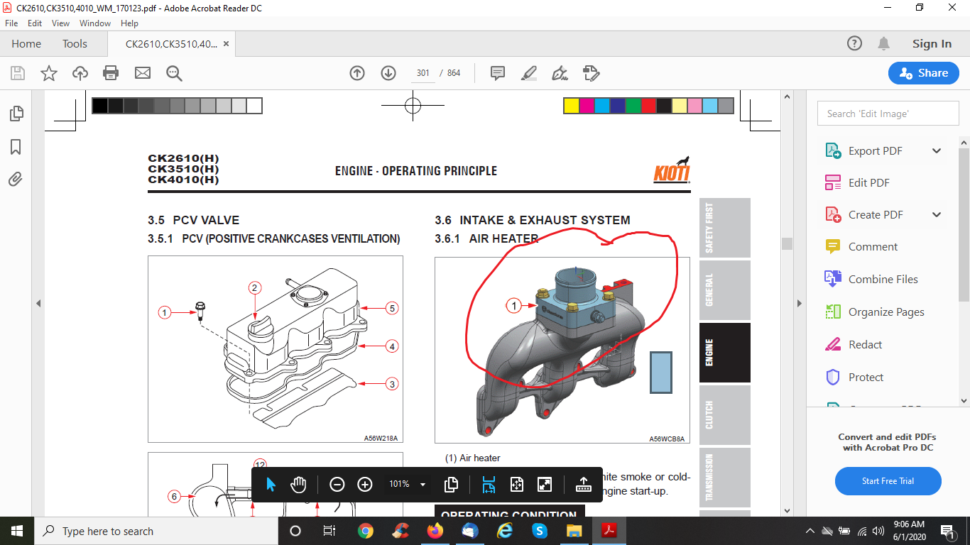

Make sure the induction pre-heater is working (at the intake manifold entry). Makes a huge difference at cooler temps. Throw an amp clamp around the wire they draw 30 plus amps when they are working correctly.
I disconnect mine in Summer by removing the fuse. You'll know it's right if the tractor idles a bit higher after 20 seconds or so, the lower idle when first started is because the alternator is trying to power the induction heater and putting a load on the engine.
