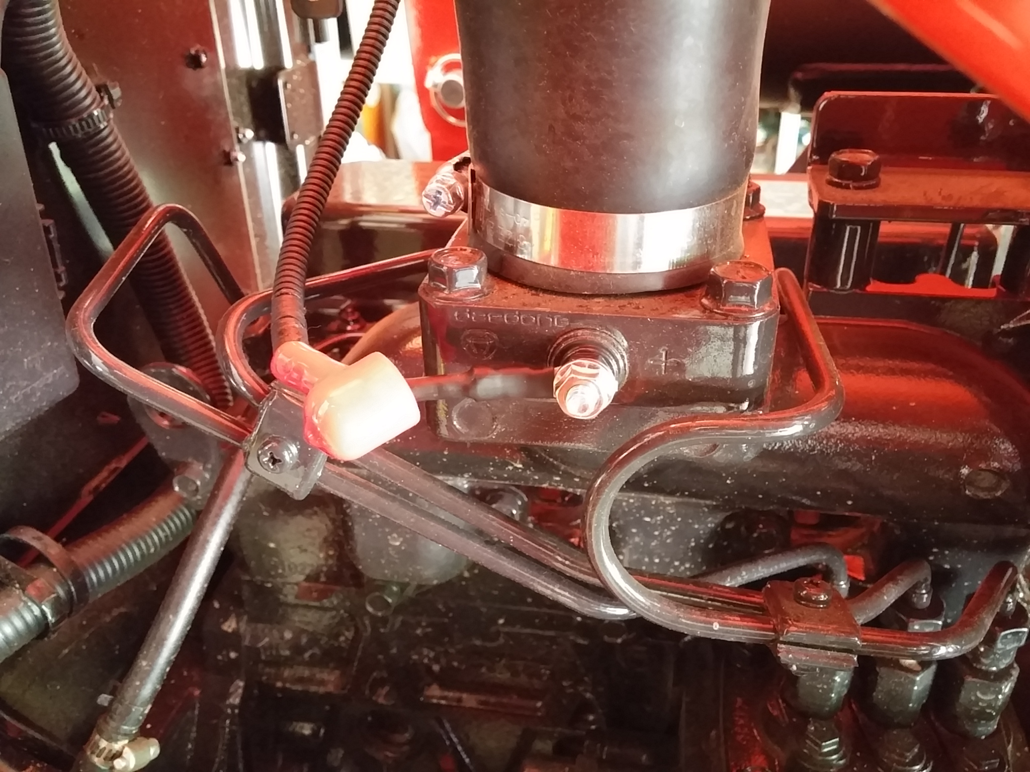

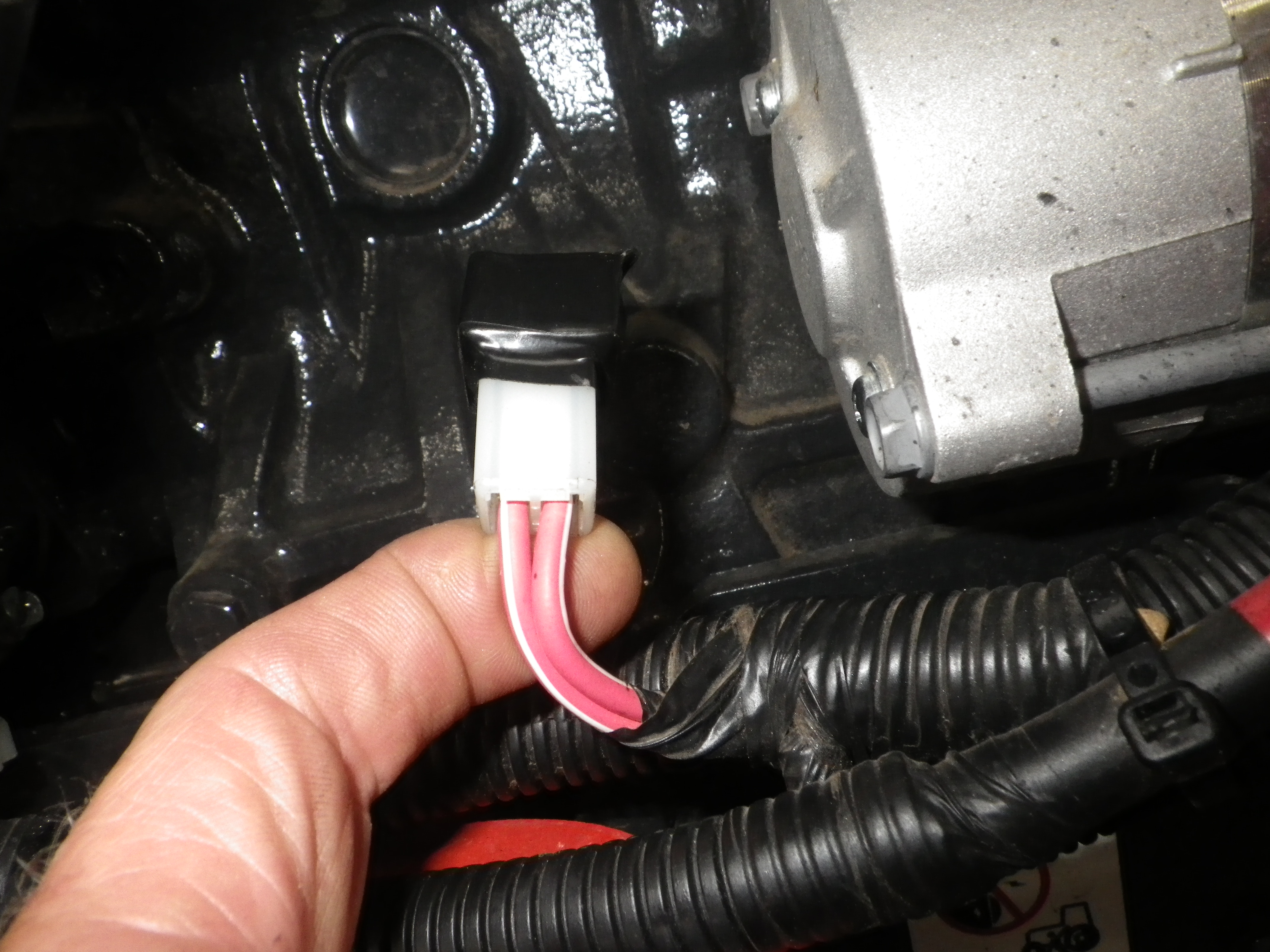

Before you go further test the connection at the piece I showed you there. Mine melted the connector at that picture location with just 5 hours on the machine. I don't find that cycling the plugs twice is really needed but mine is performing as designed. I DO however need one full cycle of the plugs, turn the key on and watch the glow light, it takes a couple seconds to come on after the instrument cluster self test. Wait until the light goes off and fire the engine, it should run fairly smooth if you let it go a full glow plug cycle.
I notice on mine it will smoke white a little bit and run rough IF the intake pre-heater fuse is pulled. Do you have a test light? If so when you start the machine check for 13.5ish volts at the pre-heater connection. If you have volts it still doesn't mean the grid is using it, that requires an amp draw test. Also if you start the engine cold and feel heat at the connector under the rubber boot at the pre-heater grid you might have a bad connection there; it's an 8 or 10mm wrench size (can't remember).

I used an off the shelf connector crimped and soldered. Mine burned right at the connector there in the picture on the right.

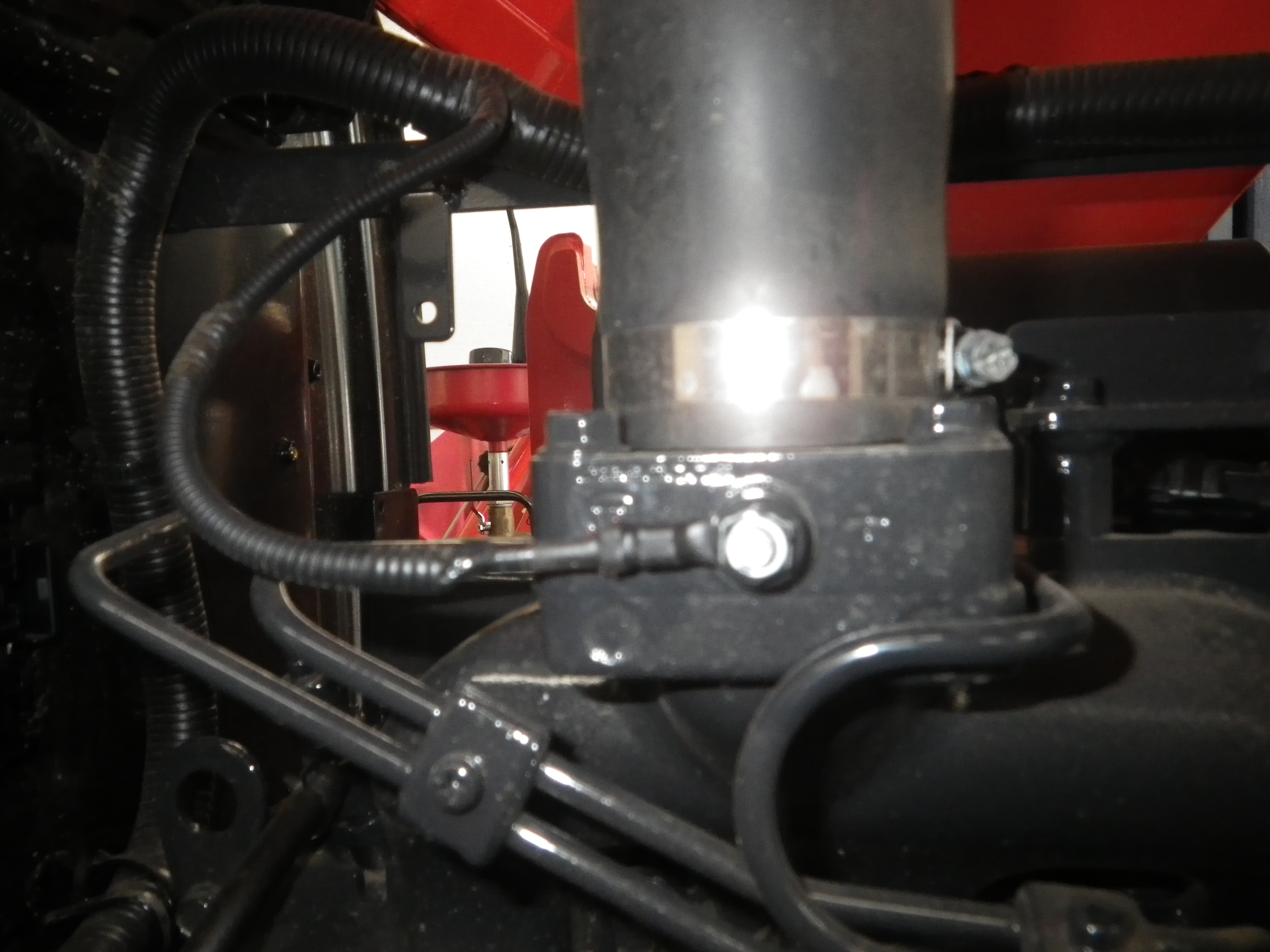

If I am looking at the right connector, mine looks fine. 20200601_121921.jpg
I will still get some electrical testing done on the next start.
