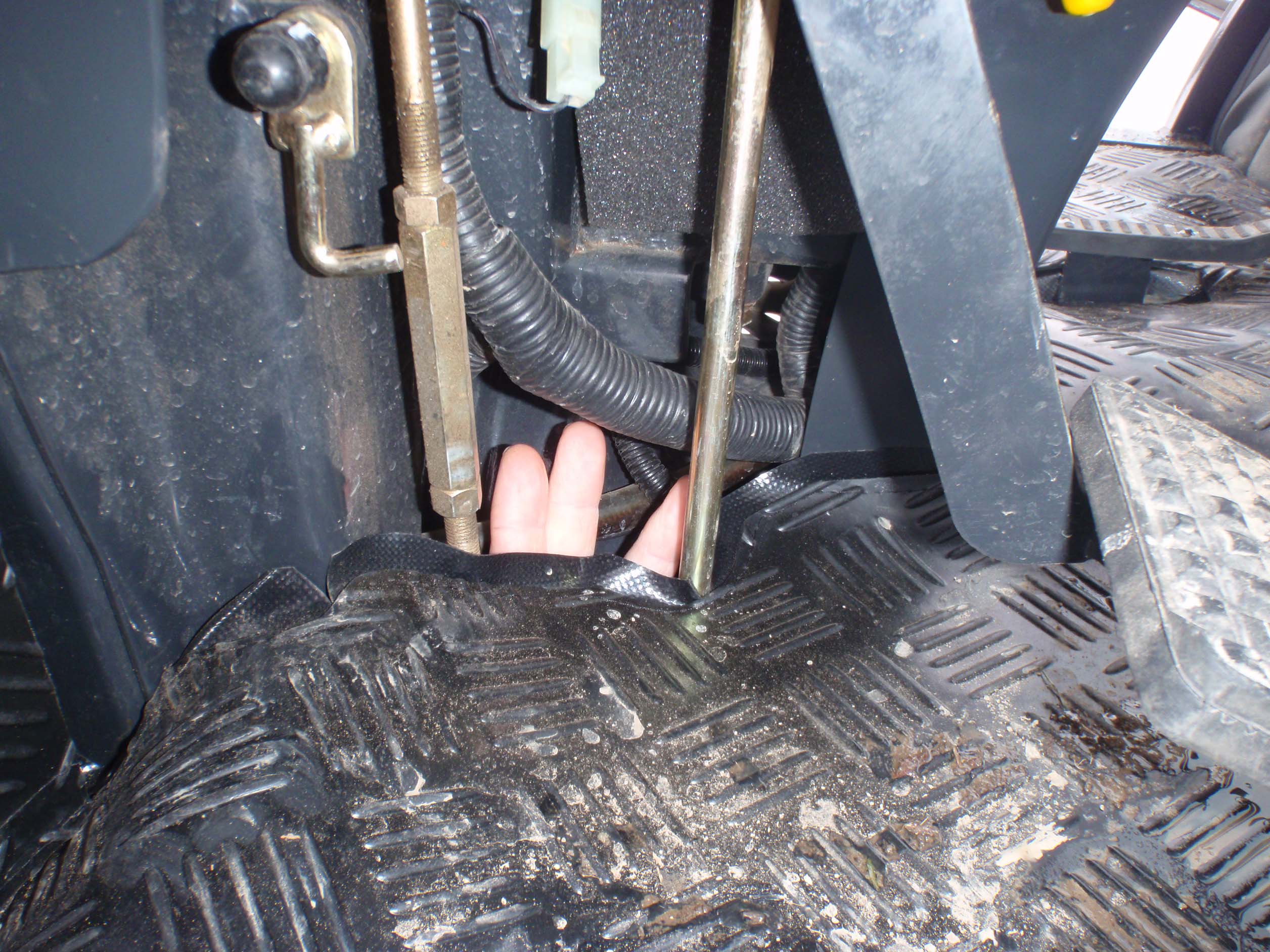

Well, I couldn't resist the $1500 rebate Kioti was offering on cabs for the CK27-35, so I pulled the trigger and had one installed. I've had the tractor back for a week and I'm getting used to the cab, so here's a few pictures and a bit of a review.
Like everything else I buy, nothing goes smoothly, and this cab is going to fit right into this category quite nicely. I don't have too many good things to say about it so I'll break the issues down between Kioti issues and installation issues. I've got a call into the dealer and will be discussing those issues today, so I won't get to far into them in the hopes they'll be fixed.

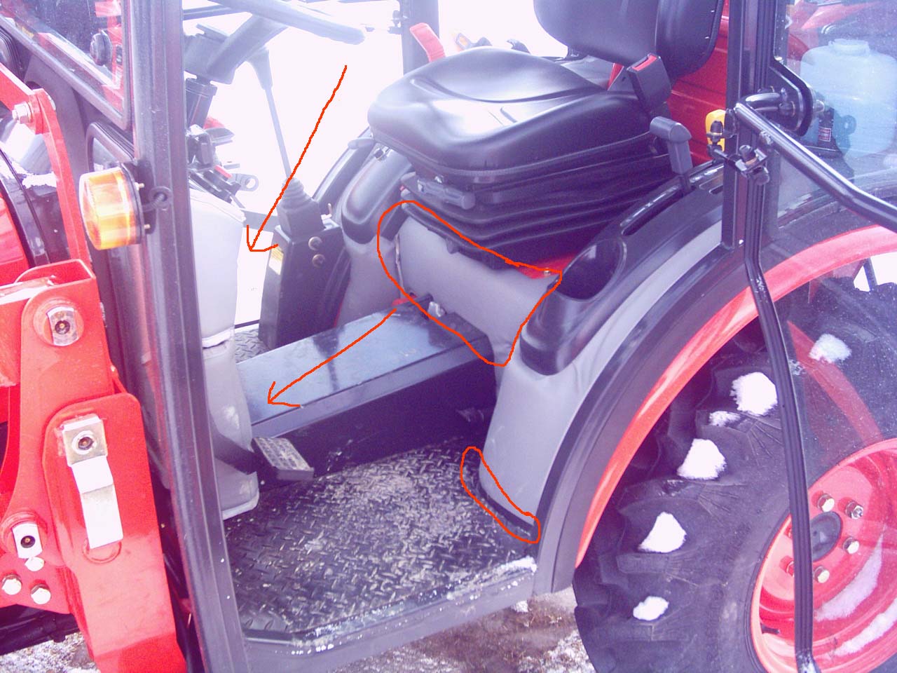

1) The floor is VERY sloppy, it doesn't seem to fit, seems to have been installed in the wrong order (I would guess it should have been the first thing installed, not the last), and will allow water to penetrate and rust out the floor. See pic 2 & 3.
2) The insulating matting is missing around the centre console. It is clearly visible in the picture from KiotiKarl, pic 4, but it is missing and I can stick my hand through the floor, pic 5. Kioti went to some trouble to make the material tight to all control levers, so I'm pretty sure they wouldn't have left gaping holes right beside the engine compartment. This material is to reduce noise after all.
3) The material under the seat doesn't fit properly, pic 6.

That truly sucks that you are having issues with the cab. Looking at the photo's I beleive that the fit/ finish deficiancies are instalation related. I have seen two other cab installs and both were much cleaner , with smoother fabric and tighter clearances between seams.
Both of the dealers that gave me quotes to install the cab on my tractor took great pains to tell me it was a tricky job and neither seemed very excited about doing the installation . One of the technicions that I sppke to specifically said that aligning the sound deadoning material was a colosal pain in the a&$.
All that being said I can't beleave that the manager or owner of your dealership was willing to allow your tractor to leave the lot with your brand new $7000.00 cab looking like that ,that is simply unacceptable. I certainly hope that they will be able to deal with the instalation related problems and make it right..............Craig

That's not right that you spent that much money for that kind of quality. The factory cab should fit much better than that.
   / New comfort cab for CK30 - REVIEW #5
My comment is that a rear view mirror is useless in a tractor cab. You'll be looking at yourself most of the time. My old 1086 Massy had one but no side mirrors.
The install, from what I see is very amateurish, like the bunched up mat under the seat. For 6900 CDN, I'd demand more, lots more.

Craig, was either of those installs on a CK27-35? The picture from KiotiKarl of a CK20 install clearly shows the fabric wrapped around the centre console, and I'm betting my dealer just didn't install it. Not having had the opportunity to see one installed on a CK30, I'm just basing this on the CK20 cab pic.
