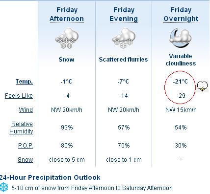

:licking: Can't wait to get out in this beautiful weather with my new cab tonight for a little plowing :thumbsup:, well, if my tractor starts :laughing:

I'm sure it will start, I've had to use my CK20 in -15 F (-26 C) after a brutal storm and had no problems starting. Hope you have an anti-gelling additive in that fuel.
The trick my dealer showed me was to cycle the glow plugs ONCE, as soon as the light goes out, crank the engine. Then as soon as it catches, turn the key to the glow plug position again for 5-10 seconds until the idle smooths out. Cycling the glow plugs more than once before starting just drains the battery.

Sorry, bad joke aimed more at the fact that something always goes wrong when I turn the key. But hey, thanks, that's a great little trick and makes a lot of sense.
