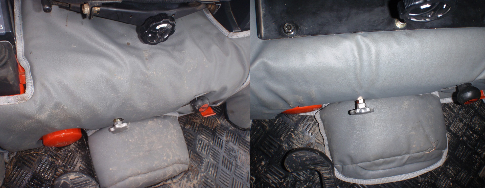

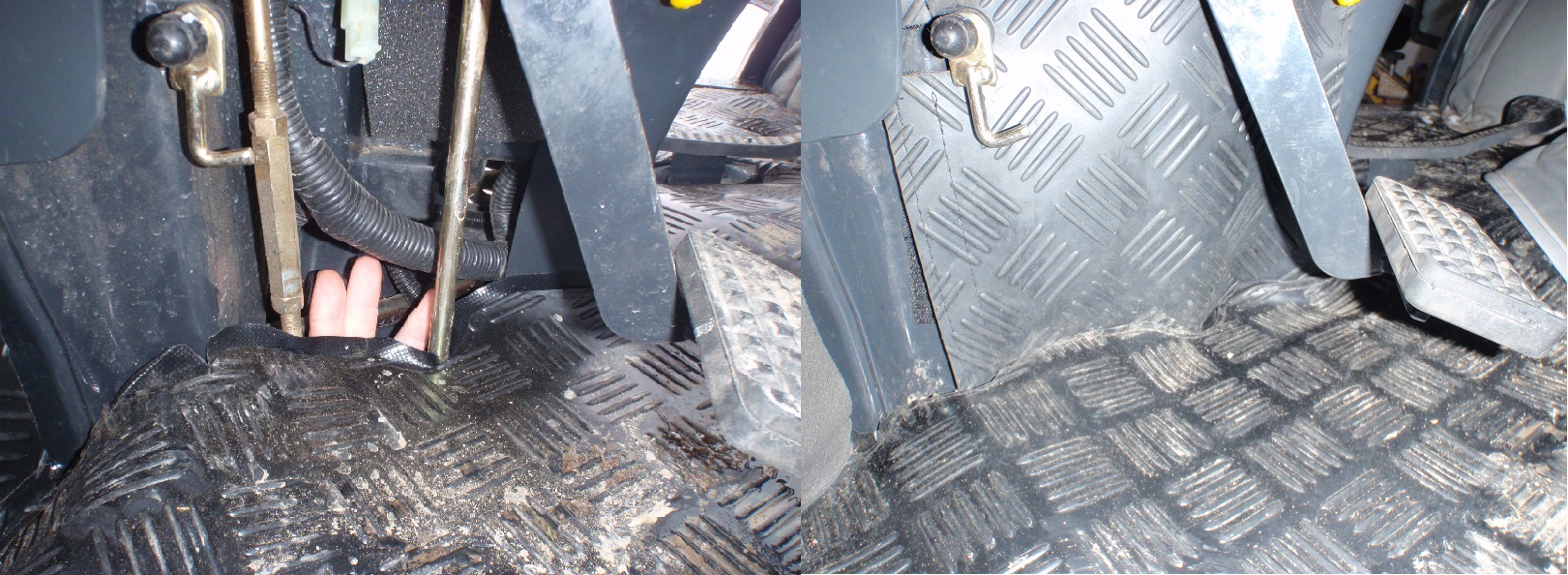

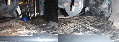

So... let's call this review #2. My dealer was out on Friday to take a second look at the cab. Again, regardless of some may think, I still think I have one of the best dealers around.
I was given a serious boost by a TBNer who provided a series of pictures and instructions to properly install this cab. They were invaluable to me and to my dealer. I emailed a couple of pictures to them before hand, and then gave them my tablet with the rest when they arrived. They spend 4 hours in my garage re-working the cab and using those pictures as a reference. The end result is one heck of a nice cab!
IMHO, the test of a good dealer is actually how they deal with you when there's a problem, regardless of how the problem came to be.
OK, my actual review is this is a top notch after market cab, much nicer than the JDP cab that was on my previous tractor. The significant amount of sound proofing material makes this cab very quiet in comparison and makes it worthwhile buying a radio for it (I had one before but would have to turn it up so loud that it would give me a headache). Even with the features that are supposed to be included and were missing, this cab still has a lot more in it than most aftermarket versions that cost more and has a much more polished finish. I do think Kioti could have manufactured plastic or rubber or some composite panels that are rigid and just snap together instead of the material that they used. This would make the difference between a factory cab that much smaller and would make the dealers job much easier. The front floodlights sacrifice brightness for sleek design, but are still useful and the front windshield wiper with wiper fluid works well and is a nice touch. There is no rear wiper, but my dealer simply removed one of the bolts for the rear hinge and used the hole for a wiper. There's no washer fluid on the back, but that's not needed. The front windshield opens a nice amount to allow some air in and the back opens completely. I would have liked and will probably rig up a way to only open the rear a crack or 1/4 of the way, but now it's either fully closed or wide open. The cab is very securely fastened to the tractor with brackets into the frame front and back. My JDP cab simply sat on the floor in the front and broke all 4 floor supports by the time I got it and was only holding by the sheet metal. There is NO movement at all in this cab over bumps and no squeaking or shaking either.
Now, I'm still waiting to find out how Kioti will deal with the missing features. They've already told me they will be removing the brochure from the website and changing their website with regards to the cab. I will post the current English and French brochures when they do. There doesn't seem to be any way to make good on some of the missing features, so I have a few suggestions that should be reasonable and fair, I'll continue to post my progress with that process.
Now some before and after pics...

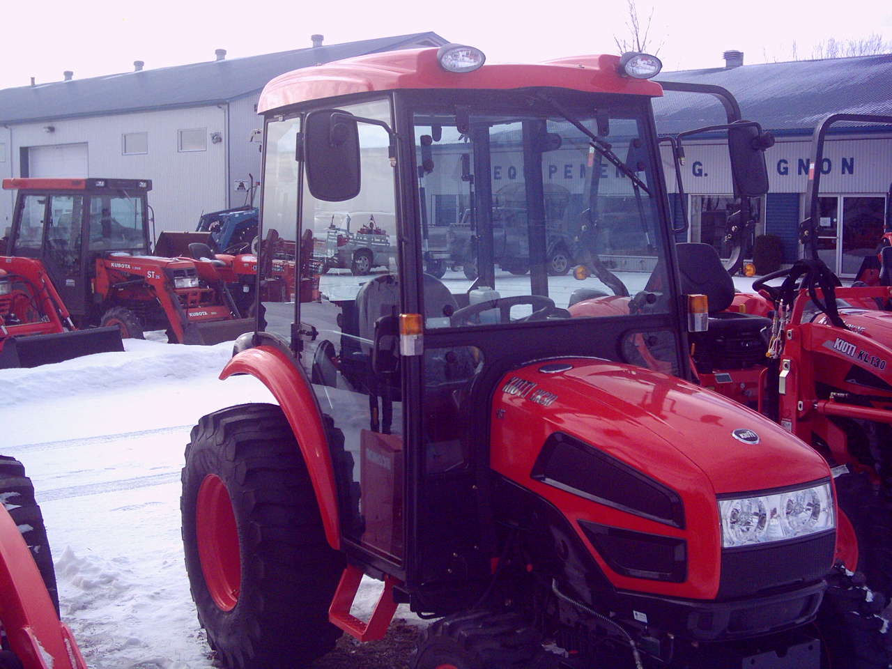

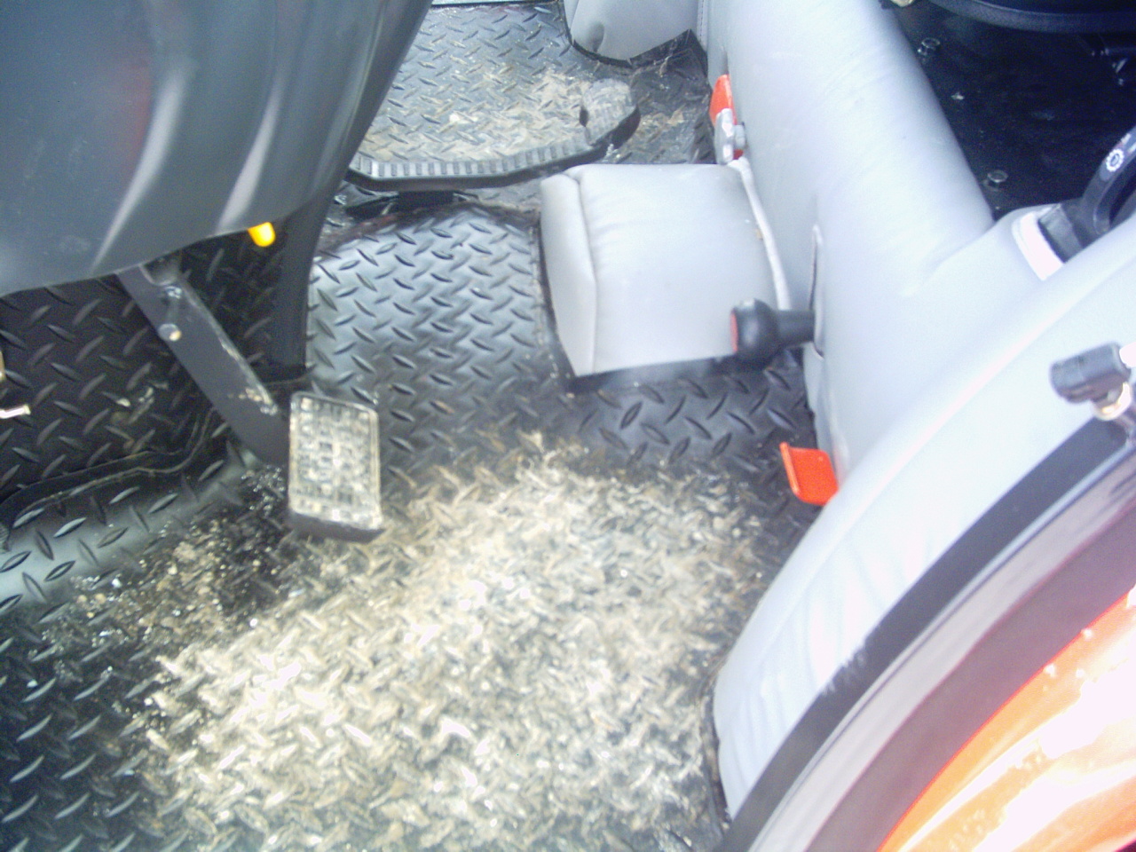

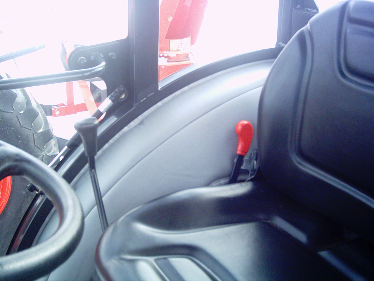

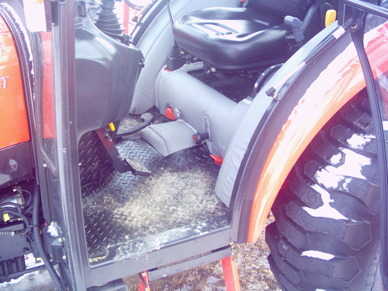

Glad to see most of your problems with the cab are resolved, looks like your tractor is a nightmare story:( I had similar experience with my TC45 supersuite cab tractor. Here are a few pics of CK30 with the kioti cab i took at the dealer, sametime i took thoses of the CK20. My dealer told me that installation was alot of work. With all your troubles and the dealer always there to do his best, i believe you've got a good dealer. :thumbsup:
Karl, thanks for the pics. Your picture of the CK20 played an important role getting everything figured out. Your pictures of the CK30 cab show how poor the installation instructions must be from Kioti. Your pictures show the floor going in last and curled up at the front and at the back to avoid the ripples that mine started off with. This is different from pictures of other installs I've now seen and how my floor is now done (the floor now goes under the material coming off the fenders and the centre piece on the tunnel sits on top). I'm not sure how Kioti intended it to be done, but I'm now happy with my install.
When my dealer came back for a second look, they brought a second cab kit with them to use for parts if needed. The parts that they took out of that kit weren't even the same as the ones in my cab. Those type of things can't make installing them any easier.
There is still the issue with the missing features, I've set Kioti a proposal, more to come...
