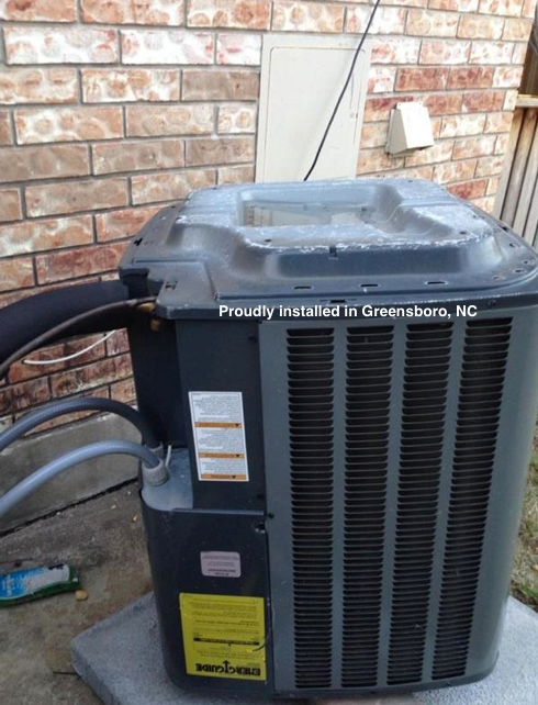

I travel to Texas this weekend to pick up my new system. Depending on weather, Hopefully I can get installed in the next few of weeks.
If all works out as planned, I should save some on my heat /cooling cost.
