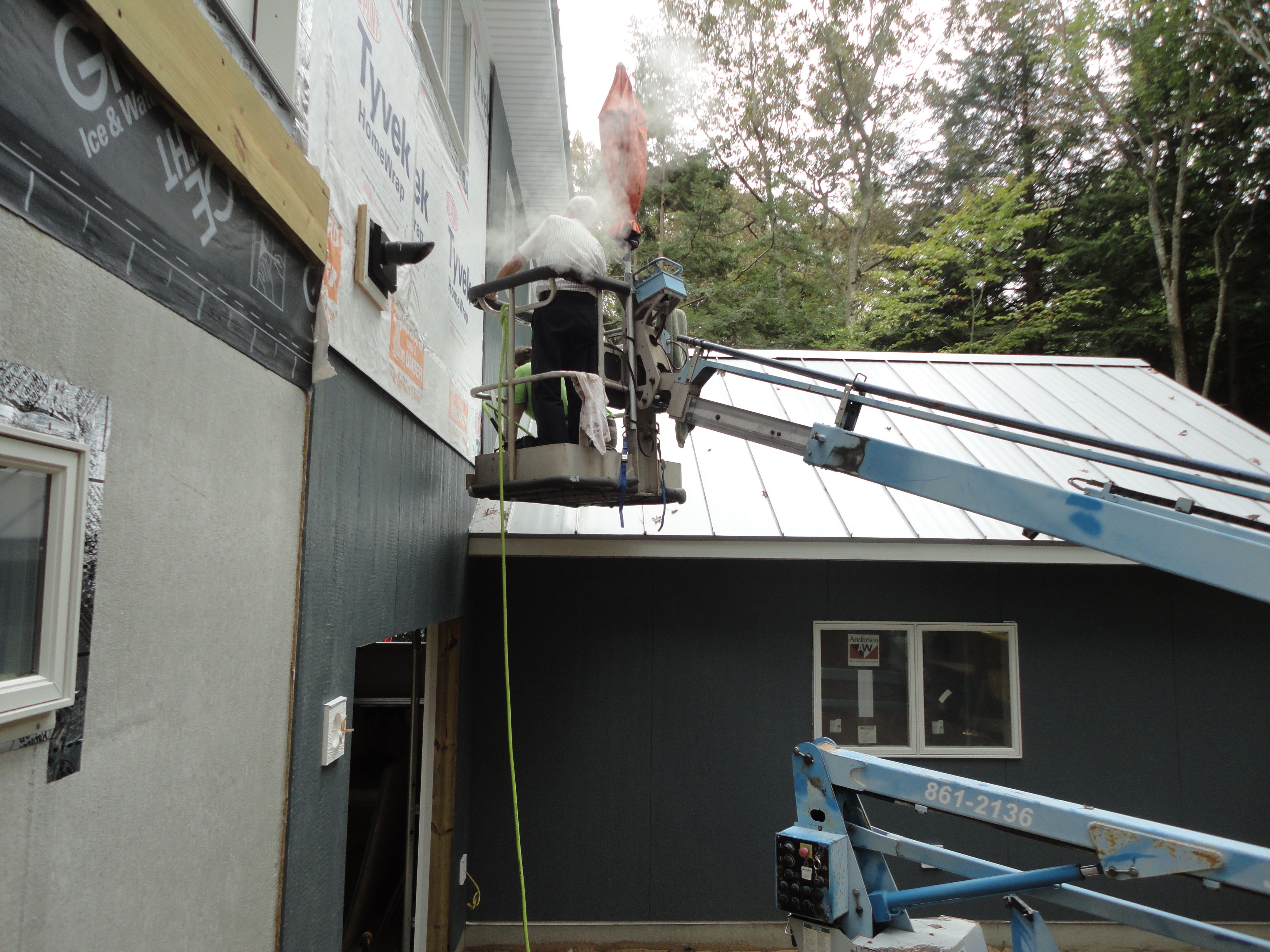

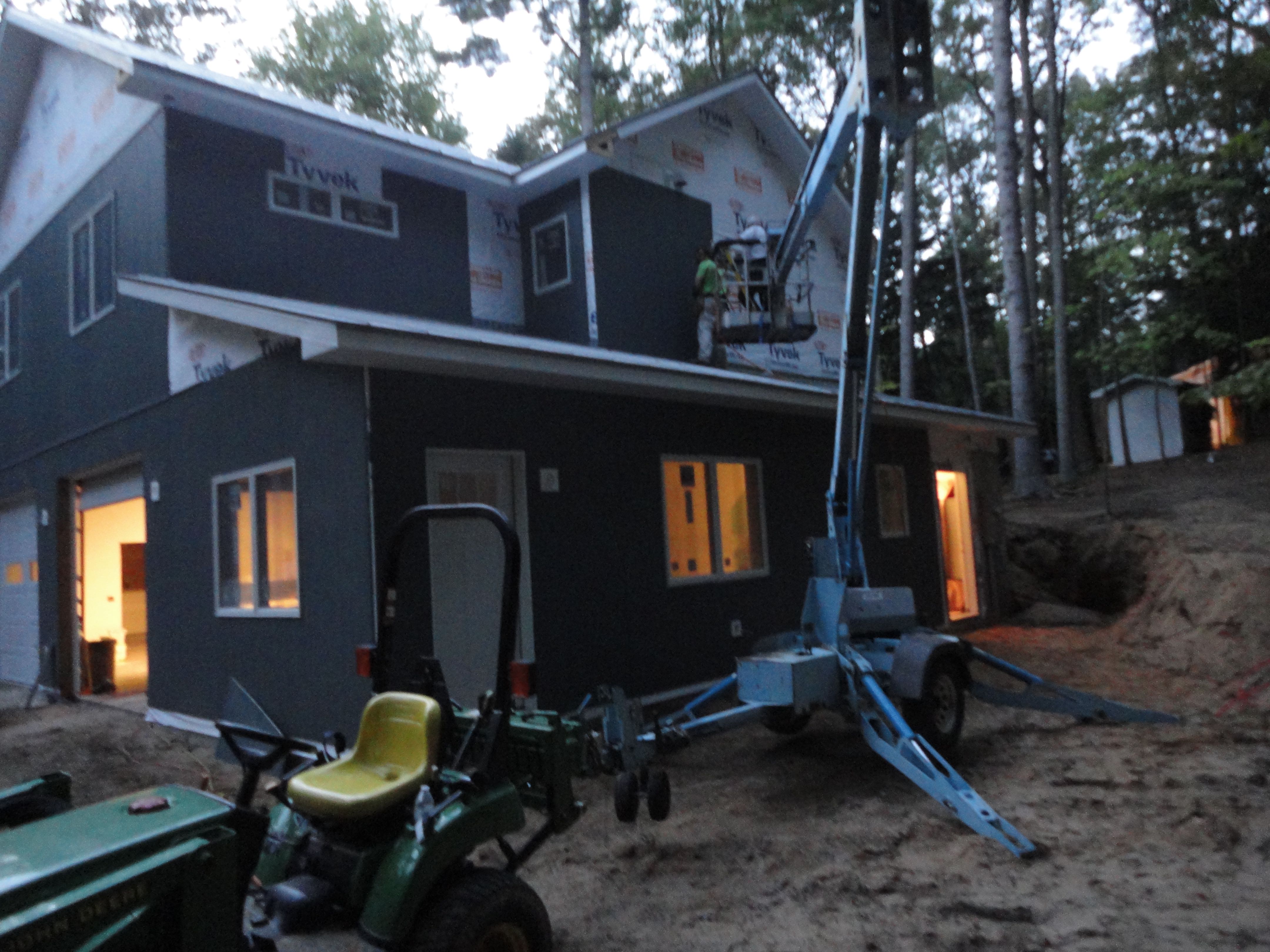

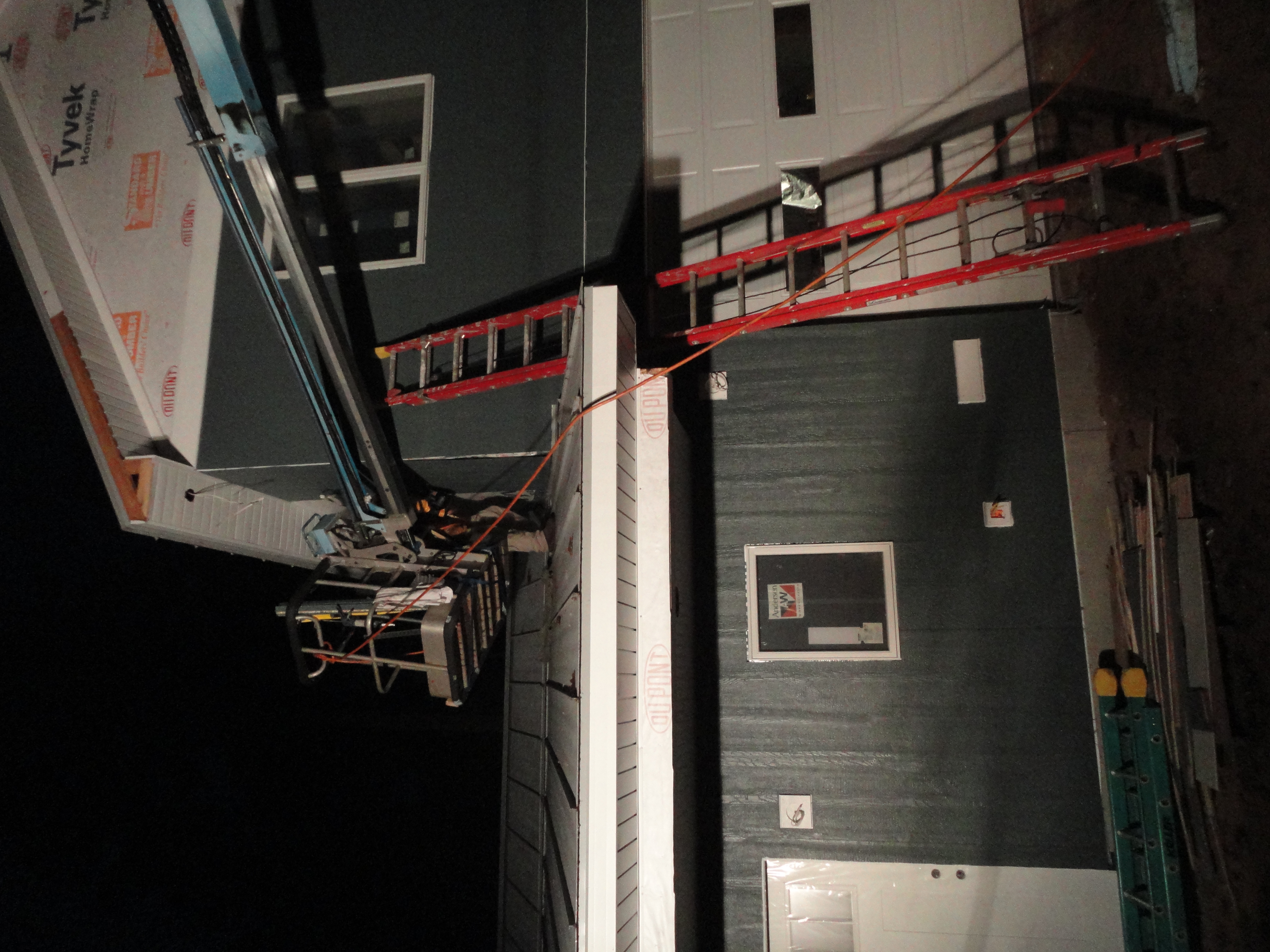

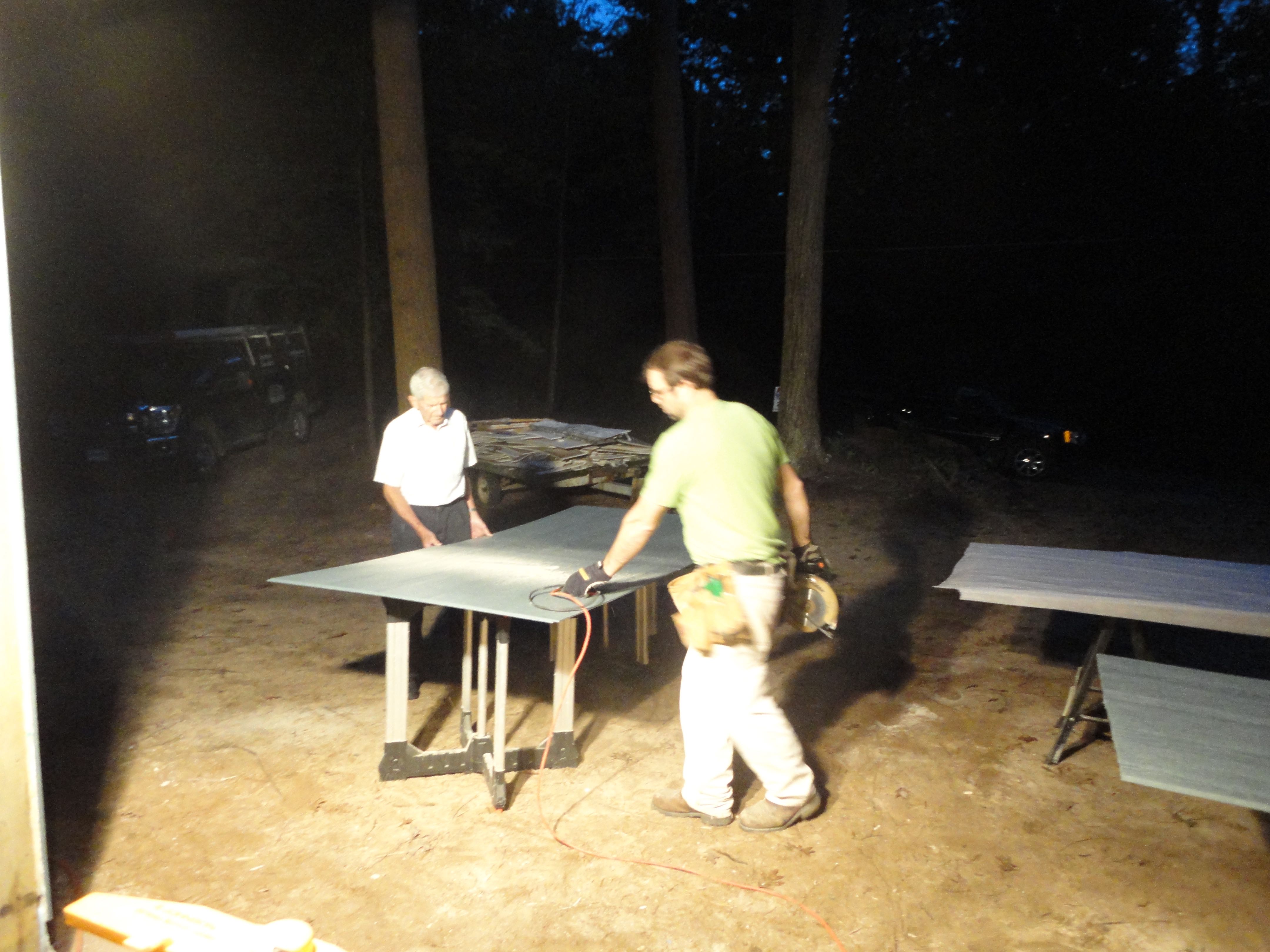

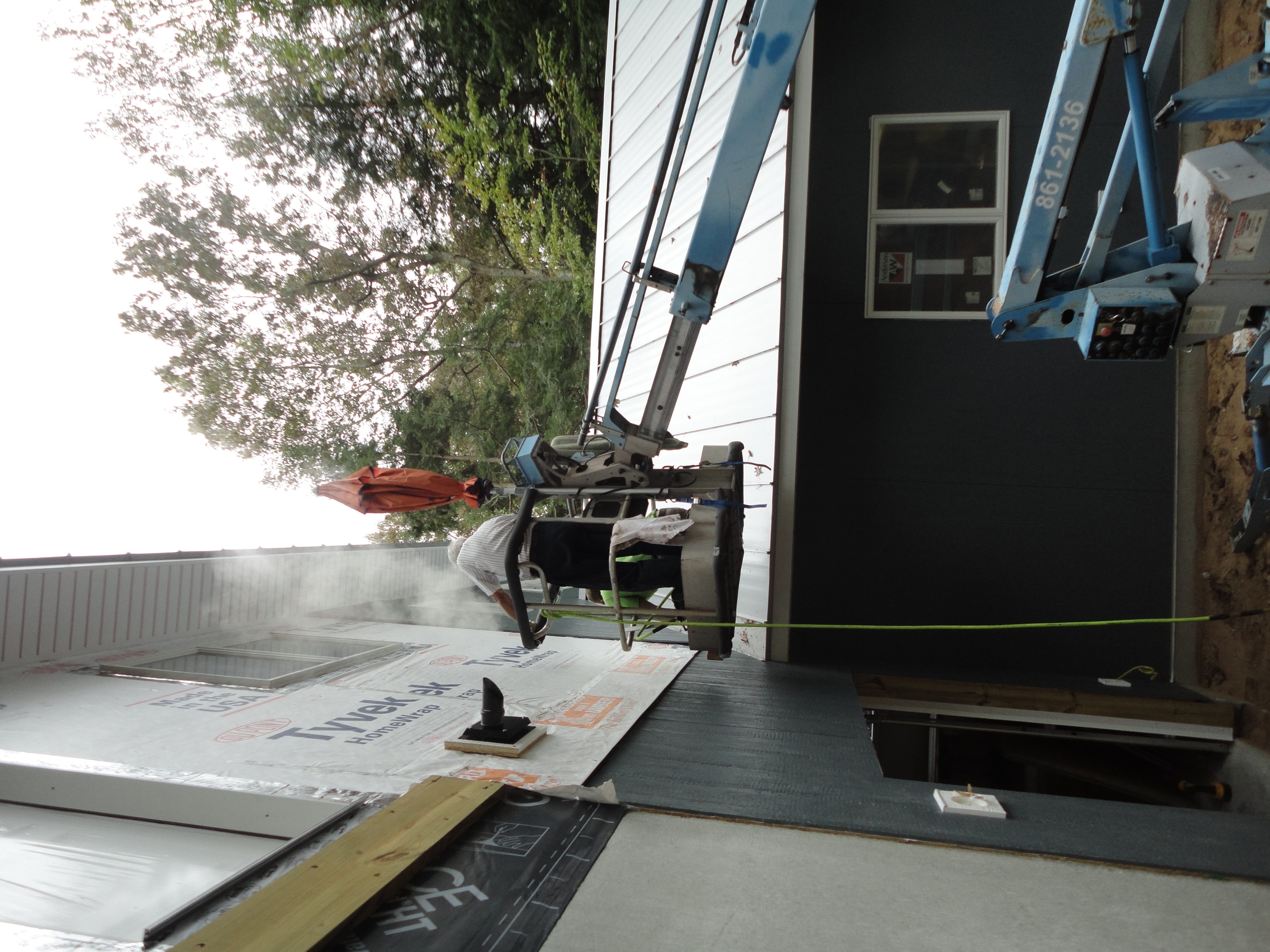

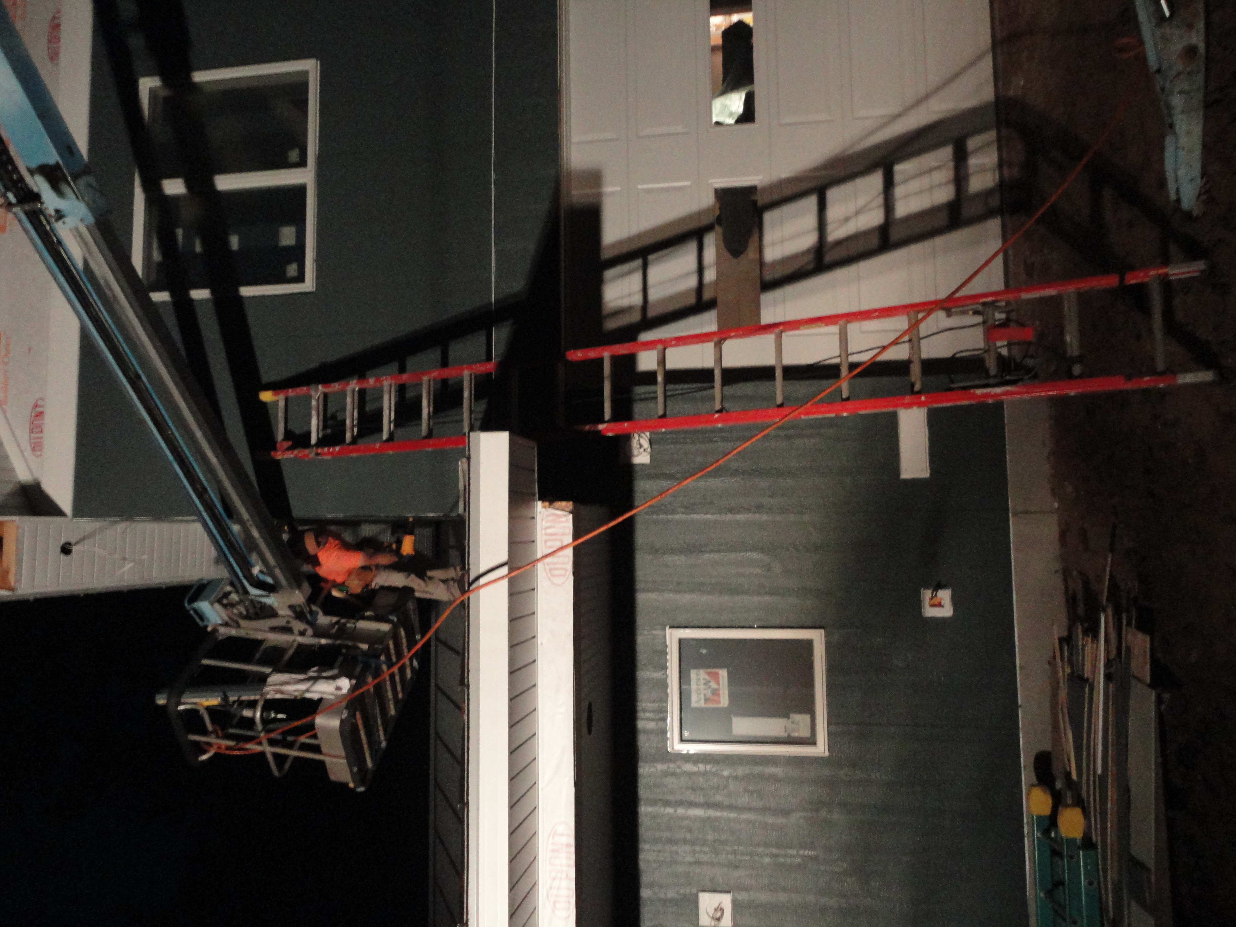

Second shift crew putting siding up. My 82 year old neighbor helping me with the siding, up in the lift, down on the ground, he has no fear and can often run circles around me.
Starting to get darker earlier here so lights are a necessity.
You can also see the Mechanical contractor's truck in the yard working late. Great team of people and really went the extra mile.

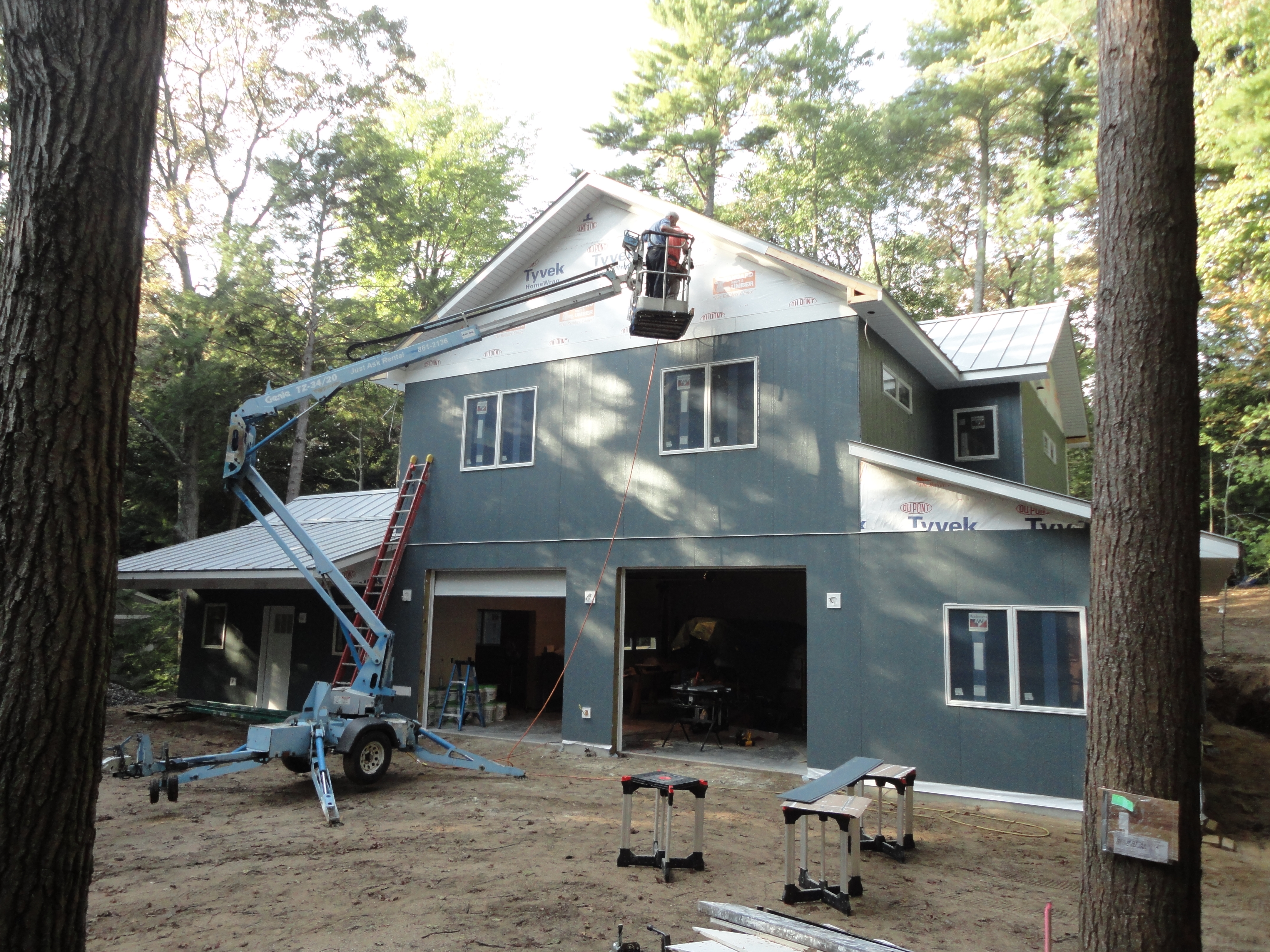

Installing the trim boards for the gable end and shakes.

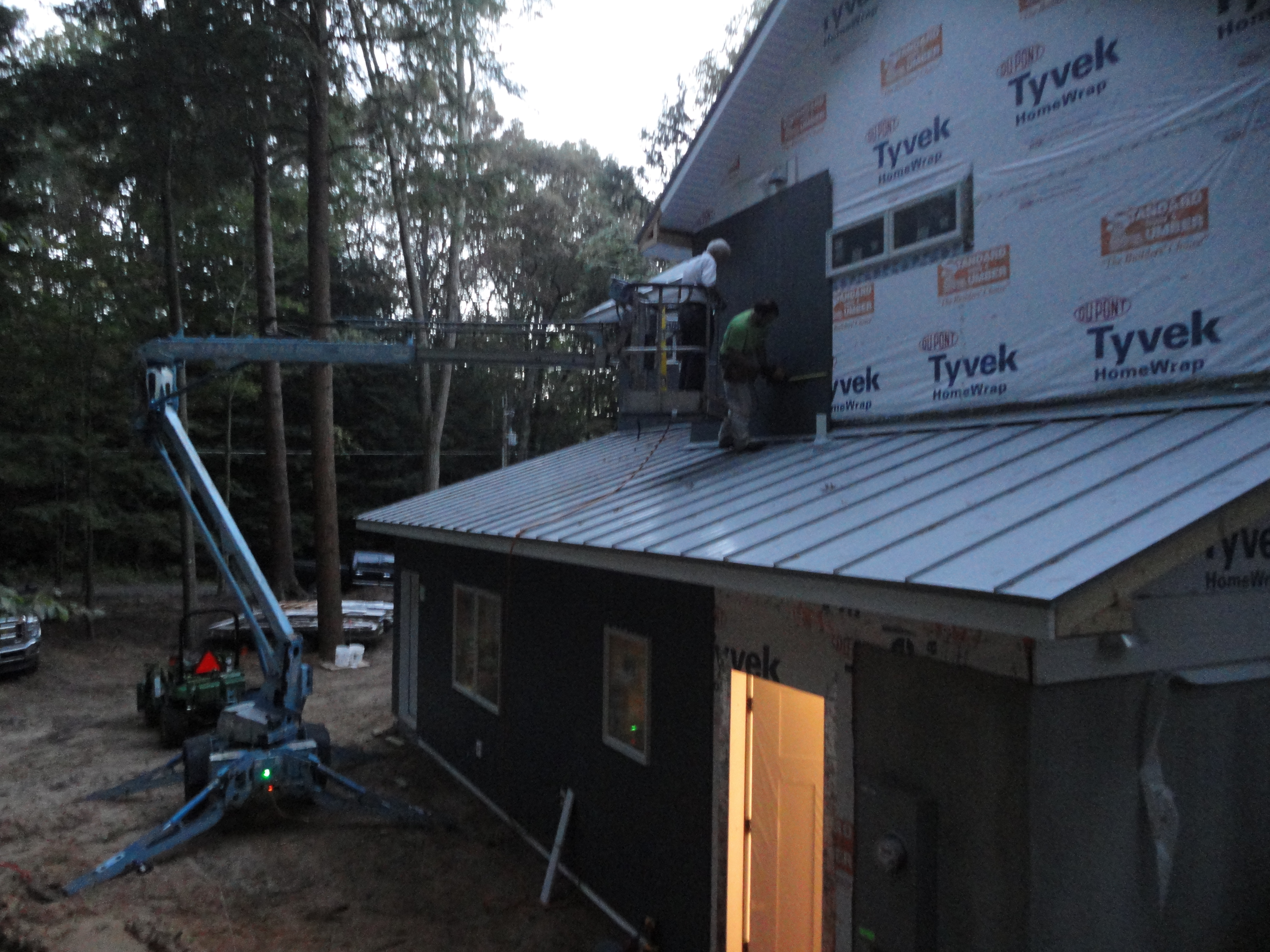

Installing siding on the west side
Starting the shakes on the South gable end.

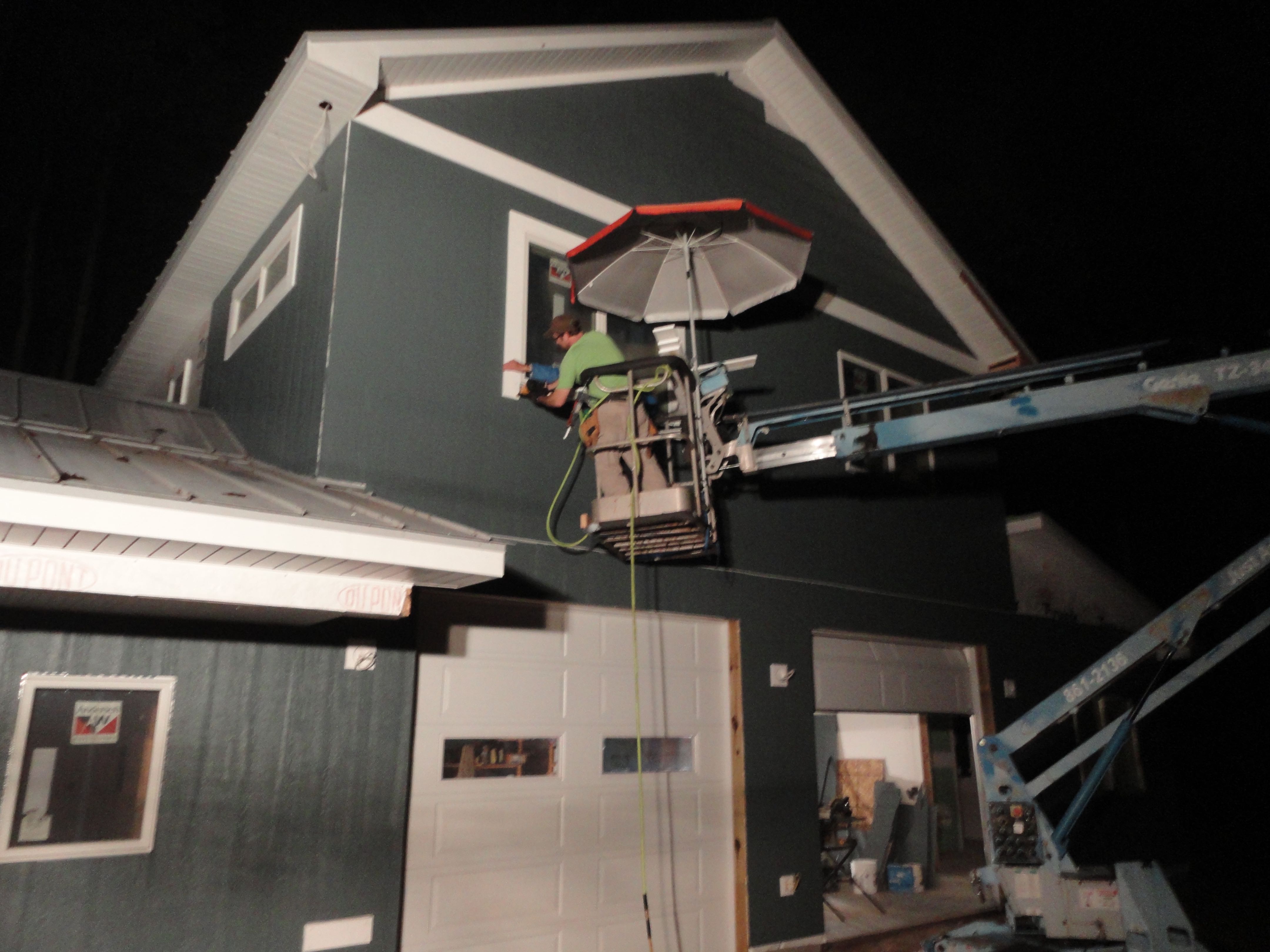

Second shift... neighbor back to help me put trim around windows.

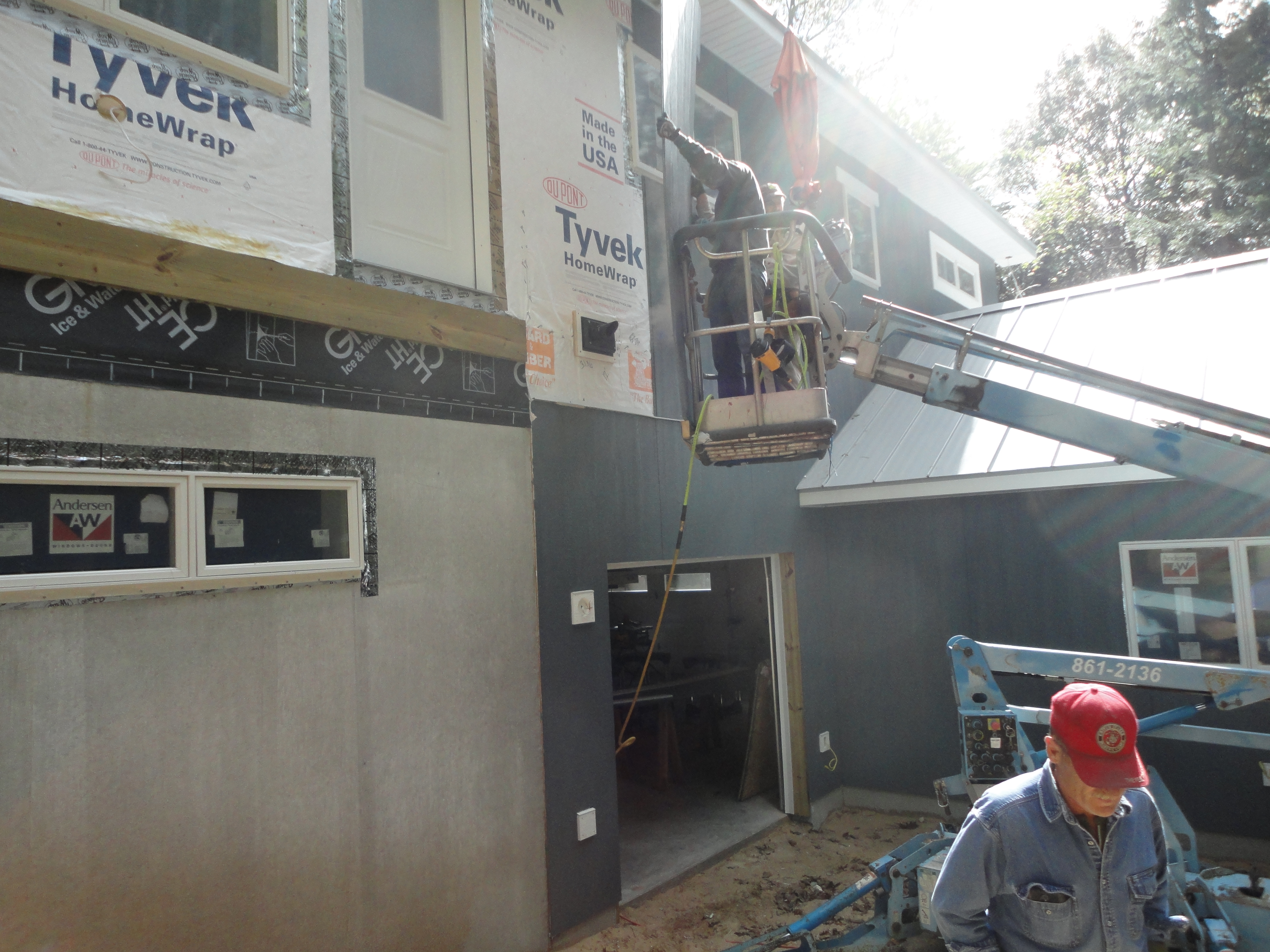

October 7, 2016
My helper is back to put siding on the West side.
Can see that the boiler is fired from the exhaust.

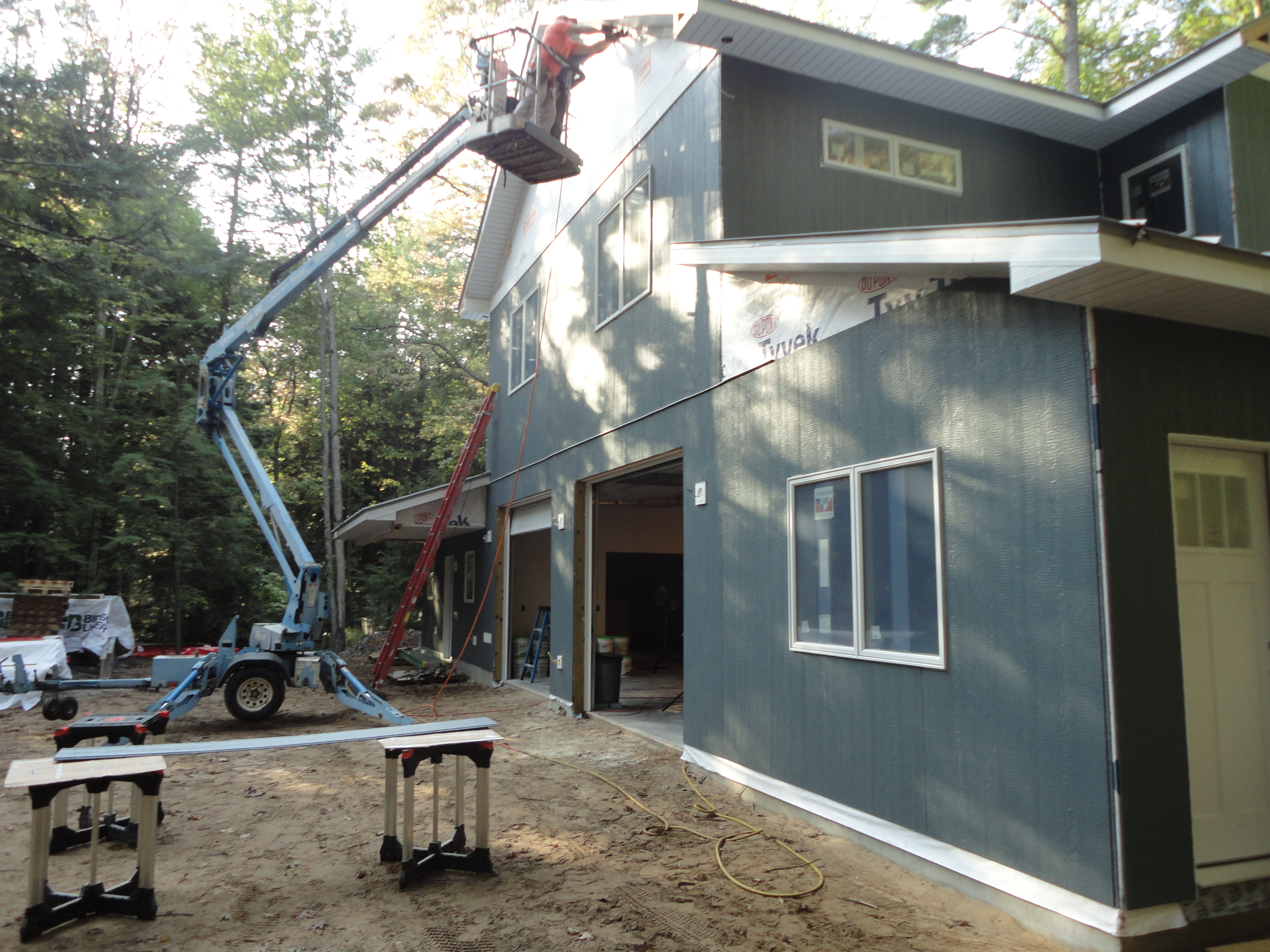

October 8, 2016
When I approached my friend and Architect that we wanted to build a new workshop/house he thought it was great. Then he figured out that we meant WE would build it and he thought we were nuts. He took our drawings and made them into a set of plans we could get permits, estimates and build from. Today, he decided to come up and lend a hand. Really appreciate his touches that I would not have thought of and was glad he could be here to see it come to life.
Continuing siding and trim on the West side.
