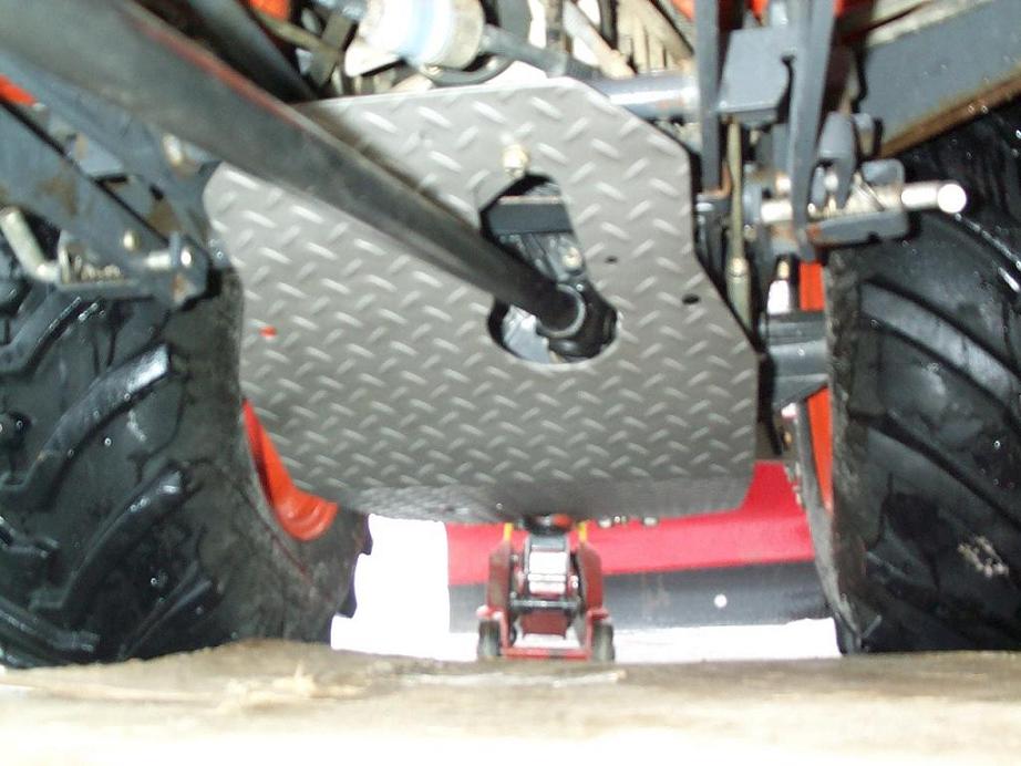

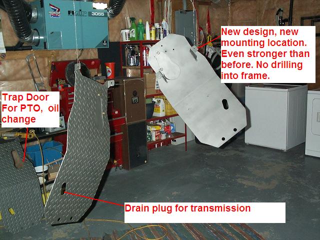

Hi all & Happy new year.
I've been busy over the holidays & made a few changes in the original skid plate.
The new design no longer requires drilling into the main frame.
If interested you can email me at Bro-Tek@hotmail.com
I can email you the installation instructions.
Richard

   / New design skid plate for BX #2
Oh sure, wait till after my wife orders one for Xmas then make it easier to install and stronger. /forums/images/graemlins/wink.gif.
Atcually, I cant tell exactly what kind of configuation Youve got there on the new design but as I was installing mine, I thought that a simple Ubolt up and over the frame rail that would sandwich it would work well and be a no drill install.

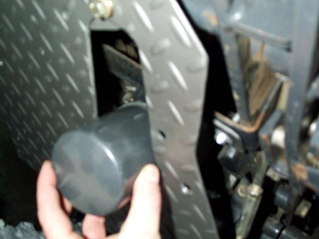

Here a photo of the new skid plate installed. You can see that there still is two holes to be drill, but not in the main frame, it's on that cross guard.
Richard

   / New design skid plate for BX #4
Those up-right tabs on the new design will work much better. That’s how we use to make belly pans for full size utility tractors.

Here a better view of the Bro-Tek skid plate on the tractor, this design is on Ebay right now.
Pic is showing..Shaft of Snown blower or MMM installed.
