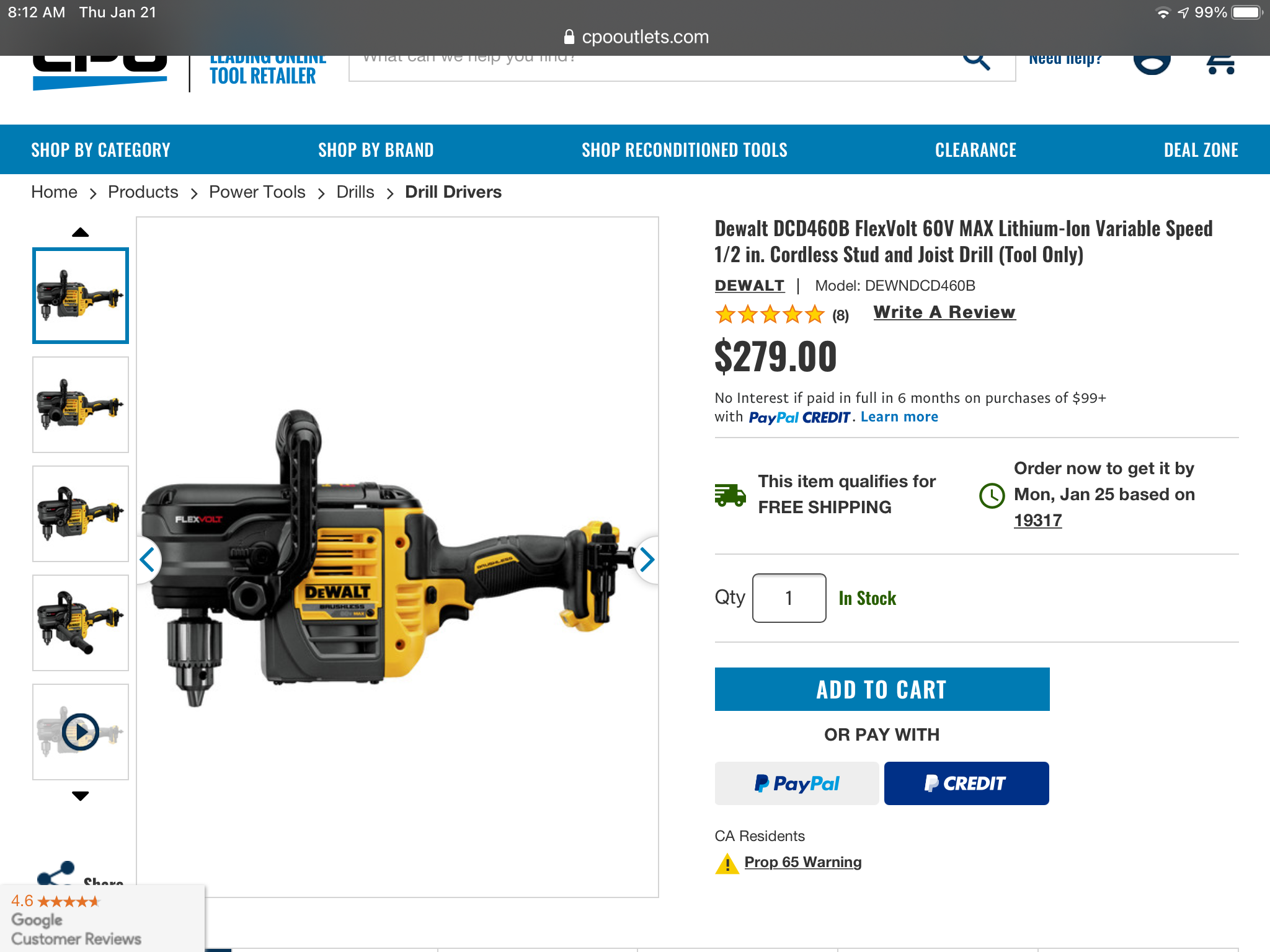

Agree with the above posts. I need to research what will fit in my trailer toolbox, too. Its a little smallish for a battery, pump, switch, hoses, et al.
On the slower setting I can jack trailer up no problem, even with 13 tons of hay on it. Just takes a while
Still think the budget way is a rechargeable 1/2 electricians hole hawg, socket fitting and an adapter. But then I dont understand what to do if the drill breaks or dies....how to adapt the handle to fit back on in an emergency?
