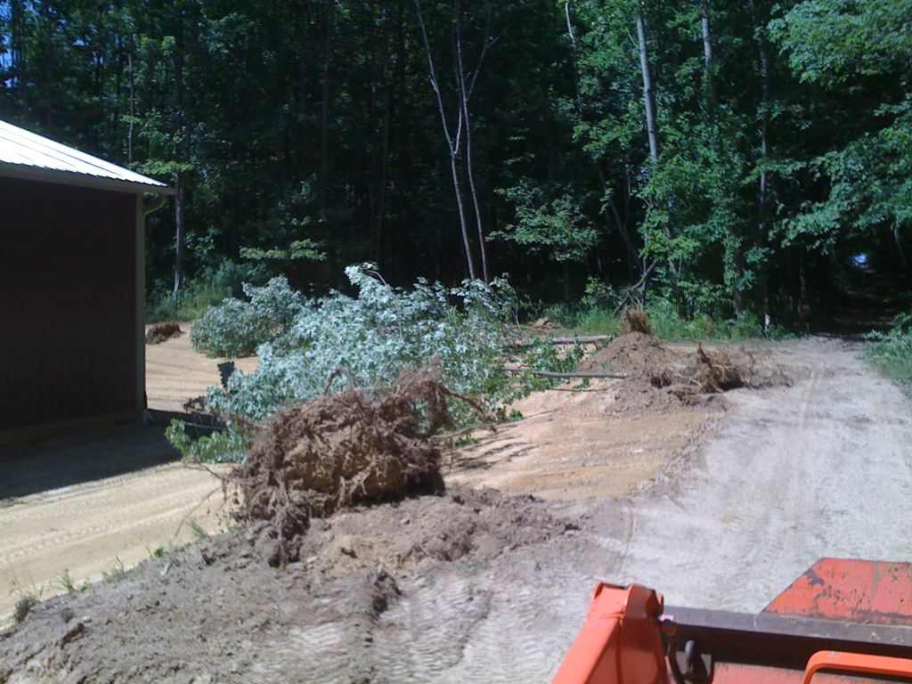

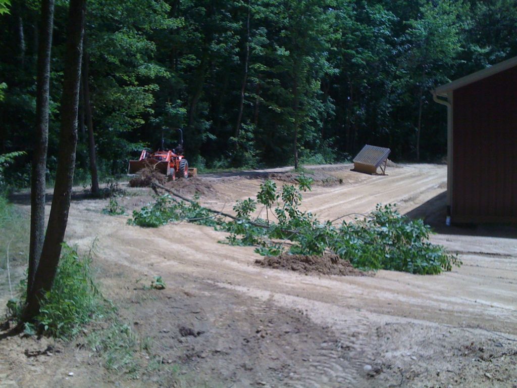

I've been doing some observing .... and contemplating things .... and have made some decisions/changes regarding how I want to finish off the exterior perimeter:
1. There were three smaller trees (5" to 8" diameter, 25' to 30' tall) on my property on the backside of the barn that I was originally trying to keep. Since the barn is in essentially in a wooded area and surrounded on all sides by trees (the morning and afternoon sure are nice), and since removing these three trees will allow me to extend the slope over a greater distance and reduce the acuteness of the incline (which ought to make it easier to get some grass growing on it and reduce washouts) I decided to remove them:
I also removed the ash tree with the two trunks in the center (background) of the last image .... and I'm not done yet ....
Have a couple of larger poplars I will remove for sure and maybe a few others as well .... easier to take them down now versus having to remove them from the barn after they have fallen.

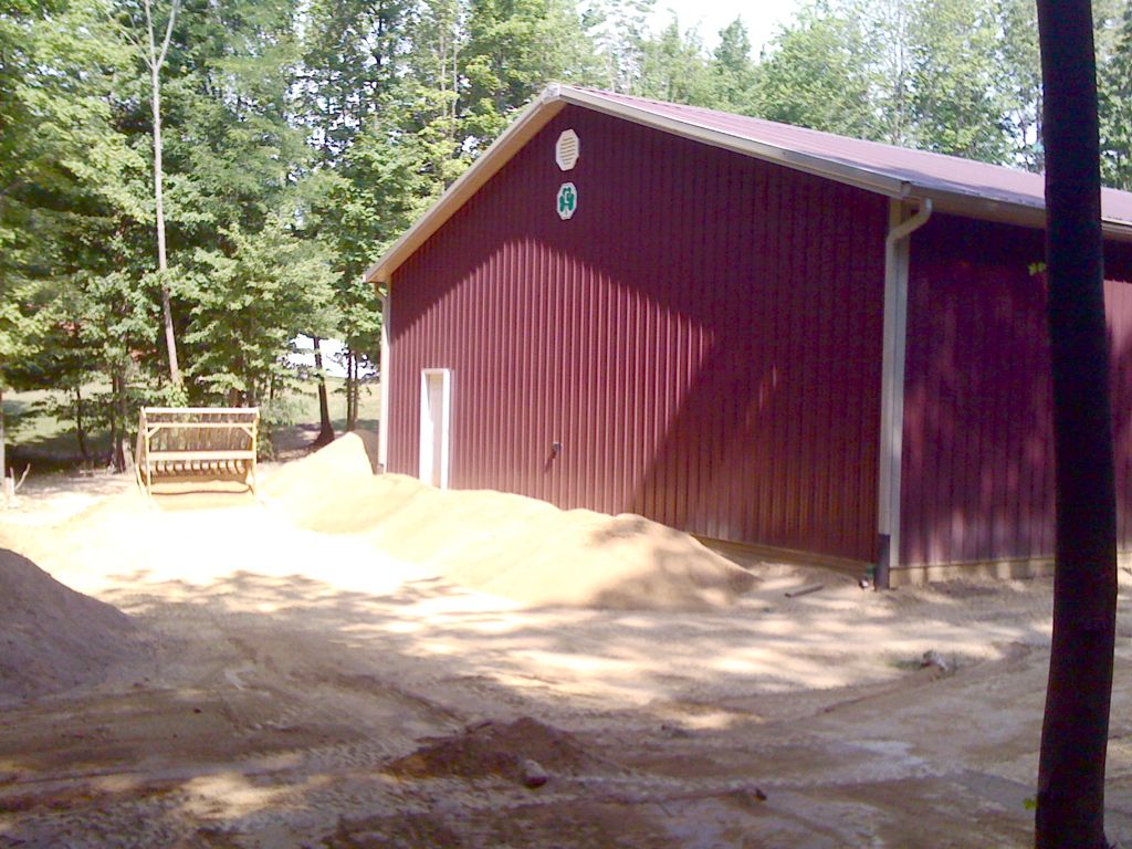

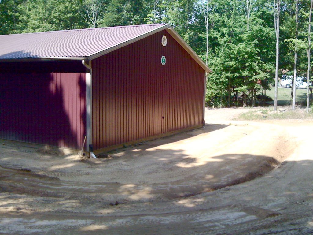

Here's a little update on the drainage issues:
For the most part it hasn't been too bad .... on the surface, the rear (east side) has pretty good flow from the north end to the south end (which is where I want the water to go)
There is one spot right at the northeast corner where there is a often a small, shallow puddle after it rains - this should be easy to handle with a little finish grading ....
There is a trail (visible in the third photo above - the tractor is parked on it) which is on the property line - the area to the right in the photo (which is my neighbors property) generally slopes slightly towards my property and the barn. The solution for this will be to grade the slope back to the trail, leaving it (the trail) about 6' wide (wide enough for my tractor and the neighbors Gator) and build up a berm on the trail, thereby sloping the trail back towards the neighbors property .... which will cause any surface runoff from his land to run down the trail past the barn area and into the woods below the barn ....

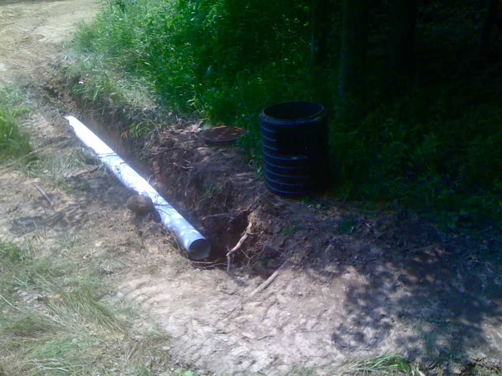

The north side of the barn (just visible on the right in the first photo above) is more problematic - it catches surface flow from perhaps as far as 200 or 300 yards away .... during a heavy rain the runoff coming down can be considerable. The change in elevation on the north side varies from 5'+ to probably 7'+ above grade at the polebarn .... this change (the slope) occurs over about a 30' to 35' area.
Heavy surface runoff + steeper slope = potential problem with washouts and getting grass to grow to hold the soil in place.
The solution I came up with was to try and eliminate the runoff before it got to the slope by installing a pair of catch basins, at two locations up at the edge of the woods, just at the top of the slope.
I cobbled the catch basins up by cutting a 5' long chunk of 12" smooth bore PVC culvert I had lying around in half. For the one I'm using a cast iron grate I had lying around that fits perfectly inside the culvert (held up by a couple of pieces of 1/2" rebar), the other one I had to spring for a plastic grate designed specifically for this purpose. Each basin is drained by a 6" pipe, which are joined downstream with a wye, with the 6" line eventually running into the concrete catch basin at the northwest corner of the barn:

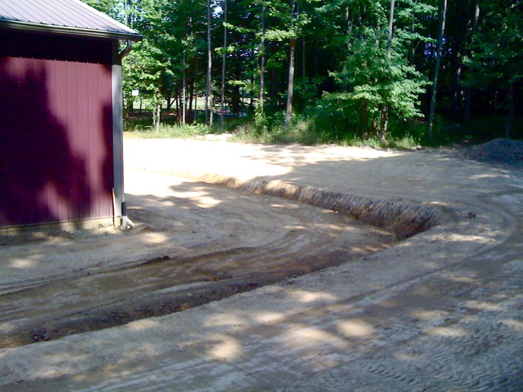

One upside to extending out the area for the slope on the backside of the barn, and doing the retaining wall is that it yielded a substantial amount of clay and some very beautiful sandy loam which I can use as fill inside the barn:
One of the other changes I decided on is about the slab around the outside. Some where along the line I had decided that I would put a 5' slab all the way around the outside perimeter, for outside storage and to keep water away from the building.
I'm still going to do 5' on the rear, but I've decided that it would be nice to make them a little larger on the north and south ends of the building.
I'm going to shoot for a 10' wide slab on north end, where I'm limited by the slope .... and 18' or better or the south end .... big enough to park a vehicle on and be able to get around it to work on it.
To that end I've been adding fill (about 1 1/2' on the southwest corner) and compacting it on the south side.
