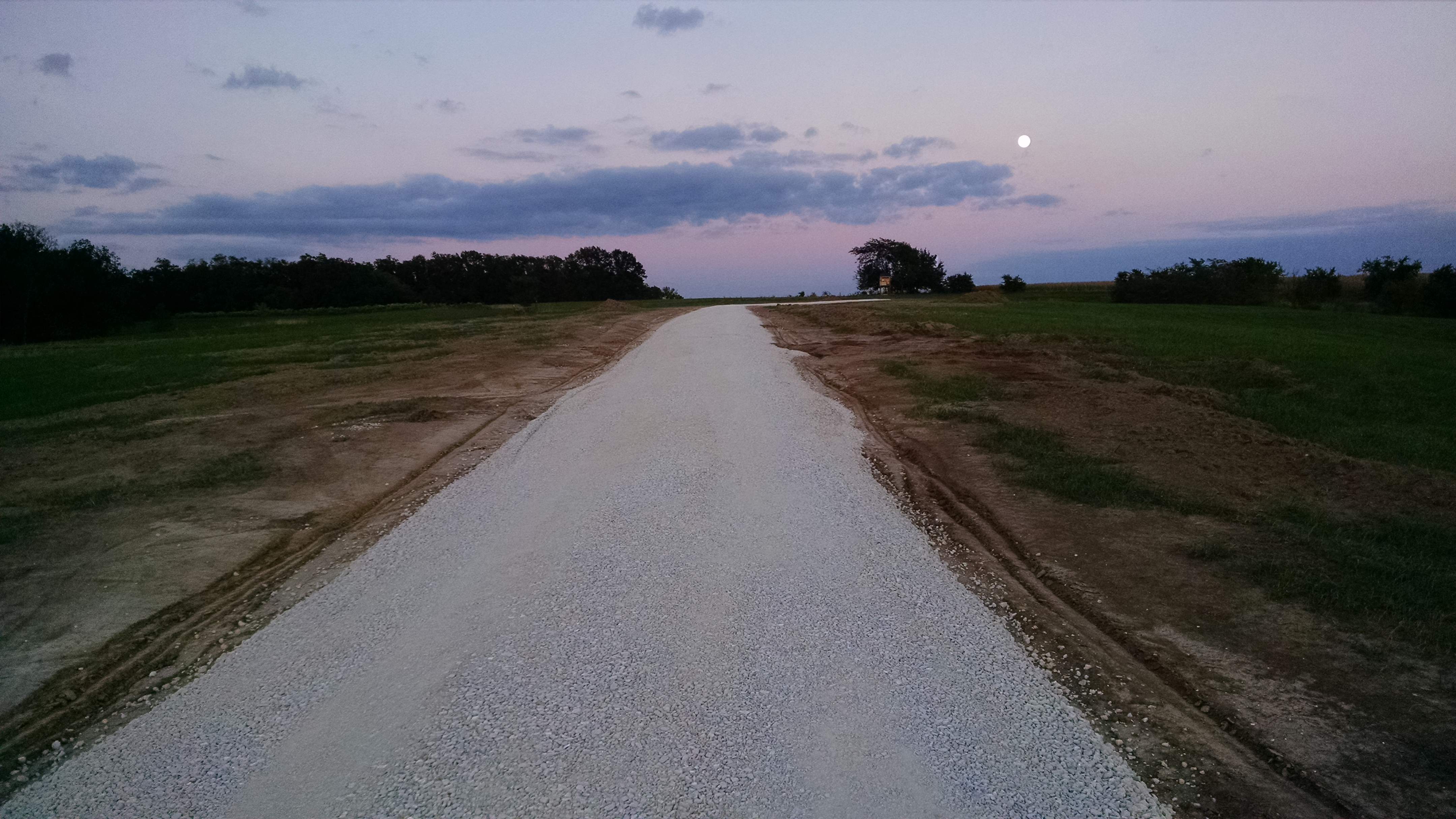

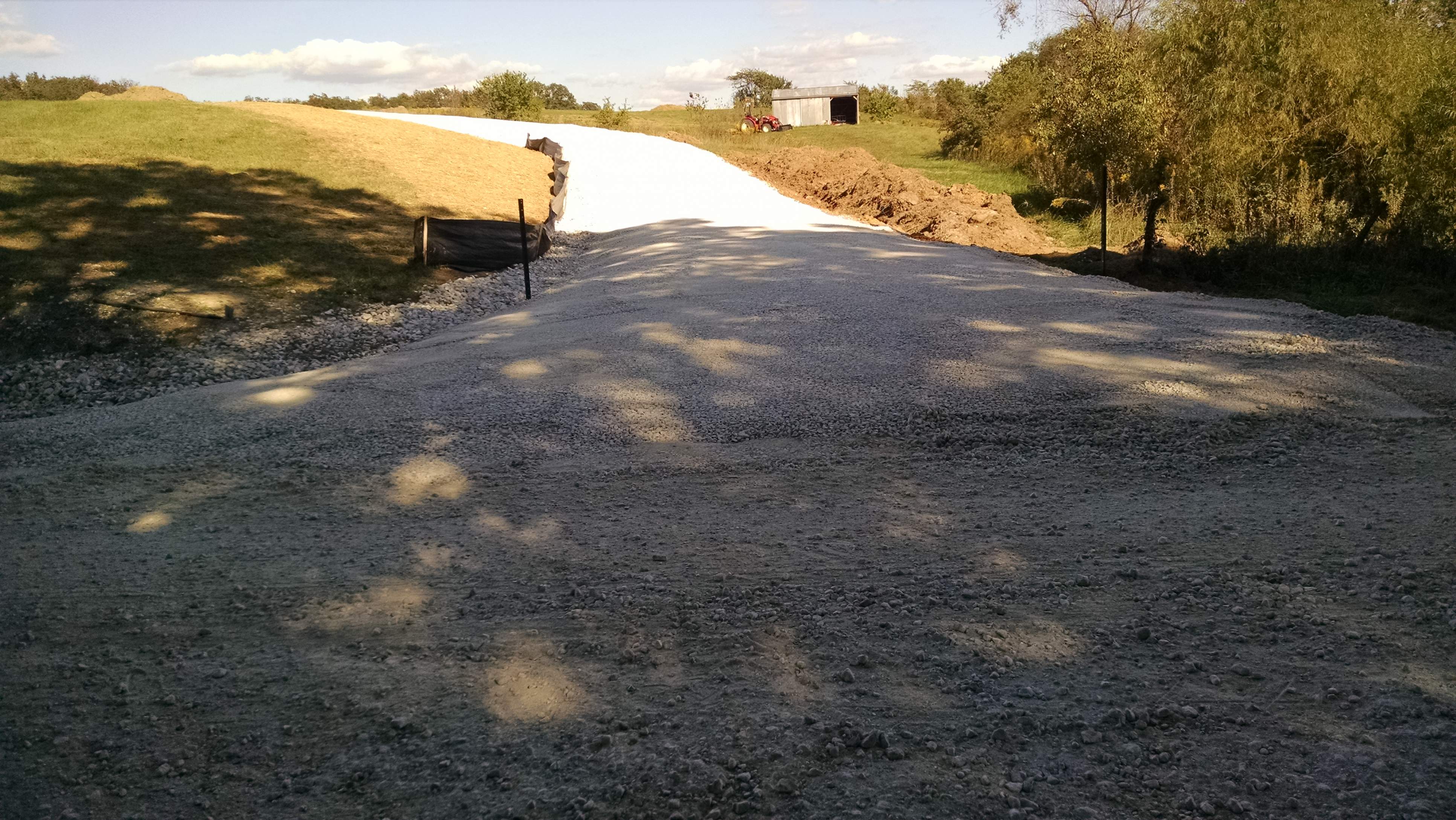

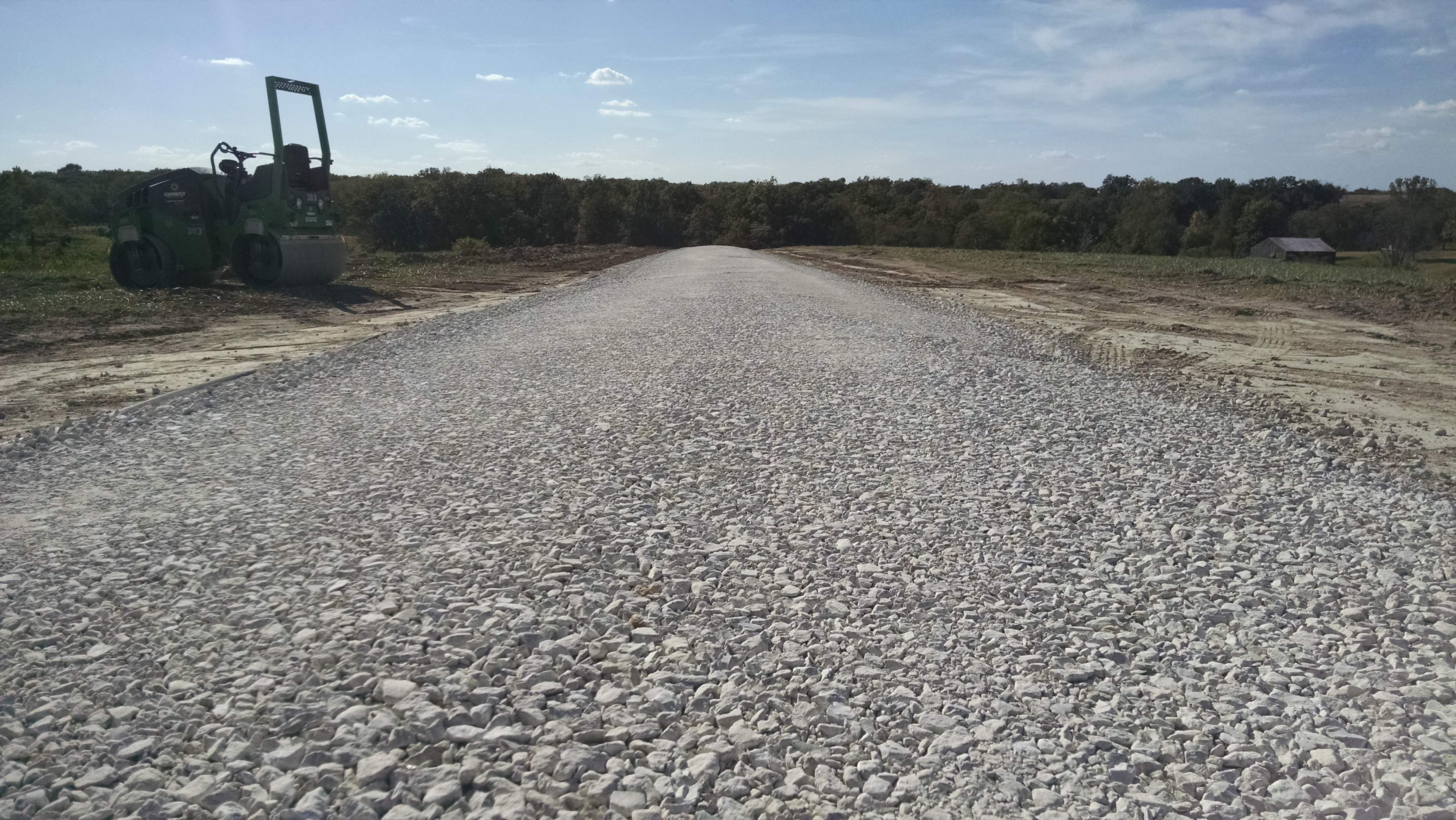

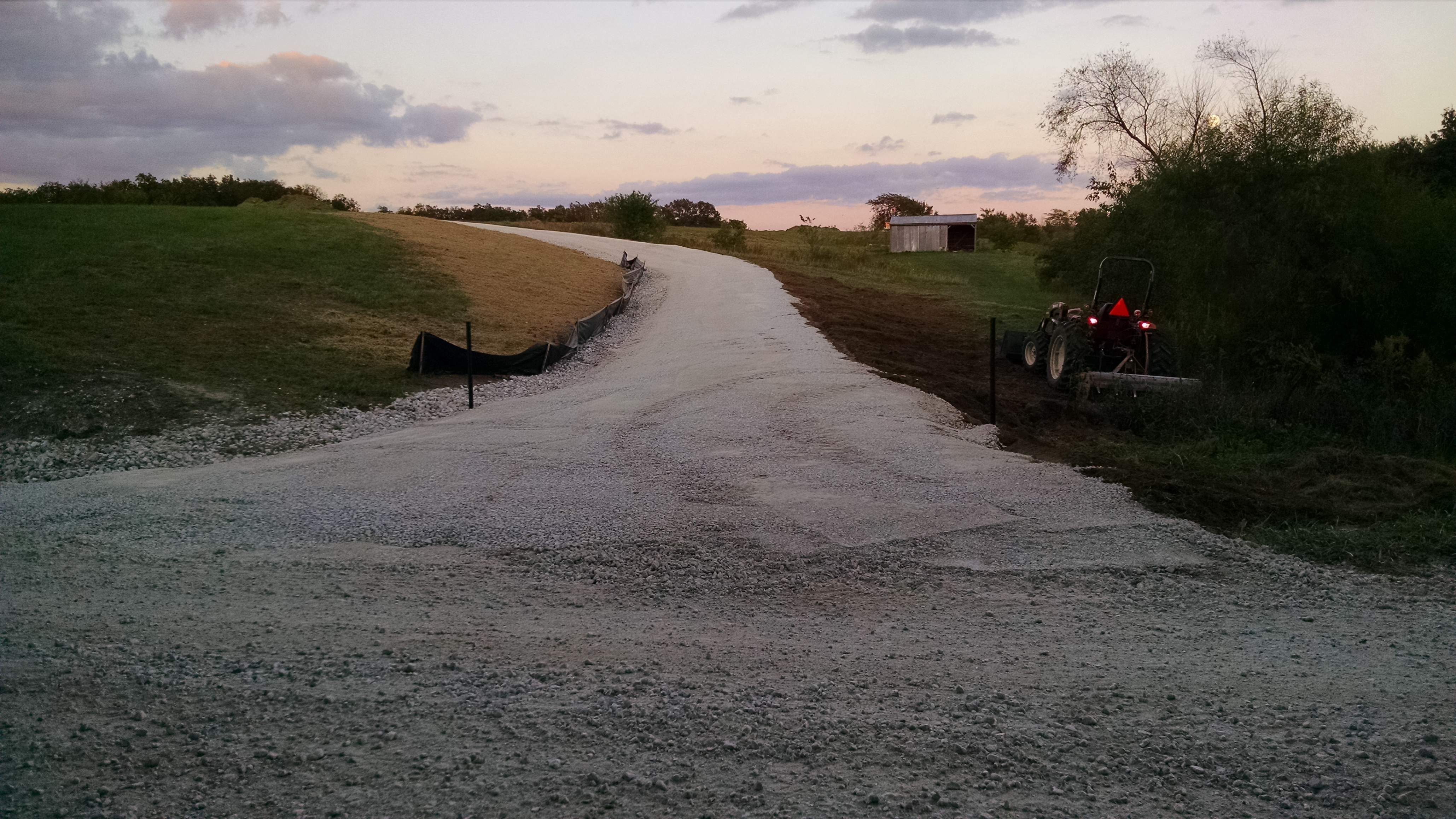

Graded and compacted the rock today. There were some areas that were 12+ inches thick and other areas were only 6" thick. Did my best to even it out, but it's not perfect. Probably going to order another couple loads of rock, but doubt I'll rent the compactor again just for a couple loads. Forgot to take "before" pics prior to the grading, but I can tell you that it looked pretty rough before I started. The compactor did a nice job, but we could really use some rain. It would've been nice to be compacting moist rock, but I guess you get more for your money when they haul dry rock instead of wet stuff. I probably shouldn't have crowned the road so much, but I wasn't sure how much the center would compact compared to the edges where the trucks had been driving. Ended the day by spreading some top soil on the downhill side of the entrance. Hope to get some seed down on Tuesday. Unfortunately there's still no rain in the forecast.

Looks really nice. I wouldn't worry about the crown. Only ways to have too much are if mama's car drags or if it causes you to slide in bad weather. IMO. If it causes you problems have some gravel "barrel track" spread. Basically its just spread in the tracks.
   / New Driveway Construction #76
Looks great. You want at least six inches of crown on an unpaved drive and a bit more in steep sections. Yours looks about right as you have it graded now.
I'd get a load of clean sand and chink the top to keep the stones from rolling up from tire action.
As soon as you get some rain the traffic will finish the compaction for you but you will need to touch it up after the house construction phase is over.
Are you going to line the drive with shade trees?
