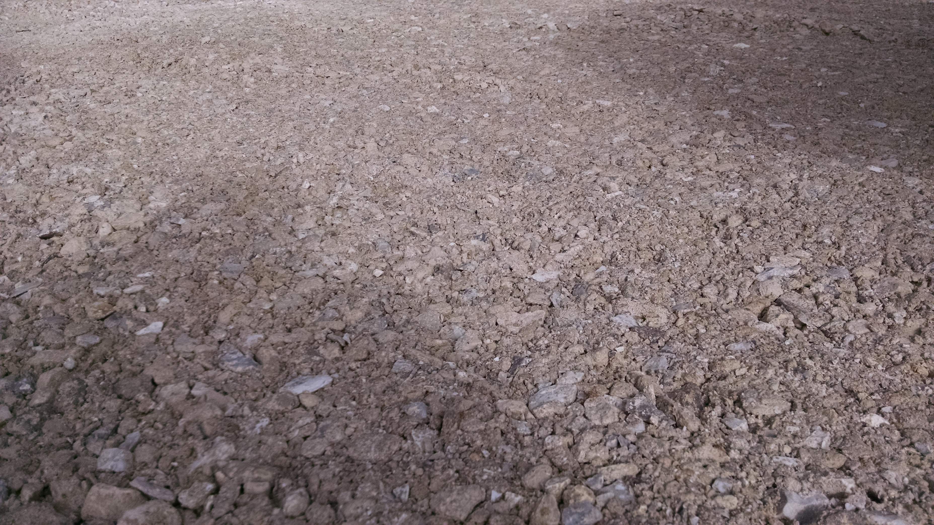

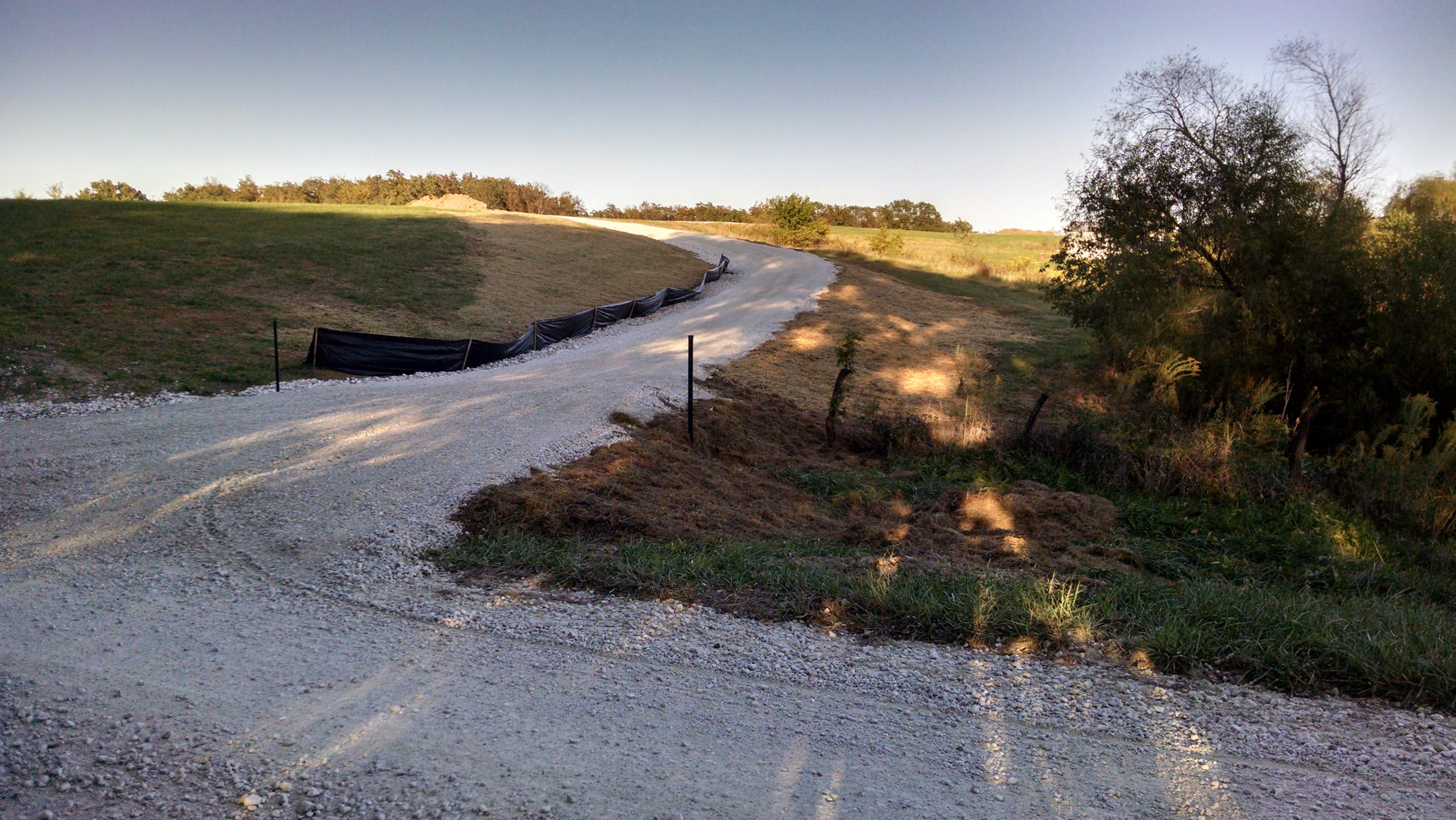

Got the seeding done today. Ran out of straw and couldn't find any on short notice, so I just used some old hay. I seeded everything, but only used the hay/straw on the ditches and the more erosion prone areas. Spreading the hay is very time consuming because it likes to clump. It was also windy today which made the process much more difficult. The last little bit of rain we got really firmed up the surface of the driveway. It's tough to break the surface with a shovel in most places. The first pic is one of the firm areas. There are a few spots where the fines weren't mixed in well and those areas are a little loose on top. I'll check with a concrete company on the "sand", thanks for the tip.

The cost for 900' of completed driveway (prices include shipping and tax):
360 tons CM6D - $5060
15 tons 3" clean - $220
3 rolls of 200lb geotextile (432 ft per roll) - $1070
Fuel (approximate) - $170
Seed & straw - $160
200' silt fence - $63
Staples - $30
10" culvert pipe - $102
2 days compactor rental - $442
Tractor repair - $1200
Total - $8517
I included the tractor repair, but I feel that it might have broke at some point anyway, just a matter of time. It took about 70 engine hours on the tractor and maybe another 20-30 hours of manual labor.
