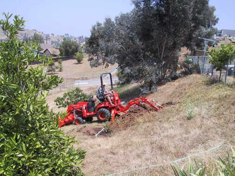

Just went on your site and do not see the 25SDA available for online purchase. Is it ready for sale yet? I think it is just what I need for peace of mind on my hilly 5 acres...(see photo)

Hi GaryG,
I think Muhammad will have the 2x on TBN site soon.
BTW, love your picture. Looks like a cool place. Have you
thought about trading the tractor for a billy goat??? Just
kidding! The 2x will have a limited number available at first,
and will have a special introductory price not available
anywhere except to you guys on TBN. Thanks Gary, Rick

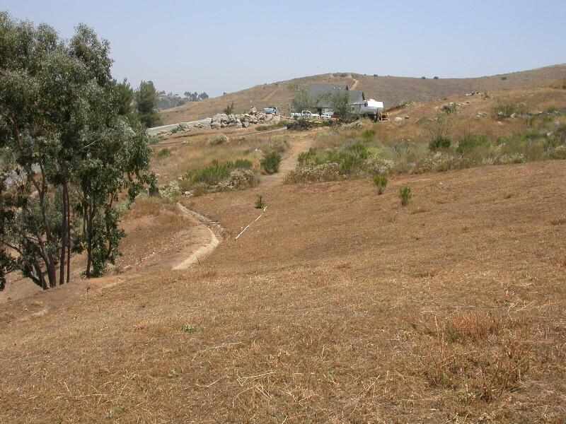

Rick,
That is why I need your little device. All my land is not that level. I am planting trees and ground cover on all the slopes. I'll watch the store for your tiltmeter. Thank You
