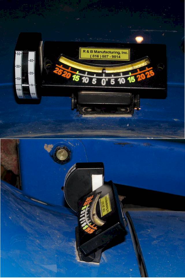

I had attached my original TiltMeter using the double sided tape and didn't want to remove the mounting bracket from the tractor. The bracket is the metal one with the two thumb screws and the interlocking ridges.
There was no way to attach the new, dual slope gauge to the old metal bracket. /forums/images/graemlins/frown.gif
So, I manage to remove the new fore-aft gauge from the TiltMeter by separating the plastic that attached it to the TiltMeter then gently prying the fore-aft gauge to separate the double sided tape. Fortunately, the tape stayed on the fore-aft gauge and I didn't break anything. /forums/images/graemlins/cool.gif
Here's what the fore-aft gauge looks like when attached to my old TiltMeter gauge. The TiltMeter is tilted back as far as it can go and still be readable. The top picture is taken from the tractor seat. I'm not going to leave it like this since there's not much contact area between the 2 gauges, I just wanted to show you what it looks like.
Hmmm, I'm not sure how this gonna work. /forums/images/graemlins/confused.gif

Hi Mike,
I have shifted the label a little, and shifted the scale a little
also. Also making numbers bigger. Experimenting with a
very rigid mount to put the dual axis part on top of horizontal
one. All of this combined, and I think we will be where we
want to be. (or at least a lot better). One thing I might
mention though. I see you have your meter laid way back.
This throws your accuracy off. You can lay it back about 10-15 degrees and still be pretty accurate. However, the more
it is laid back from vertical the higher it will read on a slope.
Example: If the meter says 20 degrees, you will actually be
at a lot less. It should not be tilted back more that 10-15
degrees. Yours appears to be much more than that.
I hope to have new version done Sat. Or Monday.
I'll keep you guys posted. Thanks, Rick

<font color="blue"> It should not be tilted back more that 10-15 degrees. Yours appears to be much more than that. </font>
Rick, that's how far I had to tilt it back in order to be able to see the scale on the fore/aft gauge. I'll be removing the fore/aft gauge and getting the TiltMeter back to its proper angle. /forums/images/graemlins/smile.gif
