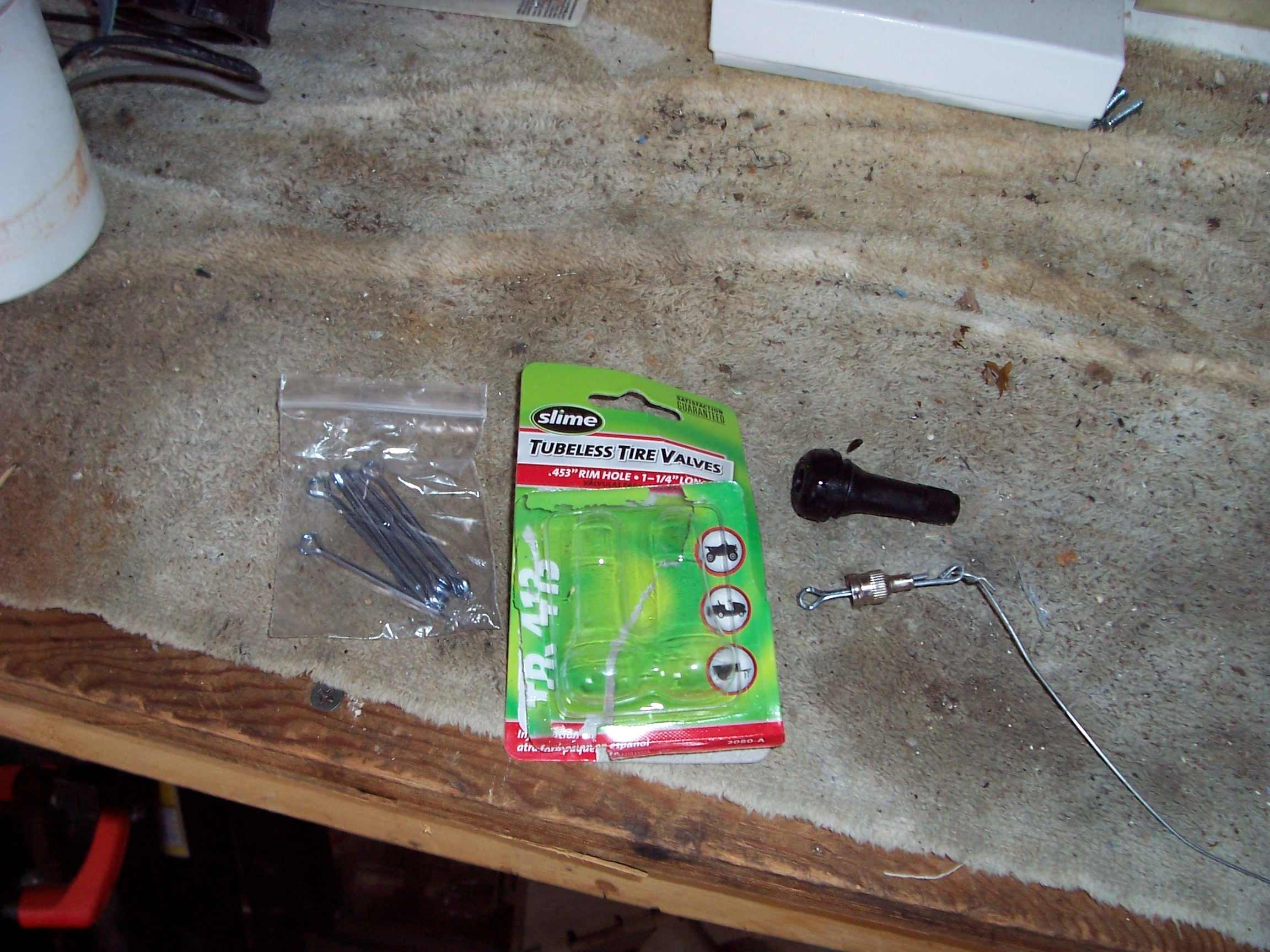

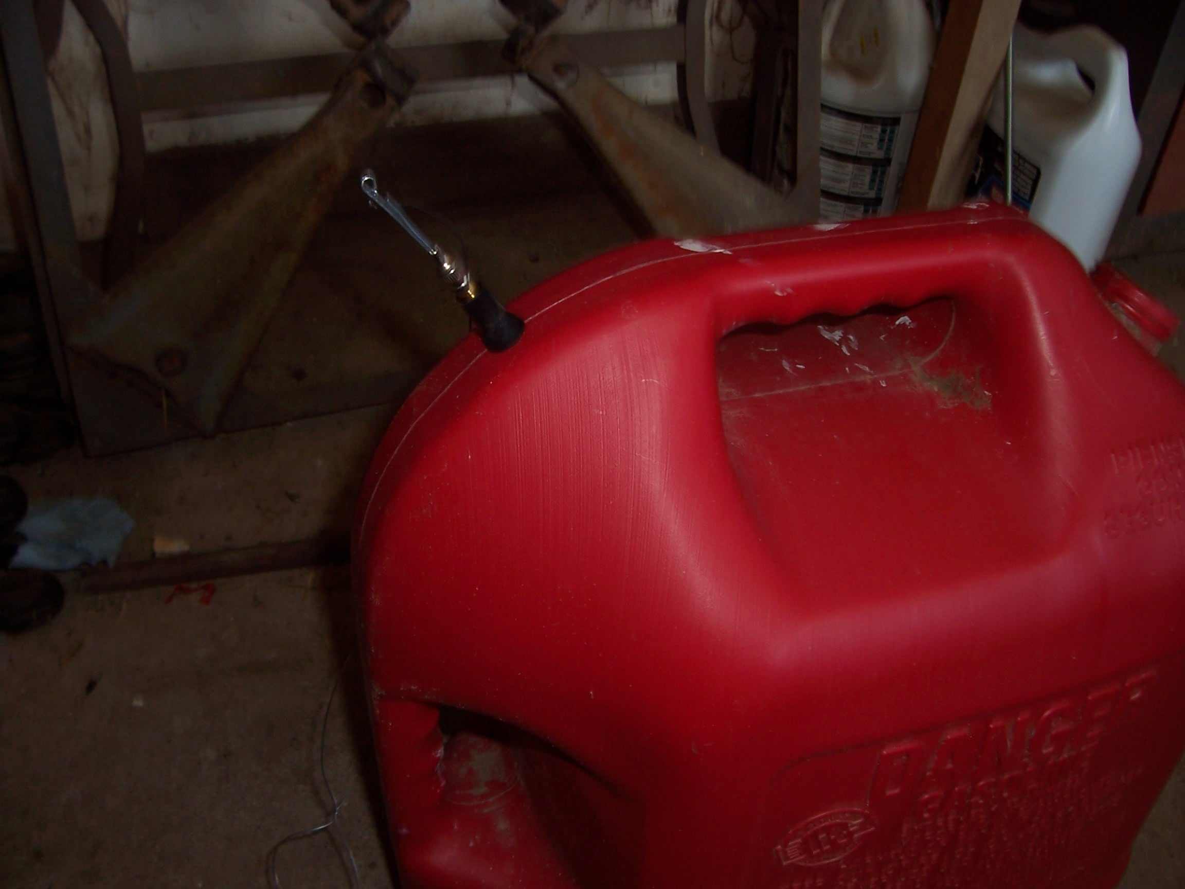

gwdixon - I drill the hole for the valve & thread a home-built valve insertion tool onto the valve (metal valve cap with a length brass chain soldered to it), feed the small chain through the fill spout opening, turn can upside down & fish the chain out the small hole with a piece of bent wire, pull valve up through the hole. Remove core & you're done - looks factory!
I have read where others have added valve stems to their cans but never could figure out how to get the stem in from the inside of the can. Thanks Ken. I followed your lead and got two installed today. I used a cotter pin inserted in the valve tool, but otherwise followed your directions.
Works much better now.
pic 1 my "valve insertion tool"
pic 2 my can all fixed up
