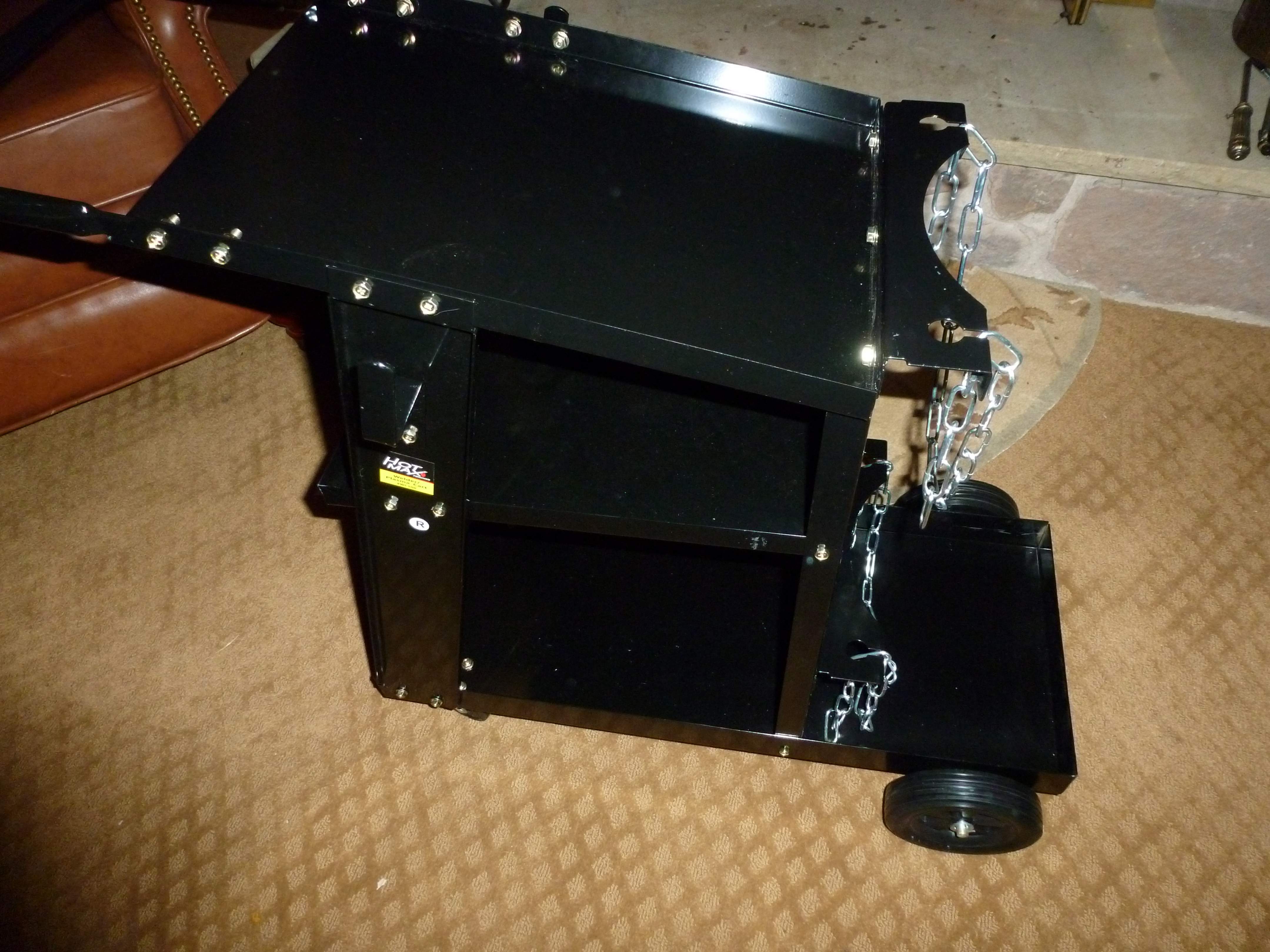

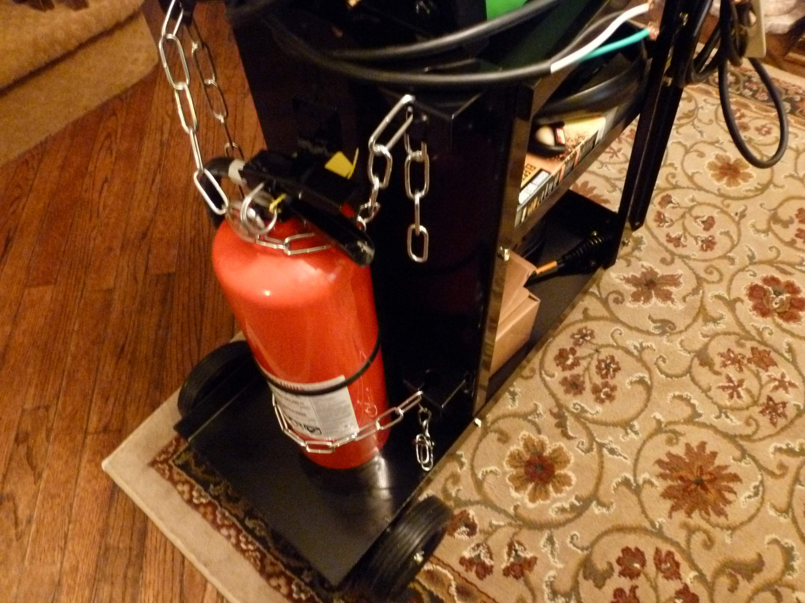

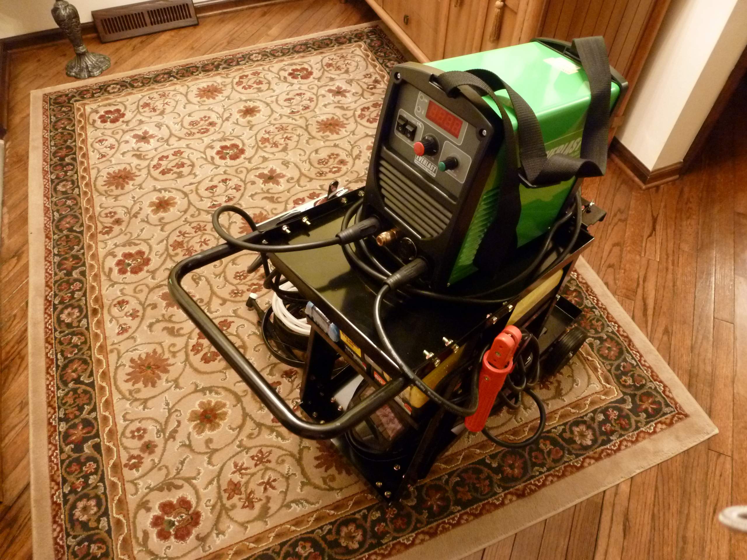

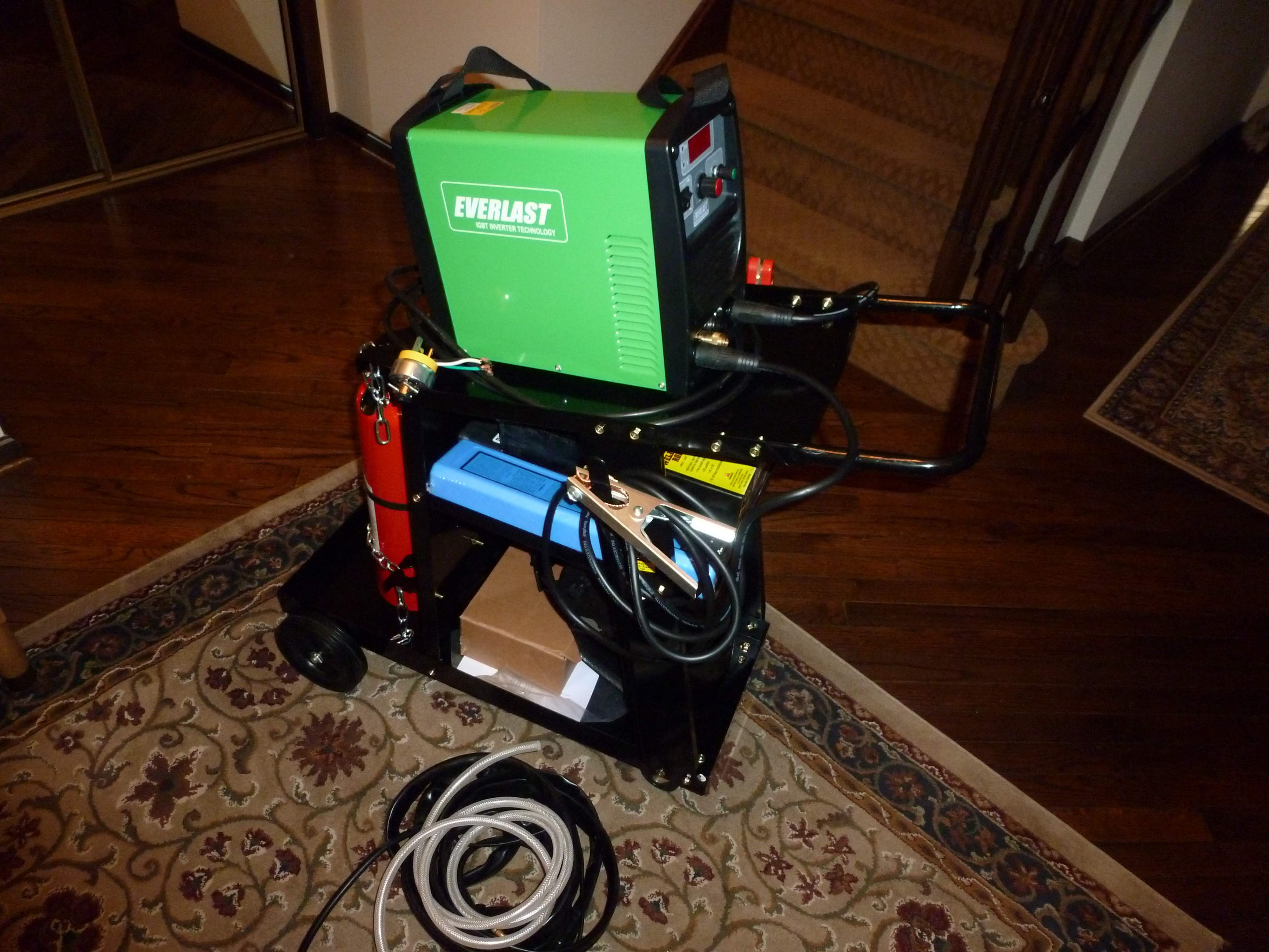

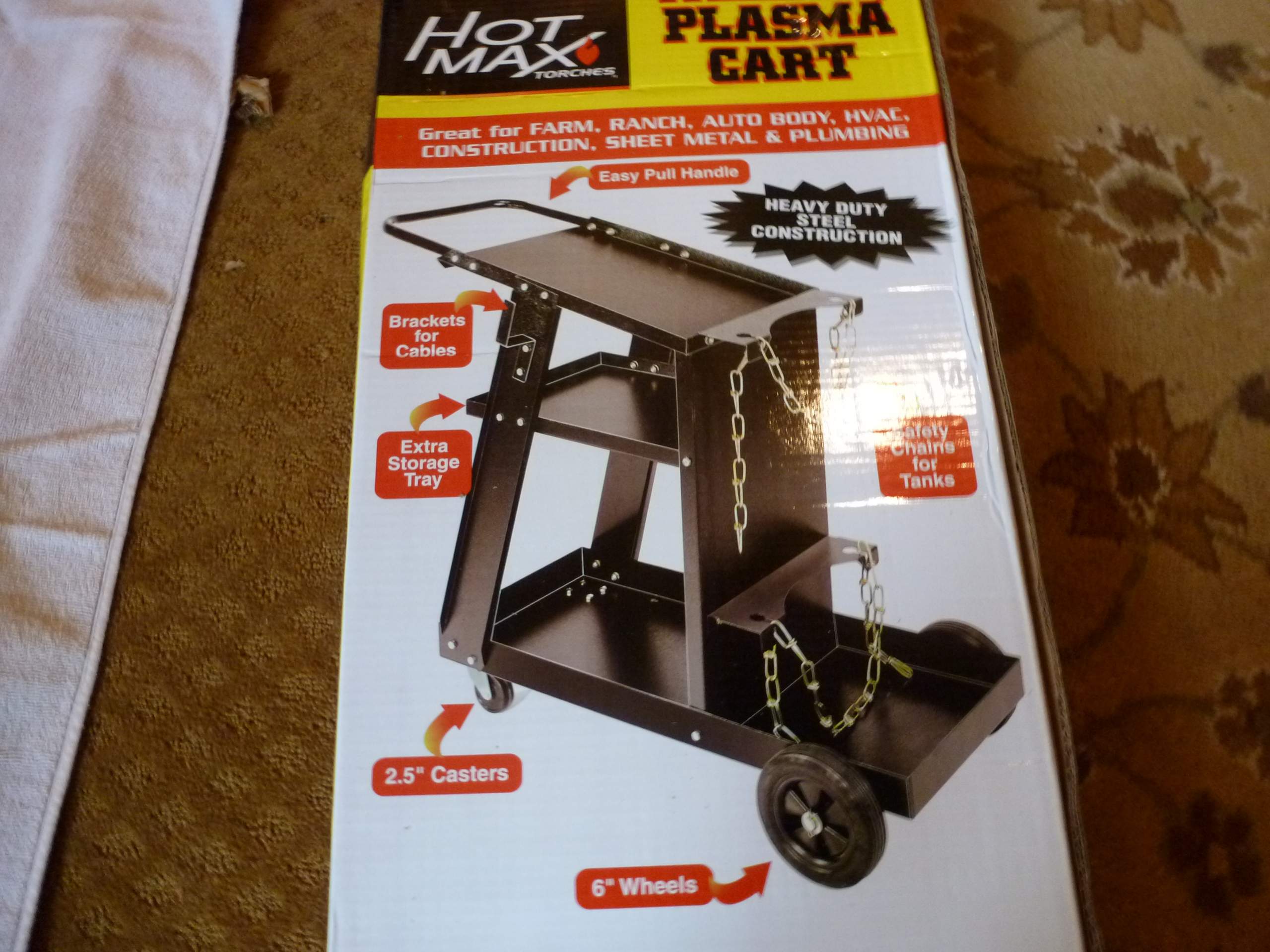

made lots of progress since last report. And my wife will be pleased to get the welding equipment out of "her foyer"...
Which luckily I can because my new cart rolls pretty easily.
I looked at the similar cart in HF, and it was only ten or twenty bucks less. This I found on Amazon, and it came well rated.
And I can see why. Adequately heavy, decent paint, quality hardware, all good. My memory is 65 bucks.
Thank goodness my wife likes to build these things, it's like doing a puzzle for her. I think she was assisting because she really
wanted the cart and its contents into the garage, where it belongs...

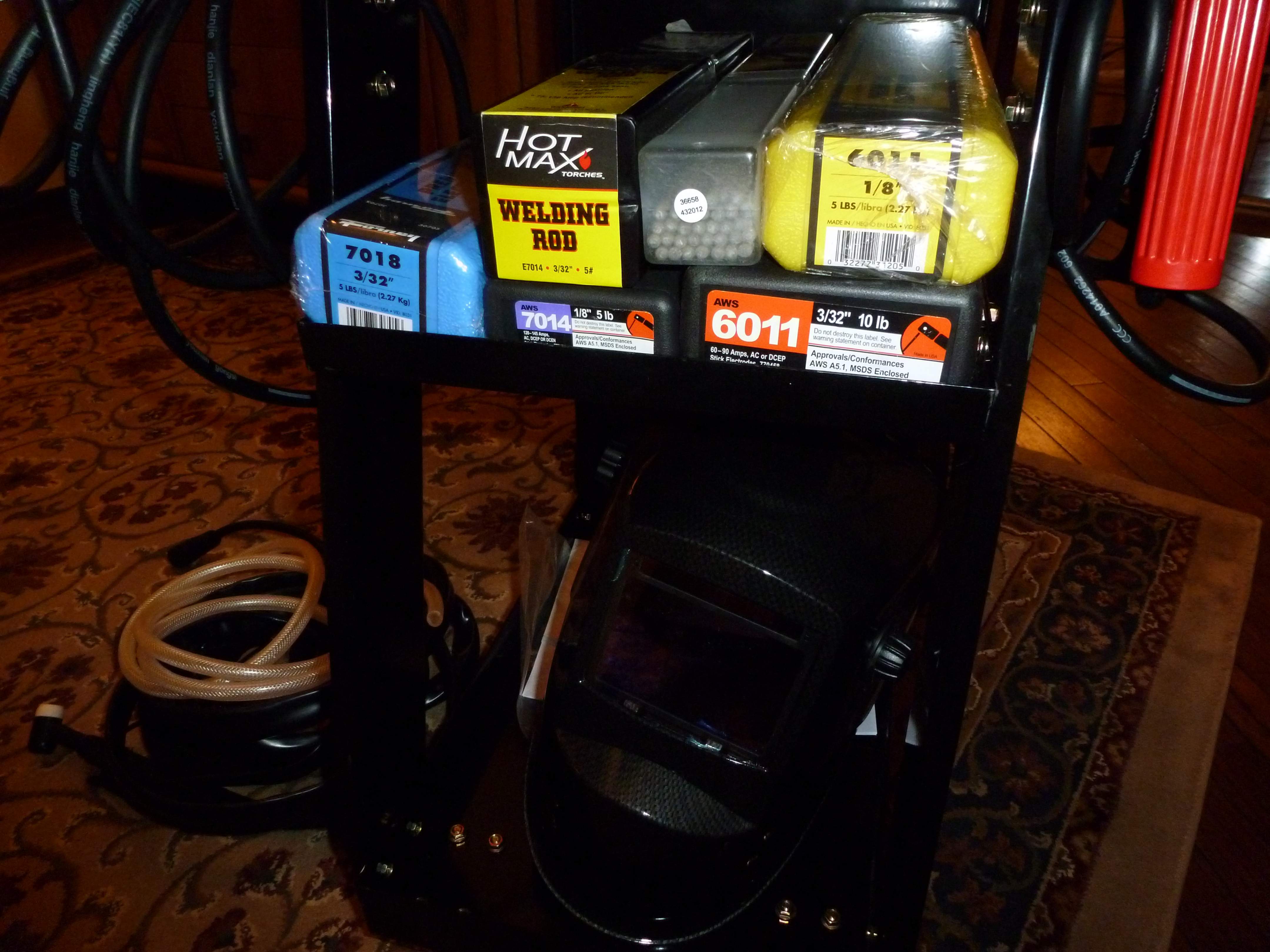

Everything seems to fit on the cart just fine. Stocked up on rods, a somewhat motley assortment, but to begin with I doubt the
brand of rod will be of any consequence. Now all I need to do is put the AC plug on and get somewhere to plug it in. The juice is not turned on at the barn yet, still arguing with the local electric company, who doesn't want to run the more expensive cable up the hill to the barn. Which they will do but we have to argue with them some more. Their position is very justifiable based on cost/benefit to them. But even if we have to buy our own transformer, we are going to get adequate power there. Which I have right in my home garage, where I want to start, but of course no receptacle. We have all new service and I never thought to ask them to put a separate 50 amp box on the inside garage wall.
I think I'm going to take the plug that came with the machine, go to Home Depot and make sure plug A fits into Box B and then I'll hunt down
an electrician. We have a small list of electrical to do's but this certainly warrants making the call. I mean, what could be more important?...:D
And while I'm doing that, I'm also making up a small toolbox for welding tools and clamps. Until my super duper welding table is built.
One small step for mankind...

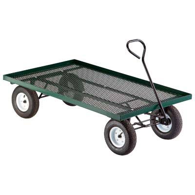

and I still would like to mount this welder on a little garden cart like in the pic, but first I'll see how this rolls in gravel and thick field grass.

I looked at my pictures again this morning and had to chuckle. Looks like I bought enough welding rods to last until
the next Ice Age. :D
I also wondered why the ground clamp is not insulated on the outside. Seems like an accident waiting to happen.
Obviously the teeth have to make good contact, but why leave the rest of the clamp bare? Isn't this worth an extra buck?
Mark from Everlast suggested as my skills improve, I might consider a different stinger. Are any of them more ergonomic?
And if one is right handed, does one weld from left to right or right to left?
I sure am ignorant. But trying not to be stupid. :dance1:
