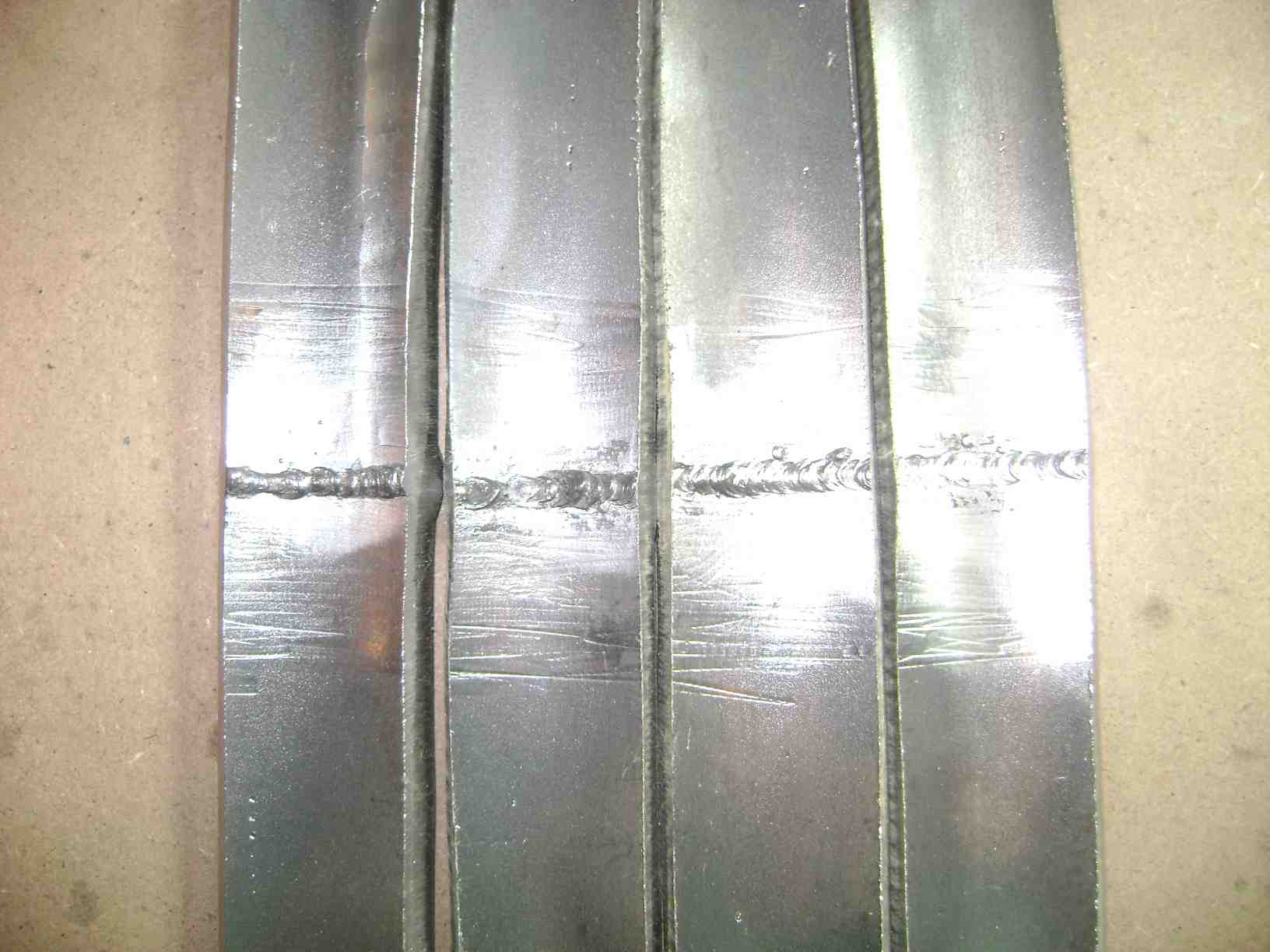

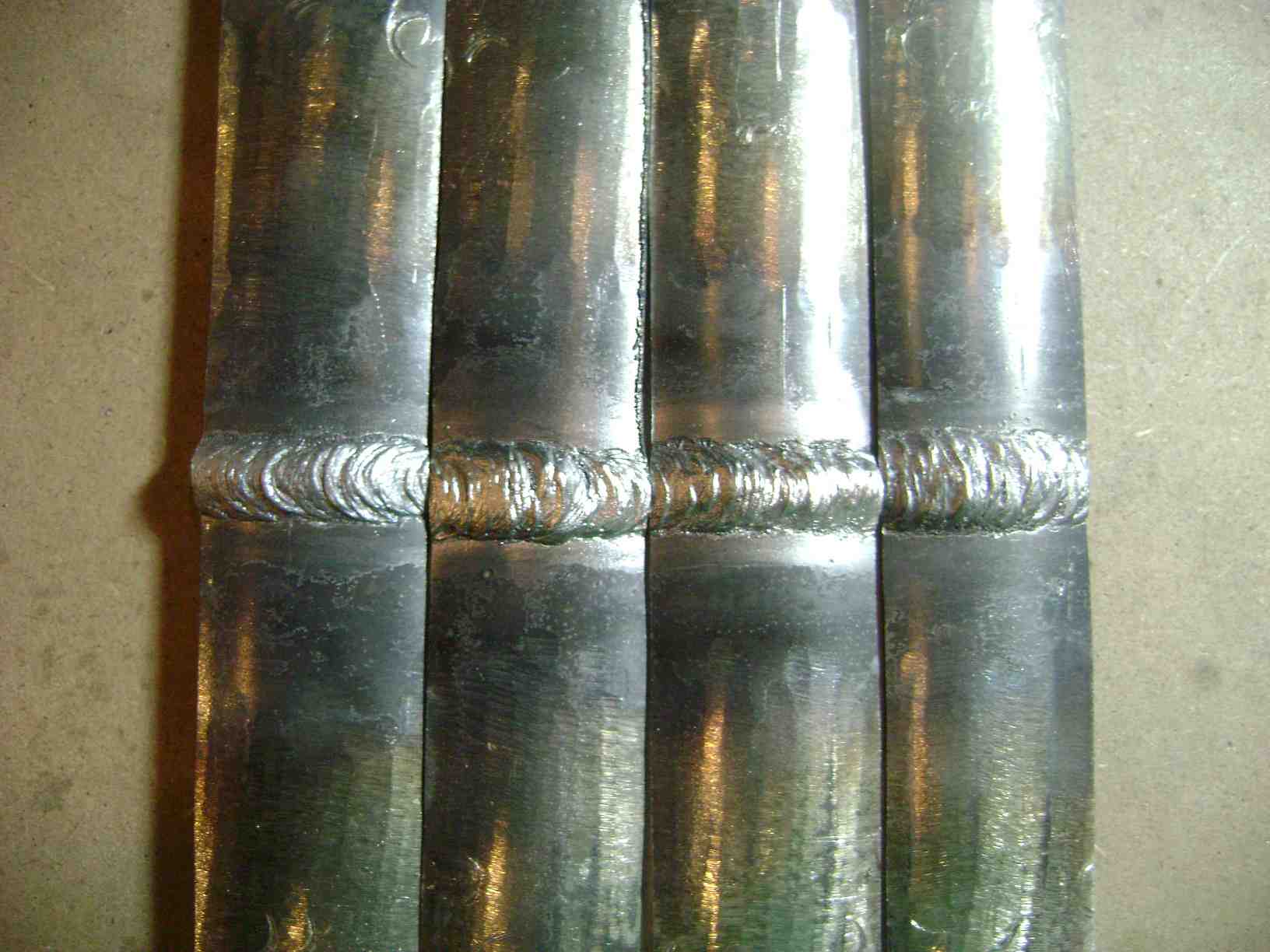

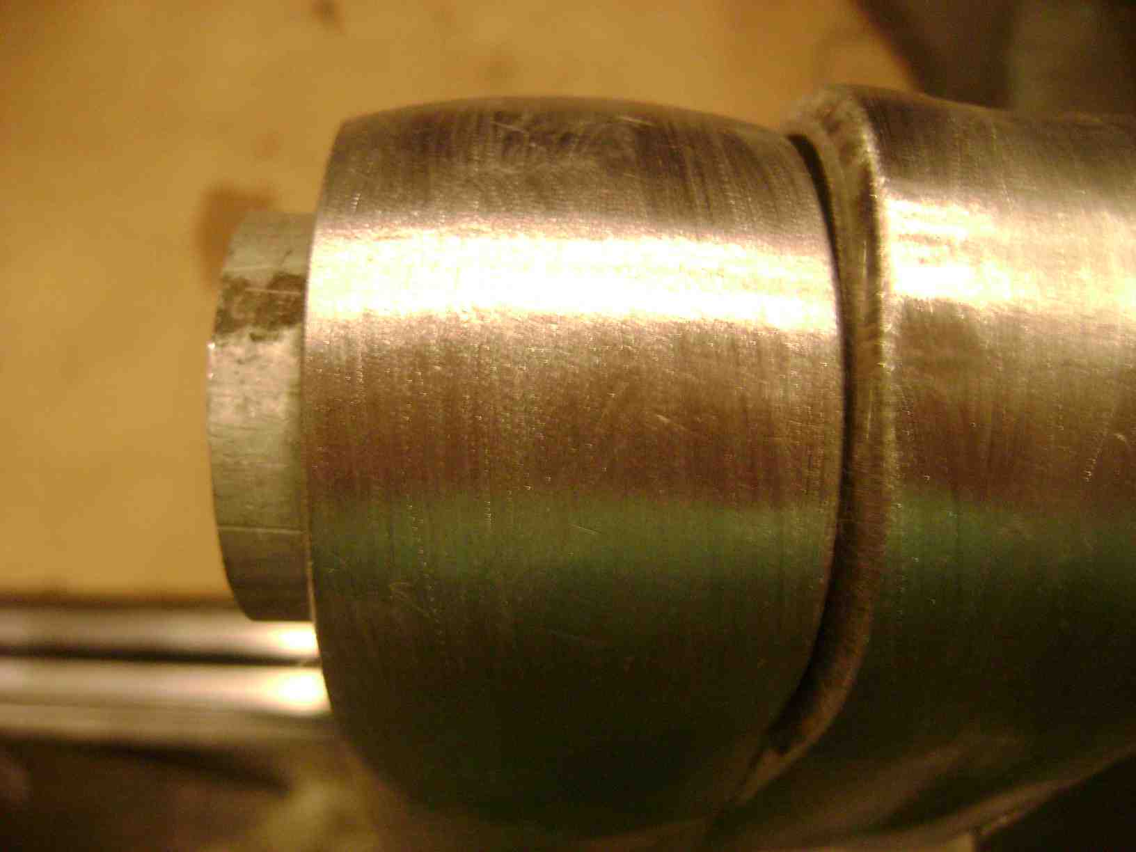

I still say it is very hard to beat Hobart's 335A 6011. If you're not working to a WPS / code what difference does it make if you use 6010, or 6011? I ran a 5-G open root pipe with 335A 6011, all four coupons bent perfect. Good enough for most of us here!
