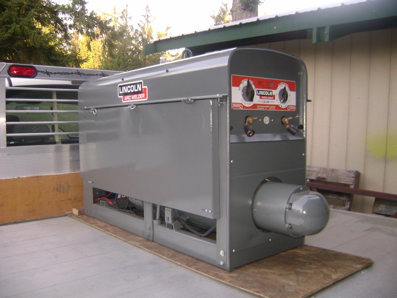

This one is my pride and joy, paid $200.00 for her! :dance1:

This one is my pride and joy, paid $200.00 for her! :dance1:[/QUOTE]
seriously nice machine. Onan or Kohler?

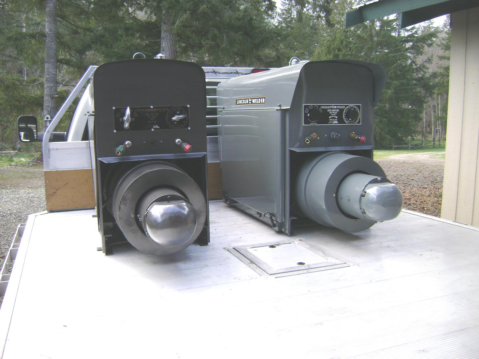

No they have a 4-cylinder 36-horse power Continental engine in them. They really don't have much for auxiliary power, and it is DC only, so you really have to watch what tools you plug into them!

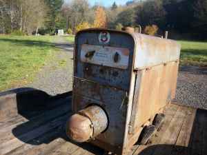

Oh yeah they sell real high through out the Mid West. I turned down $3,700.00 for that Red Face I posted above, made the guy mad as a wet hen too!:laughing: I paid $250.00 for the one on the right.:D

I restore them when I'm in the mood! I got one setting in the shop now waiting for me to get motivated!:eek:I hate painting all most as much as carpentry work.:D
