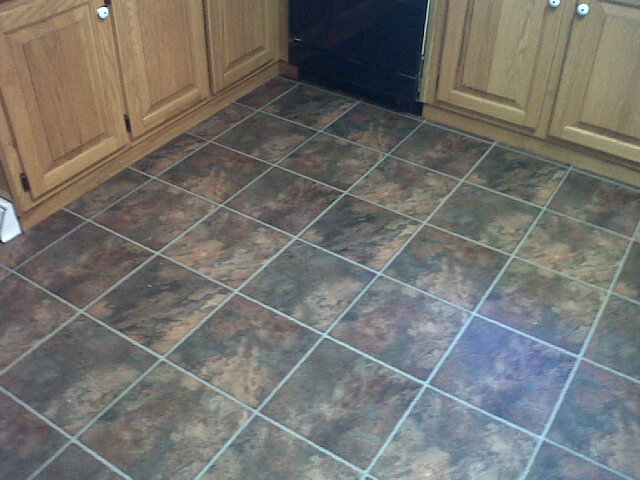

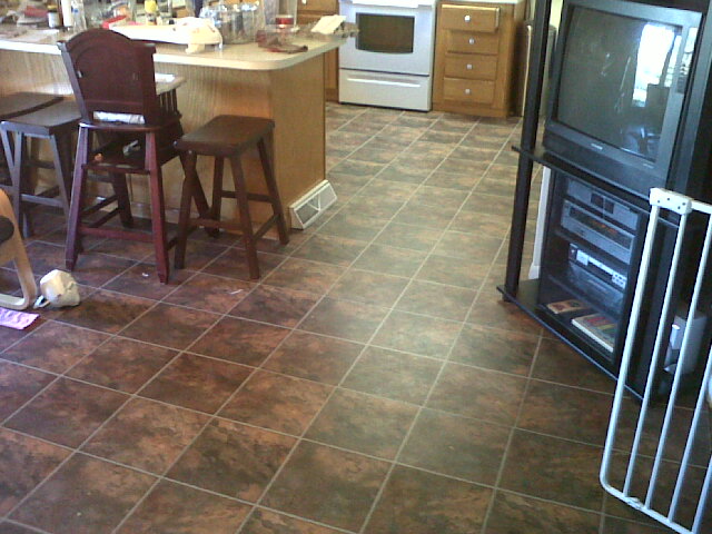

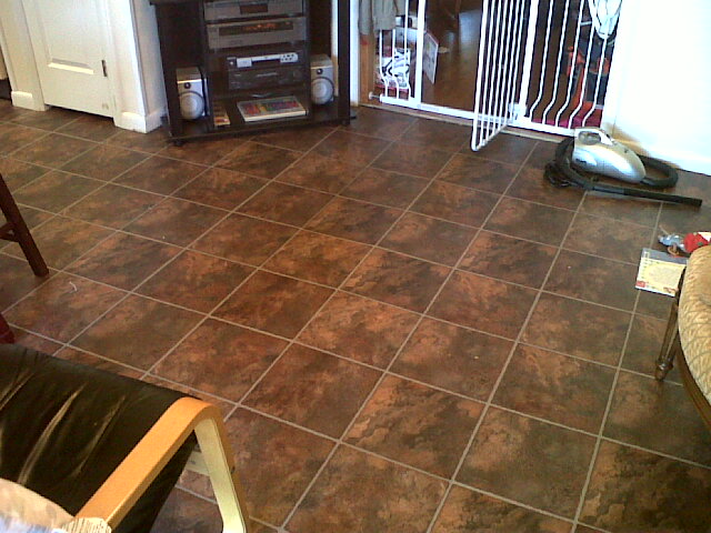

OK, except for the area just inside the side door, where I need to remove a section of subfloor to fix the old dry-rot issue. I am done.
Once I fix that subfloor, all I have to put in is just the last couple tiles.
Actually I have NOT done the quarter round either, but that can wait... The floor is fully functional and the wife is happy!
Here are some "after" pictures.
Be well,
David

Lookin' good! :thumbsup: And if Mama's happy...

David ... I like that! Ya did good man...you should be proud!! What are you going to do with the "dry rot" area?
