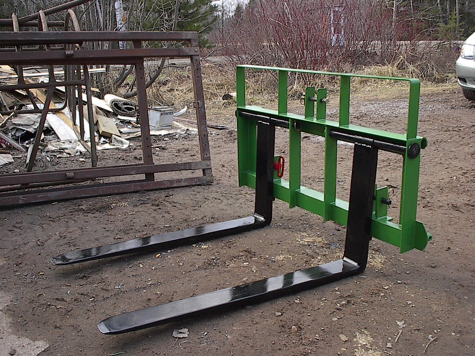

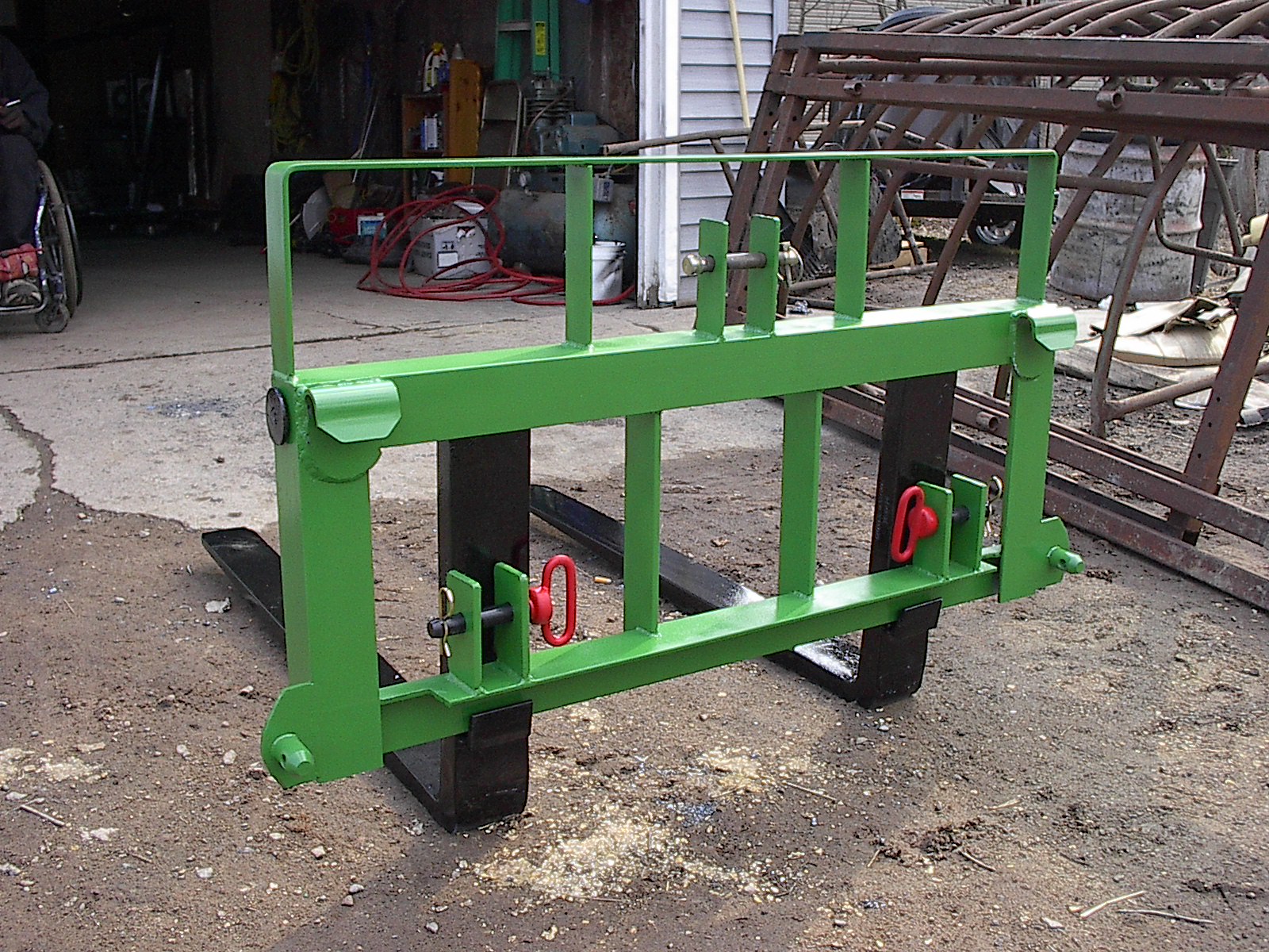

My neighbor, who owns his own small welding business built these for my 4100. I gave him a couple of pics of ones I had seen posted on here. Thanks to everyone who gave us the ideas! He also built me a disc hiller which I will post some pics of sometime... Sure is nice to have a welder next door!

I like the versatility of front or rear mount. Very slick. Nice fab and paint. What did you have to give for those? Just wondering as to which way to go with my projects. Seems as though sometimes you can buy dealer stuff cheaper than building yourself, with steel prices the way they are these days. Thanks.

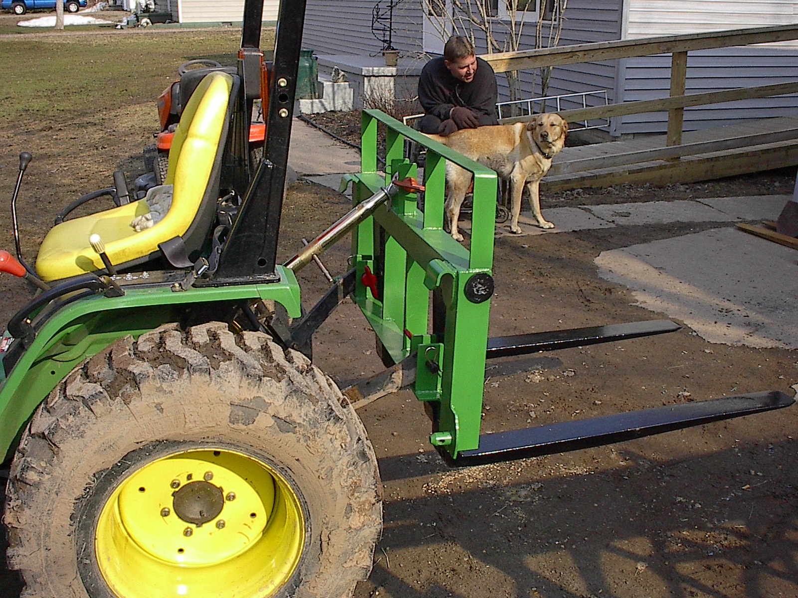

Do you ever find you wish that you could curl the fork more when you are carrying something near to the ground?
I am getting ready to make a set, and I was going to make the mount so that the QA is leaning forward somewhere between 20 and 45 degrees forward of vertical so I could curl them down low if I did not want something round (telephone pole or log) to roll off the front.
I am just curious if I am making too much of this and I should simplify my design. I really like the way yours turned out.

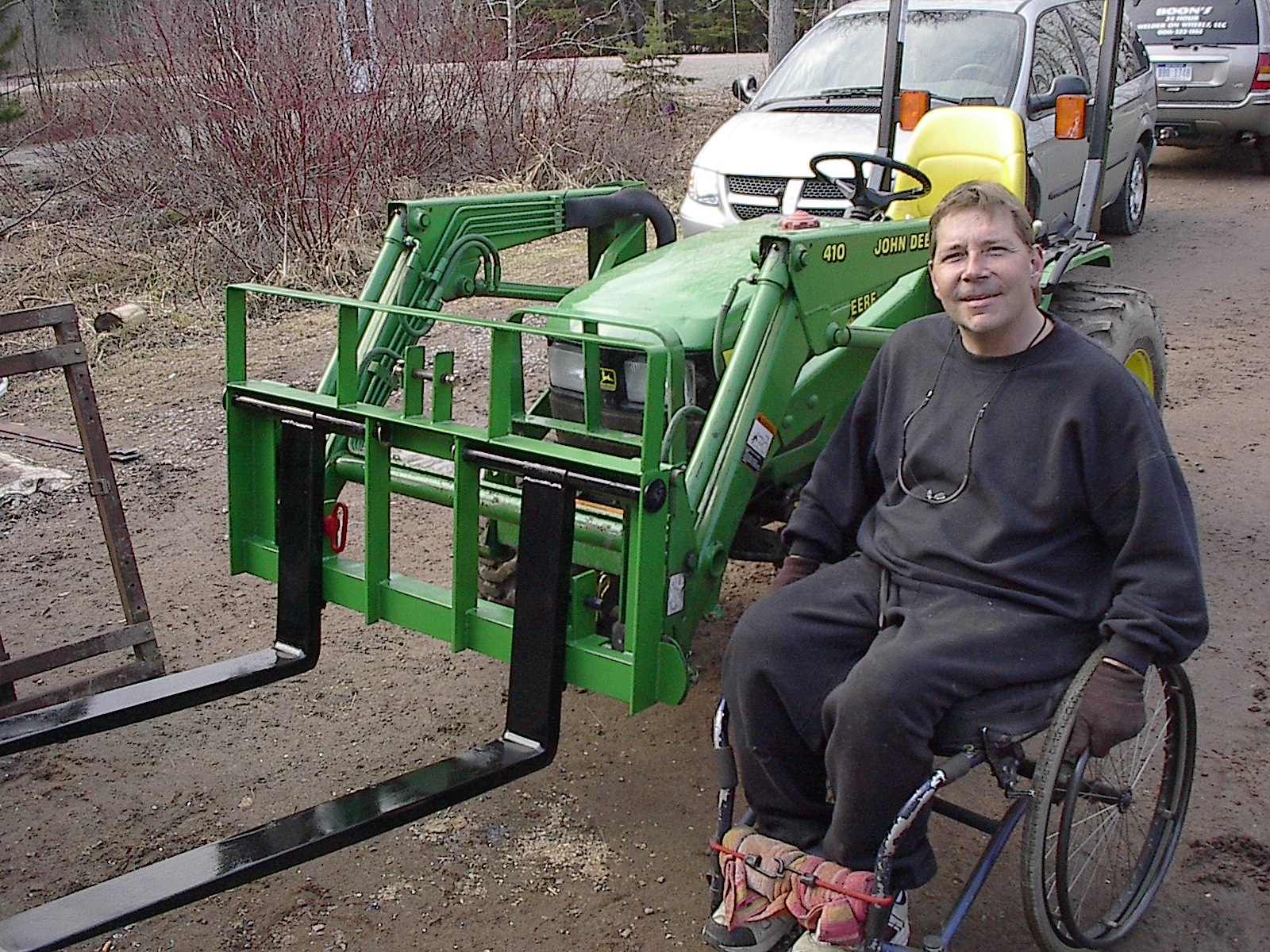

I got to the third picture & realized just how useful those forks are going to be. (assuming that's you in the picture...)

BX 24- I was worried about the curl also especially when you look at the JD bucket and see that the QA mounts sit off of vertical. I haven't had problems so far but I have only tested them a little bit. They do curl more than you would think since the forks are so long that any bit of movement (curl) at the base results in a large change at the end of the forks (I think you could probably figure out the exact amount with some sort of algebraic equation but I am not exactly a math scholar). It really doesn't take much curl to keep things from rolling off but I agree with your concern and will continue to test them.
Defective- No, that's not me in the pictures- that's actually my neighbor who built them! He calls himself a "welder-on-wheels" since he has a mobile welder unit and for the more obvious reason of the wheelchair- I think it's kind of clever. I tease him now that if I don't like his welding I'll pick him up in his chair with the forks and not let him down!

Not a bad deal. One other ? Are those Deere quick attach brackets for the loader mount, or hand fabed? Deere's site sucks when it comes to certain parts. If so do you happen to have a pt#. Thanks again.

Yes, those are JD QA brackets. The part numbers that were just listed are correct. You have to buy 2 of each (not sold as pairs). I had to argue with my local JD dealer owner before he would even look to see if he could order them, but it seems I always have to do that. He knows nothing about CUT's because he mostly sells small JD mowers. His original line to me when I asked if he could order them was "if it is welded to another part, you can not order it as a separate part", in other words he said I had to order the whole bucket! I asked (begged) if he could just look on the computer to see and he gave me the same line he always does "I don't know how to look up parts on the computer". So finally he got the secretary to look and surprise- I could order them (well, it was a surprise to him). Anyway, I paid $42.00 for the set of 4 mounts.
