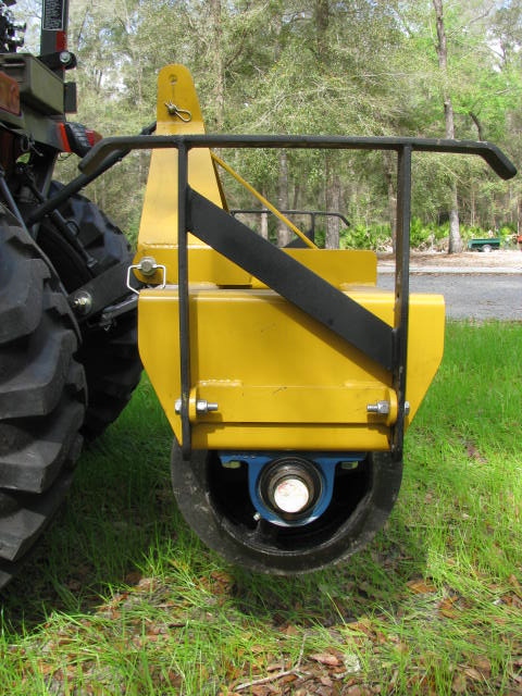

Two factors to consider for ballast on the Three Point Hitch, the most effective kind, is weight and extension to the rear.
The farther to the rear ballast extends, the more effective the weight is because of leverage.
For that reason Rotary Cutters and Box Blades are the two most commonly carried ballasts.
Three Point Hitch ballast also relieves stress on the front axle and wheel bearings when loader is burdened.
Rather than a Ballast Box, if you want weight close in, consider a Cultipacker.
Photo #1-2 Cultipacker used for rolling in seed; 960 pounds. Photo #3-4 Rollover Box Blade as ballast; 625 pounds.
Soggy Water Oak in Photo #3 weighed 1,400 to 1,600 pounds.
