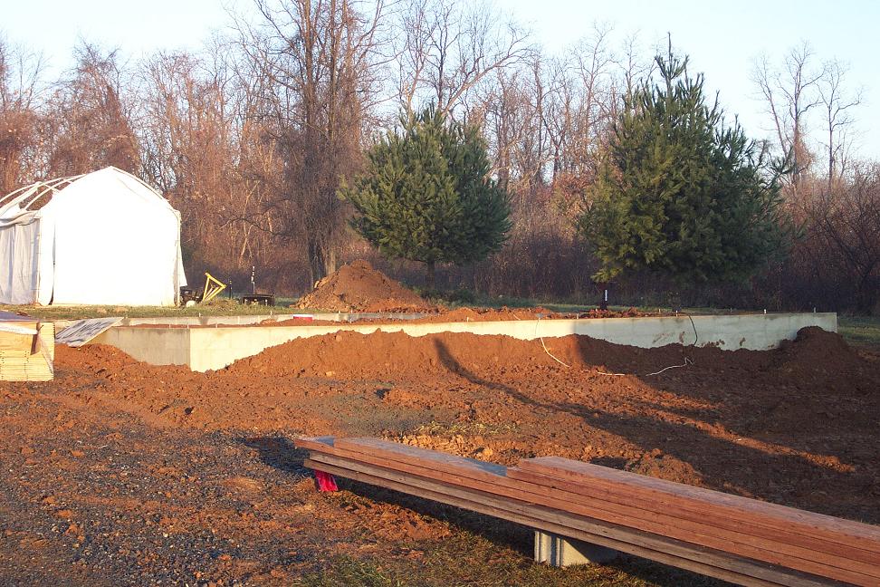

No pic updates, but then the hole in the ground is pretty much the same as it was. Contractor called me, he has permit in hand and the hole will be inspected the next couple of days, and the footers will be poured on friday.
