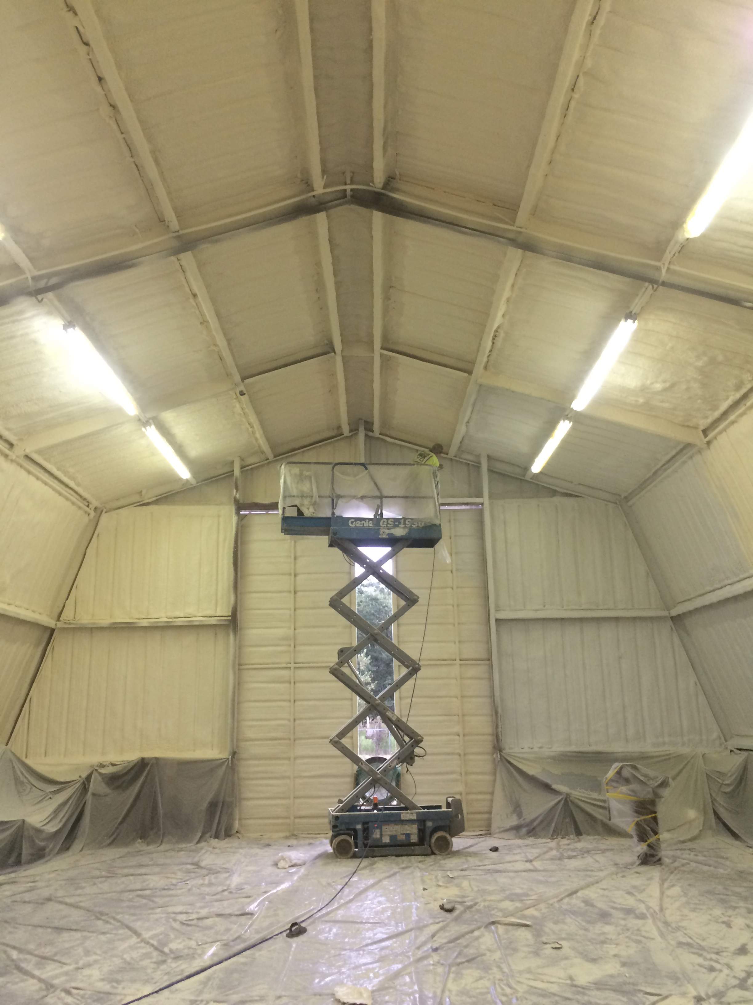

Hopely you won't have the confetti problem like I do. Below is a picture of a Fab shop we sprayed a while back. 3" of closed cell foam painted white.
