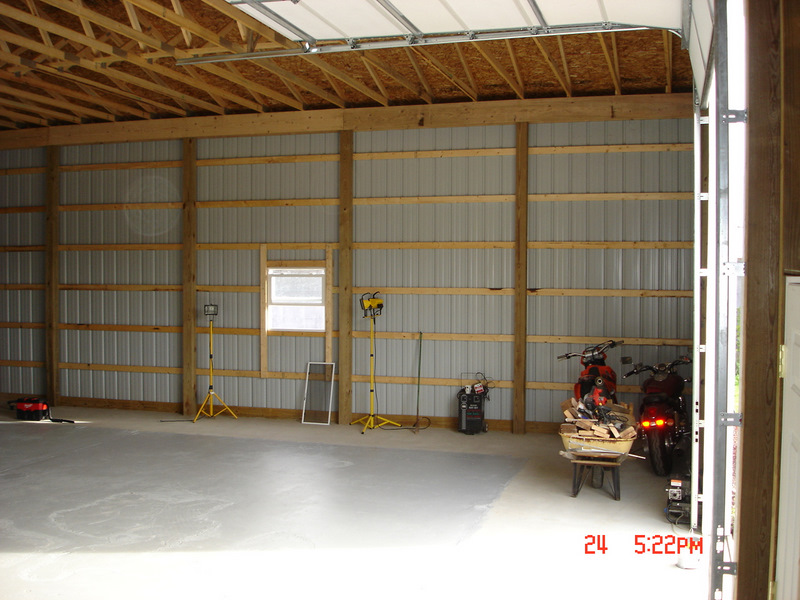

Take the money you saved and buy a 14 foot tall main structure. You will not be sorry. It is the best money you will ever spend. I was pricing out pole buildings and I discovered that the difference between a 10 foot high 40 x 60 building and a 14 foot high 40 x 60 building was less than 10%. Wait a minute, I am getting 40% more building for 10%?????? WTF? That is a huge increase in usable space.:D:D:D:D
As a structure assumes the shape of a cube it becomes more efficient to build per cubic volume. The roof and supporting structure are much more expensive than the side walls because they have to handle snow loads, and it doesn't matter how high off the ground they are. The side walls have to handle wind loads. Not a big deal. So since your expensive part is the roof, push it up there as high as possible and get the space for almost free.:p
I wish I had gone to a 16 foot building...I didn't think about the possibilities because I was dealing with the loss of 40 years of stuff and the building, but if I had it to do over again I would have spent the extra $1500 to go to a full 16 foot side wall. But hey, 14 is prettty sweet:D:D:D:D There is amost nothing that can be driven down the road that won't fit in there.:cool::cool::cool:
