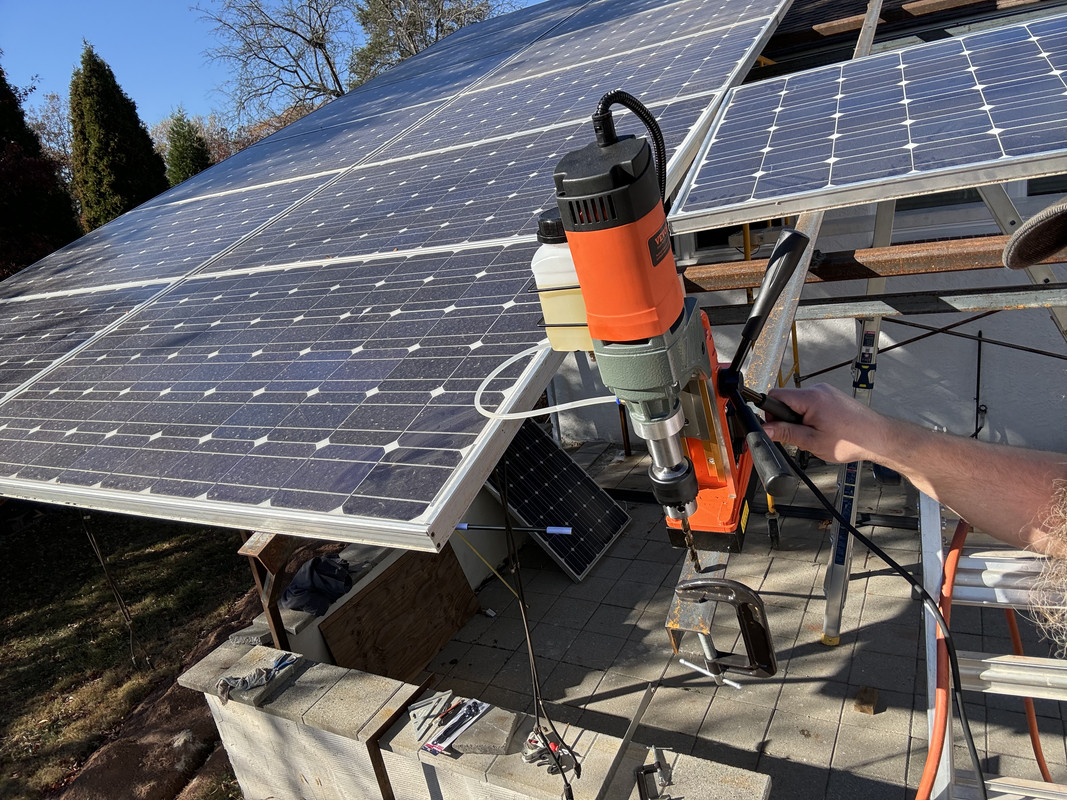

Got 2 sets of rails up, i want to finish the panel mounting while the weather is fair. That magdrill is really something else. Half inch holes in 15 seconds.

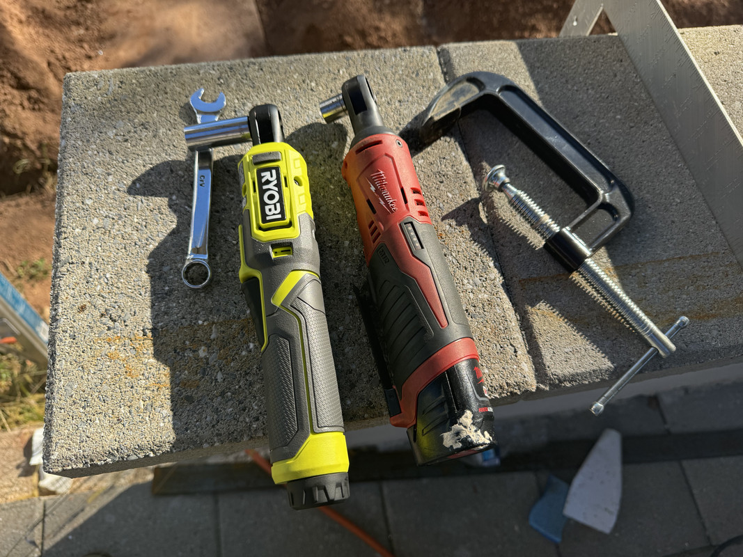

So I saw this ryobi ratchet on clearance for $45 at HD, and I thought, why not. Today, I put it to the test.
It put the rubber washers on no problem, but when it came to the nylon nuts, it couldn't cut it. The milwaukee, however, managed to crush my pinky against the rail in a way that I couldn't let go of the trigger. So that was fun.
The milwaukee is $120 without battery. The ryobi is $45 with battery. So if you have a lot of light duty tasks, it's decent enough. And it works as a manual ratchet too.

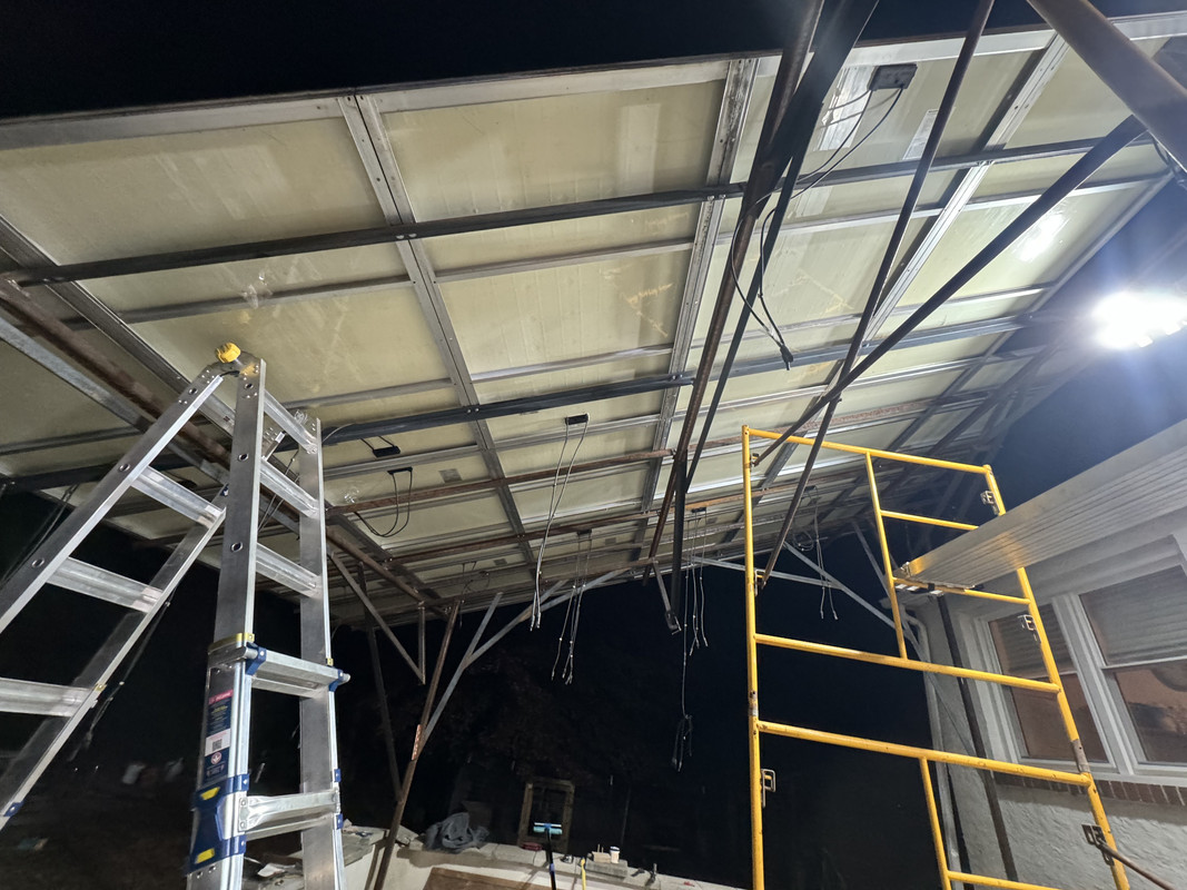

5 more panels up. 17 of 24 for this array. I want to try and squeeze another 6 panels onto the structure. Magdrill really saved me, but carrying panels up ladders is still a challenge.

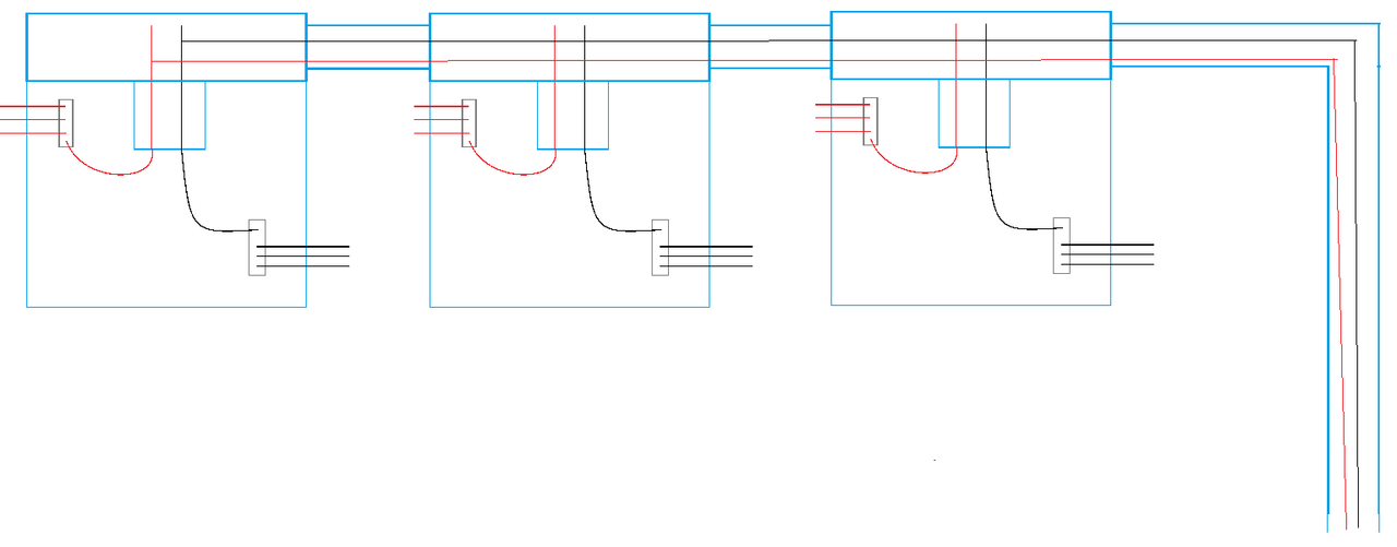

So this is my combiner design. Each 12ga wire will go into the box with a grommet from the solar strings. Then screw into a 4 port bus bar, then a 10ga wire will take the power through the conduit into the house and to the panels. There's 3 sets of 15 panels to power 3 inverters. Each input will have 3 sets of 5 panels. So each combiner box will have 15 panels on it.
