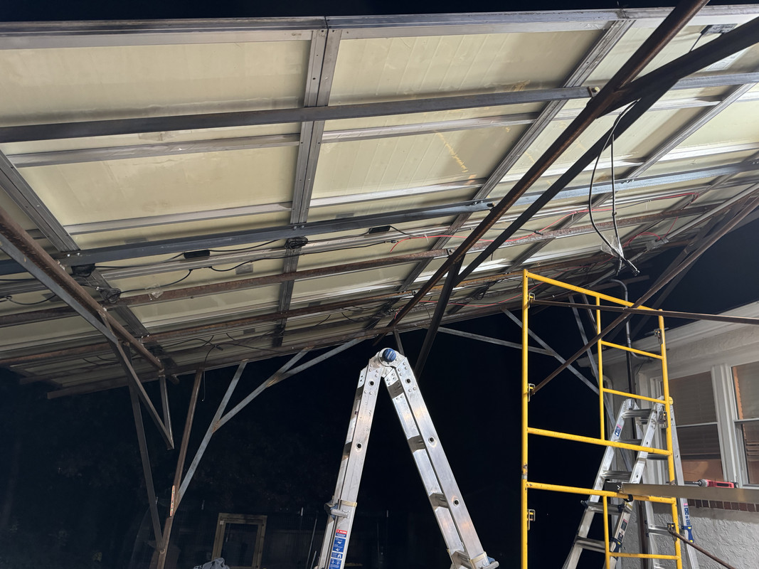

I hooked up all the panels in 3 strings of 5 to go to the inverter, I finished the conduit. I got the pv wiring done inside. I think I'm going to start with just 2 inverters in parallel until I get more batteries. And speaking of batteries, I need to finish the battery shelf, and finish building the battery pack.

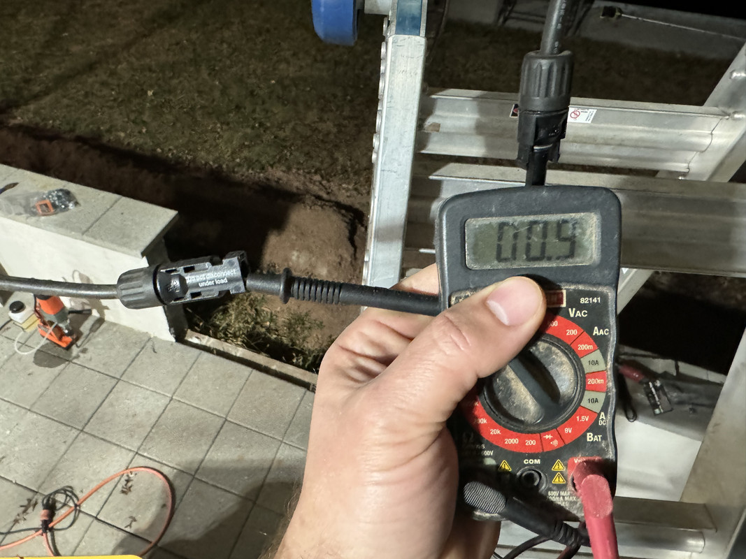

This is indicating that the female mc4 is negative, while the male mc4 is positive, right?

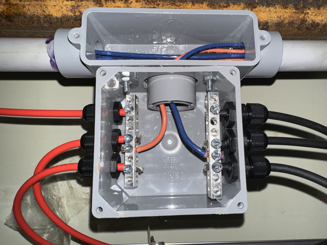

Getting there.
Ingenious use of the buss bar - is it code (honest question, I have no idea)? I used polaris connectors for something similar, though it was also in a much tighter spot
   / New garage time!
#1,425
The only code violation i'm aware of is when 3 or more strings are joined there must be fuses.
I got around the issue by putting in-line fuses at the panel connections. The panel wire is 12ga, but the wires going into the joiner are 10ga. When there's 3 or more strings, the amperage is to high for 12ga in the event of a grounding worst case scenario. So between the panels and the wire from the box there are inline 20a fuses.
High voltage arc's, so there's that to consider. However it's 3kv/mm for arcing, so you would need 76,000v to arc an inch.
I'm going to get bigger bus bars to get rid of the strain/bends. The wire is not very flexible. I want it to come strait in.

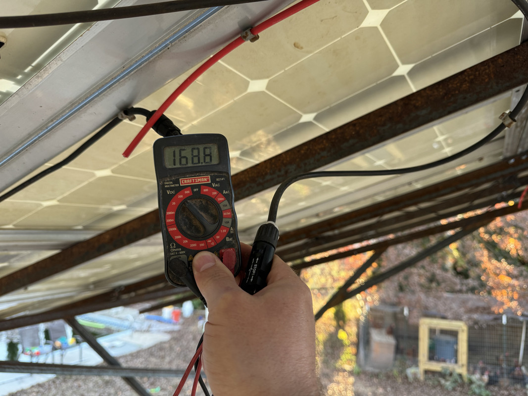

I was not sure if 5s or 6s as far as voltage since my mppt is 120-250v, so I checked my voltage when the sun was almost set, to see where I stood.
I'm pleasantly surprised.

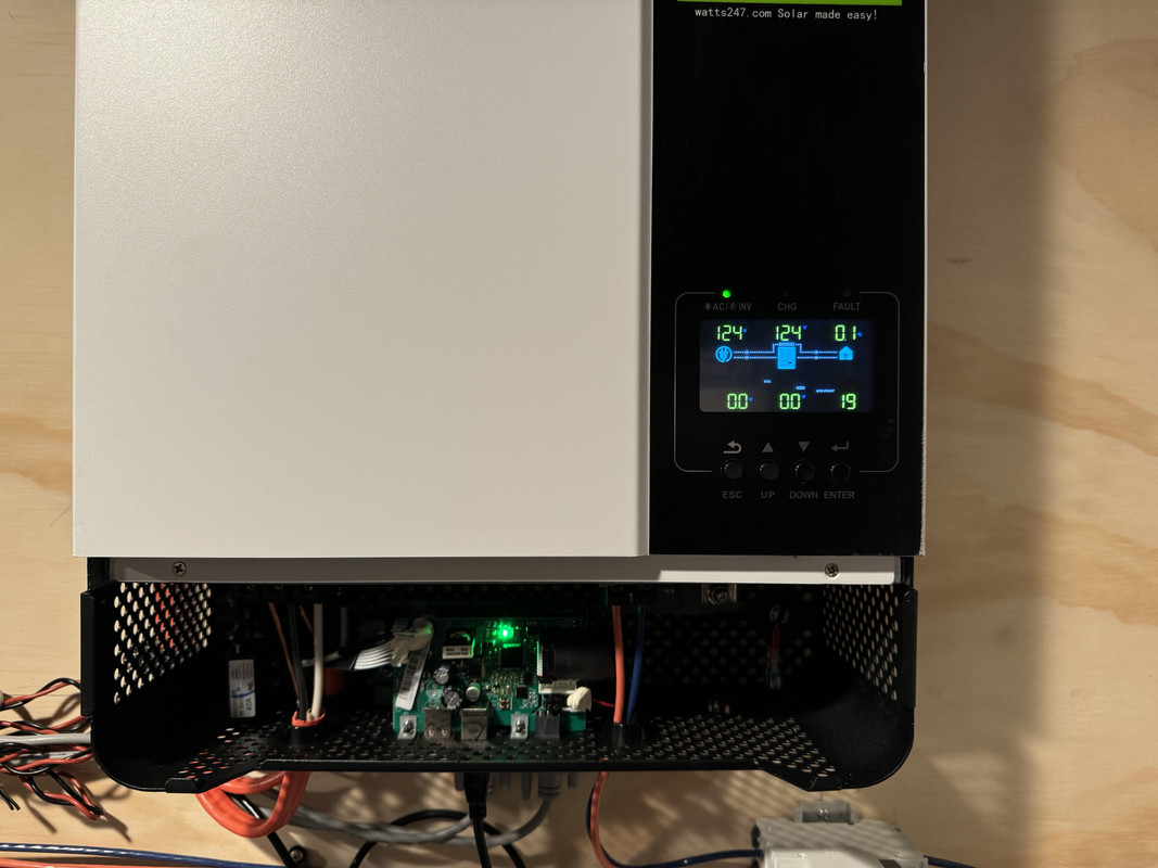

Got the bus bars installed and cleaned up and closed up.
Got the wires cleaned up, and the pv wires run.
I got the first inverter ONLINE! It idles under 30w.
