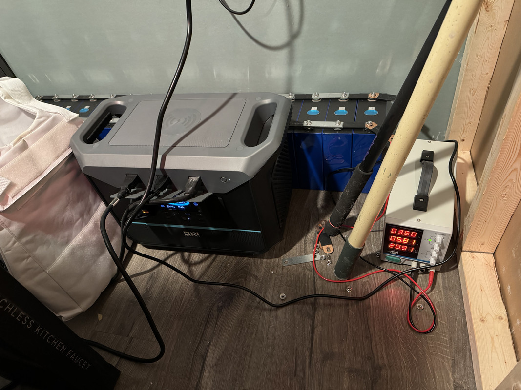

***Speaking of battery packs, I started but accidently left them in parallel for balance charging for like 2 months, but I didn't take them to 3.65v, when I turned it off they were at 3.3x and now they are at 3.29v. ny chance I've accidently balanced them?

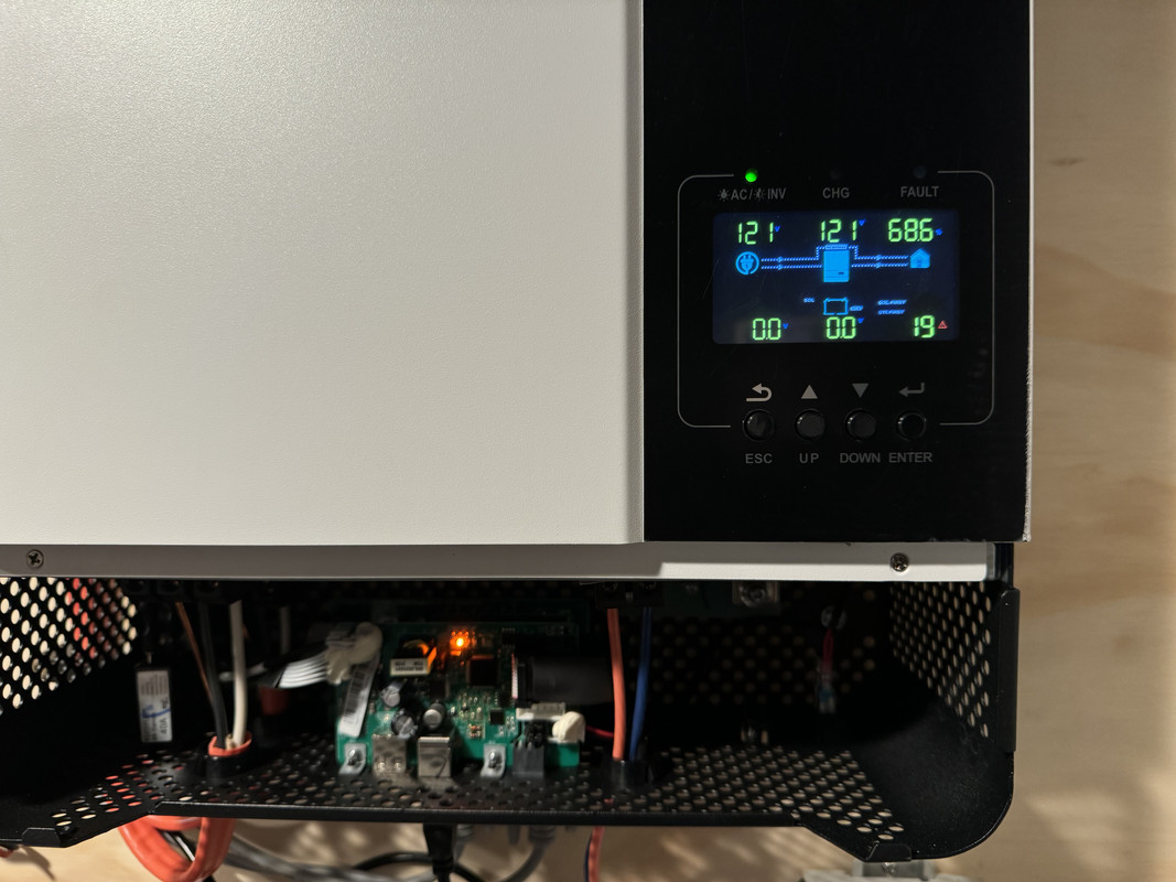

Yes, this will be an off grid setup. There's 2 types, grid-tie, and off-grid. Grid tie connects to the grid and feeds back into the grid your excess solar production. Off-grid charges batteries.
I have one battery pack, which I'm building now. It's 15kwh and the battery management system is rated at 100a. It's 48v, so the maximum drain on the battery is 4800w.
I have 6 inverters, each rated for 3000w, with a surge of 6000w. So even if I hooked up all of the inverters, I couldn't utilize them because I would hit the maximum discharge of the battery.
I needed power in the garage, and now I have it.

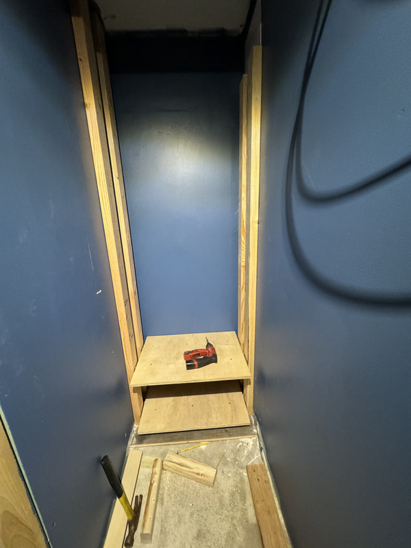

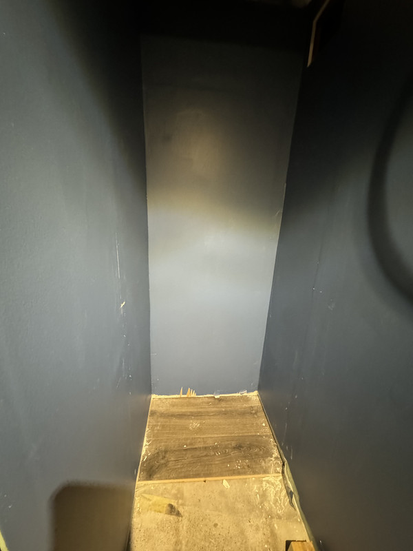

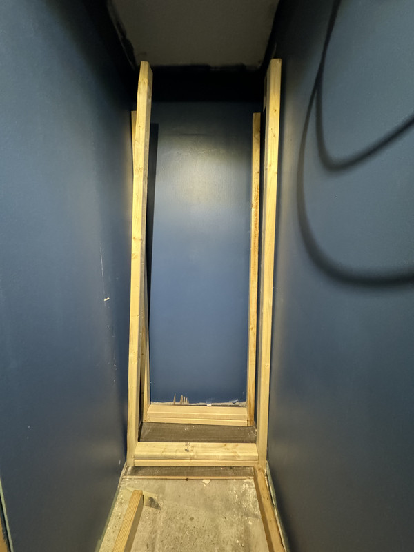

Batteries on charge to top balance, and started the battery room. It'll have room for 6 packs. It's 27" wide, 2x3's going up the wall for the shelves which makes the shelves 24" wide. The packs are 21.5" wide, so I should be good to go.

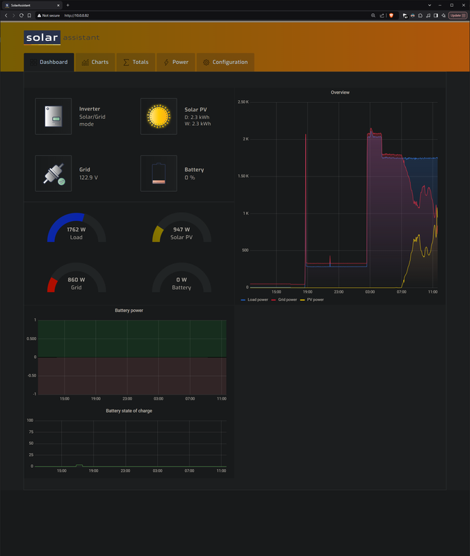

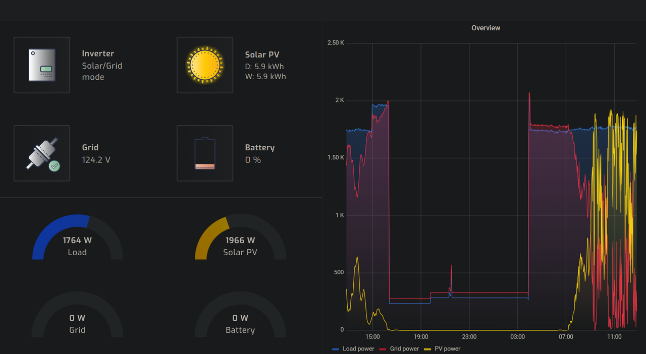

I wanted to be there the first time I switched on PV, but I didn't want to lose time. and get some history. I do not get up with the sun, so I flipped it on and hoped I hooked everything up right.
And as it turns out, i did!
And as it turns out, it is the FIRST overcast day in 2 months, we're having an incredible drought.

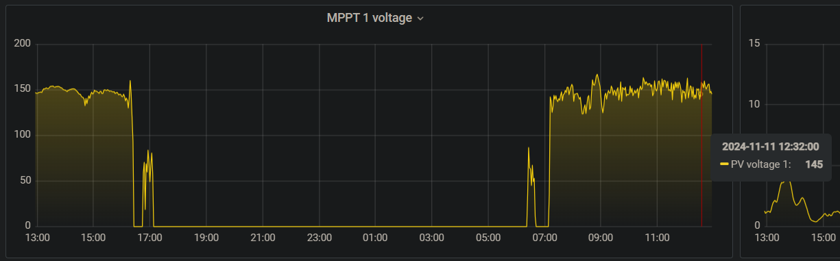

#1,437
Working on the battery closet still, not very exciting. Battery is still top balancing.

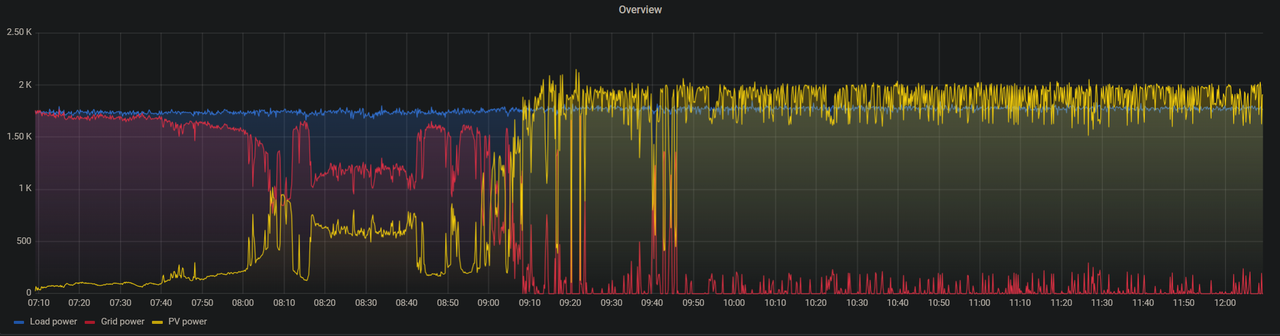

What is exciting is my ocean ev is charging entirely via solar, as it's a much sunnier day today.
From the charts I've learned a few things. Panels hit their voltage relatively quickly and maintain it consistently. The amperage fluctuates with conditions. Which is relevent when you consider startup and operating voltages of the mppt's. When 3600w of panels hit 42w of power, the voltage was 142v.
The inverter manual says startup voltage is 150v, operating 120v-250v, but it starts doing stuff before that.

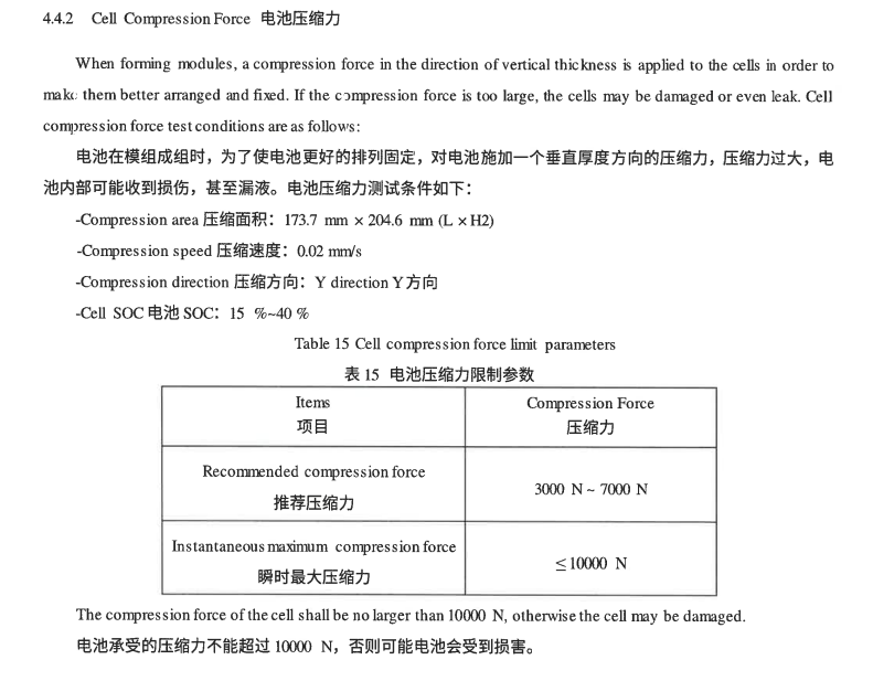

So apparently cell compression is super important and relevant to getting the claimed cycles out of the cells. Between 3000-7000 newtons.

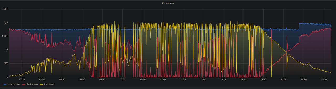

So wrapping cells in kapton tape looks like it's not going to be enough. So I reached out to hoover to get some 3/8" aluminum plate and all-thread. I figure if I'm going to do it, I'll do it right. They claim 21 years if I cycle the packs once a day, and i compress them. 7000 newtons is 1573 pounds. 10ft-lb of torque is 1600lb of clamp force, spread across 4 bolts is about 2ft/lb each should be sufficient.
Today's power has been much more consistent than yesterday. Yesterday was all over the place due to clouds.
Yesterday:
Today:

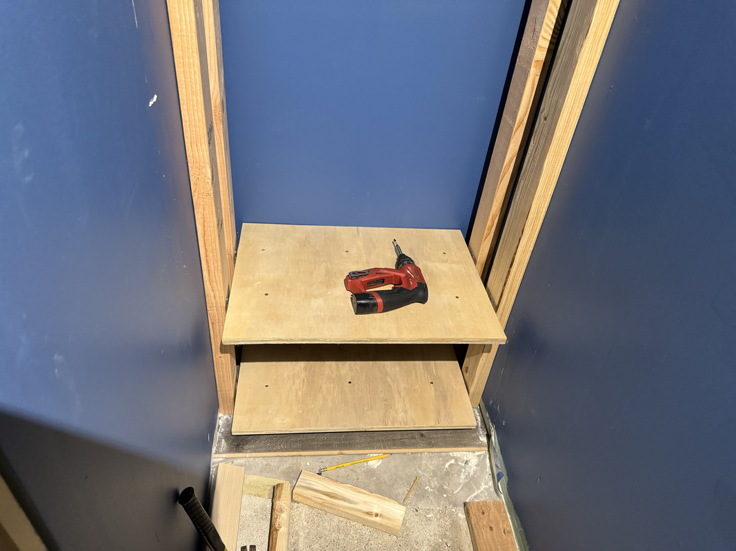

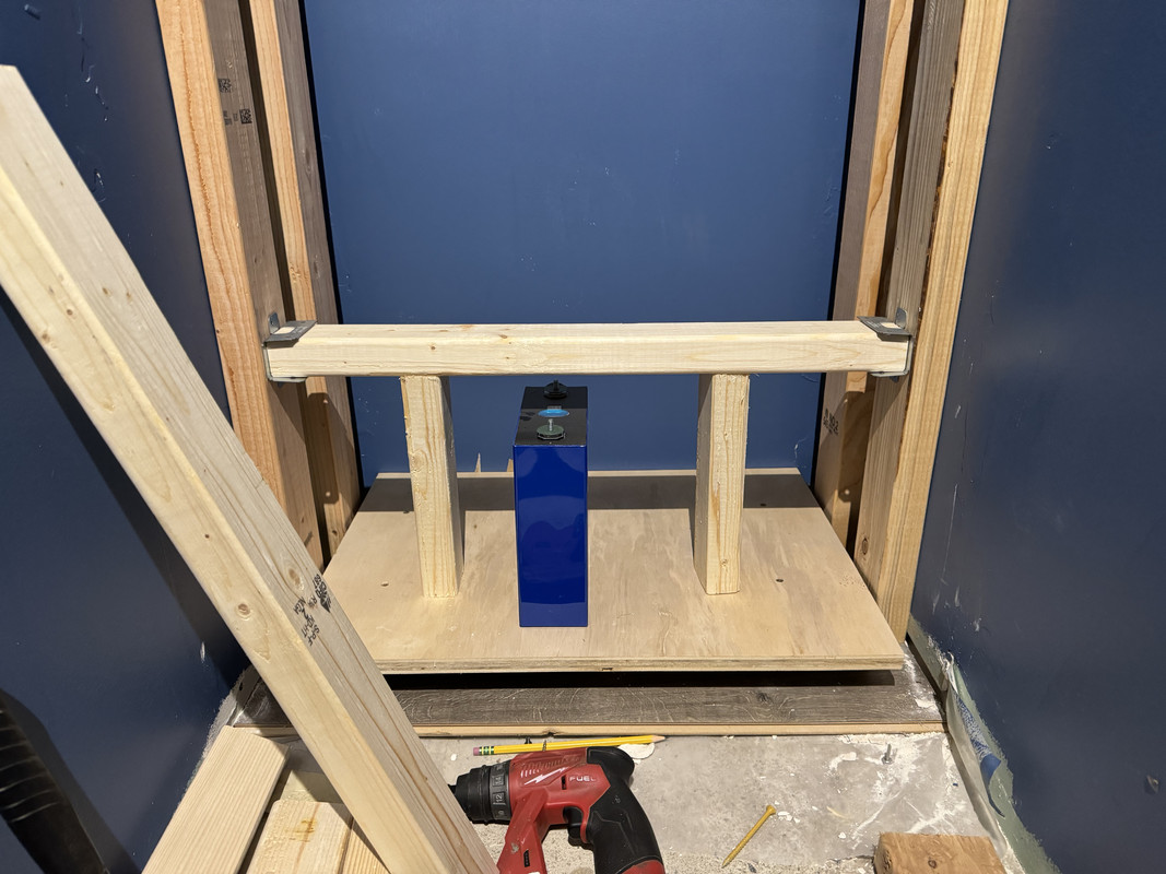

Getting slow progress on the battery shelf. I changed the design a few dozen times, but now I think I have something that will work, and give me 6 spaces for batteries, totaling 90kwh.
I have 10" of space for cells that are 8" tall, so that gives me a little space to deal with things.
