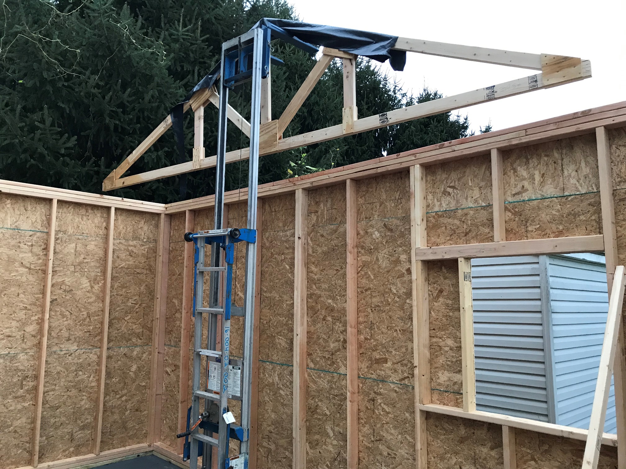

If you were a little closer I'd stop by to help and bring one of these along. Our sheet metal guys use them all the time. This is one of the smaller ones that I used when I built my shed:
That is one handy tool. Good friend had one, modified it with a 12vdc winch. He used it to build his house, then I used to build mine. Awesome especially when used in combination with my tractor pallet forks (mounted upside down for added height.
