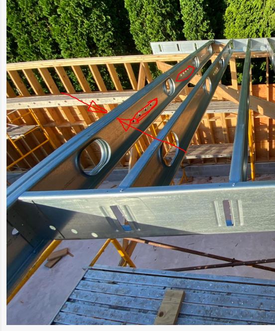

2 more installed. this time only me. If it wasn't for going back and forth so much between scaffolding and hte 95F heat, I could finish it all myself.

Are there some bolts that are going to tie these 2 together, so that the 2nd one will help the first one bear the weight of the opening edges?
I can't really see them if they are there.
They’re not all in yet but there is 3 every 4 feet of the self tapping screws.
I just did 2 more for a total of 4. Doable by one person but much easier with 2.

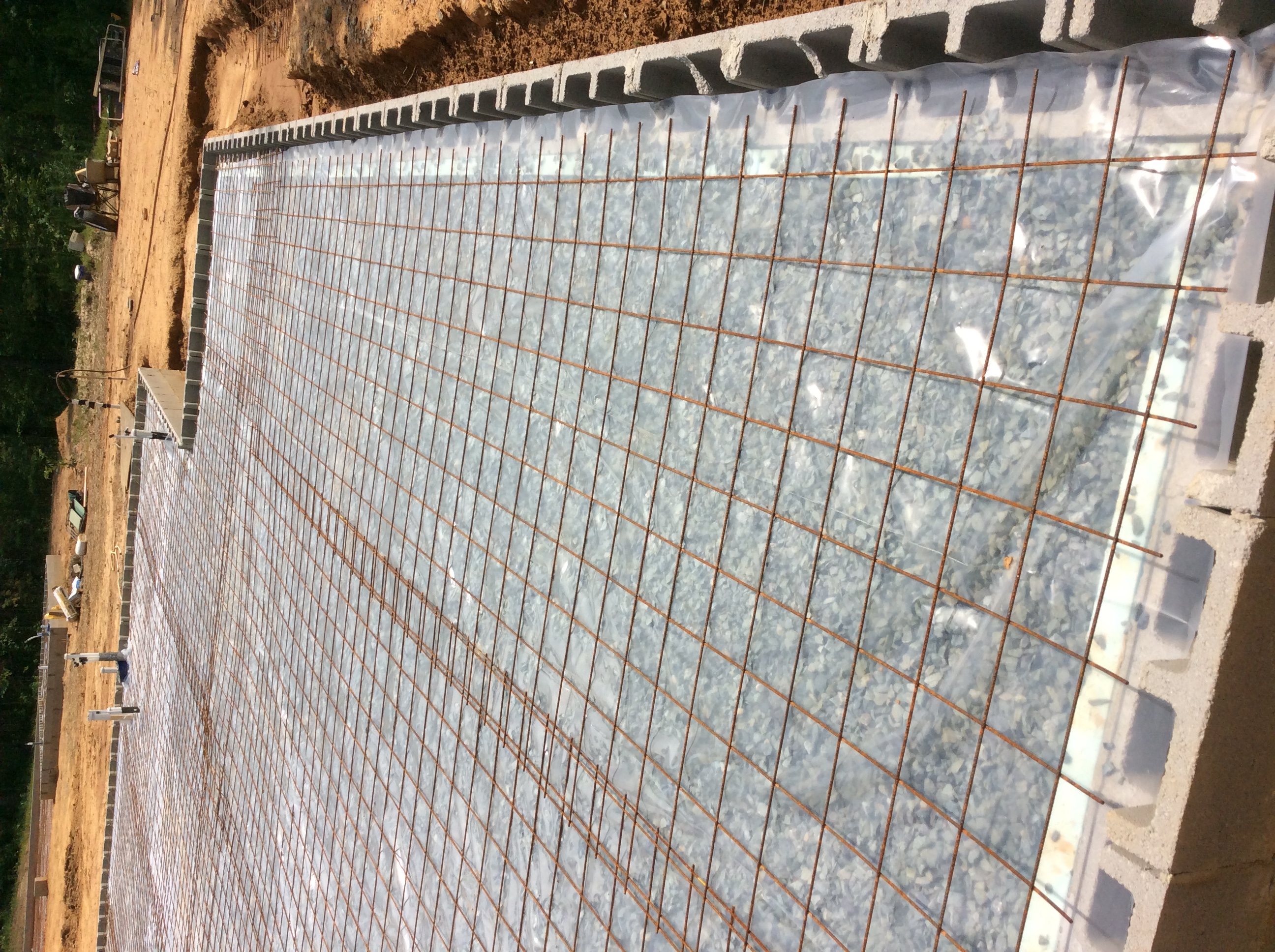

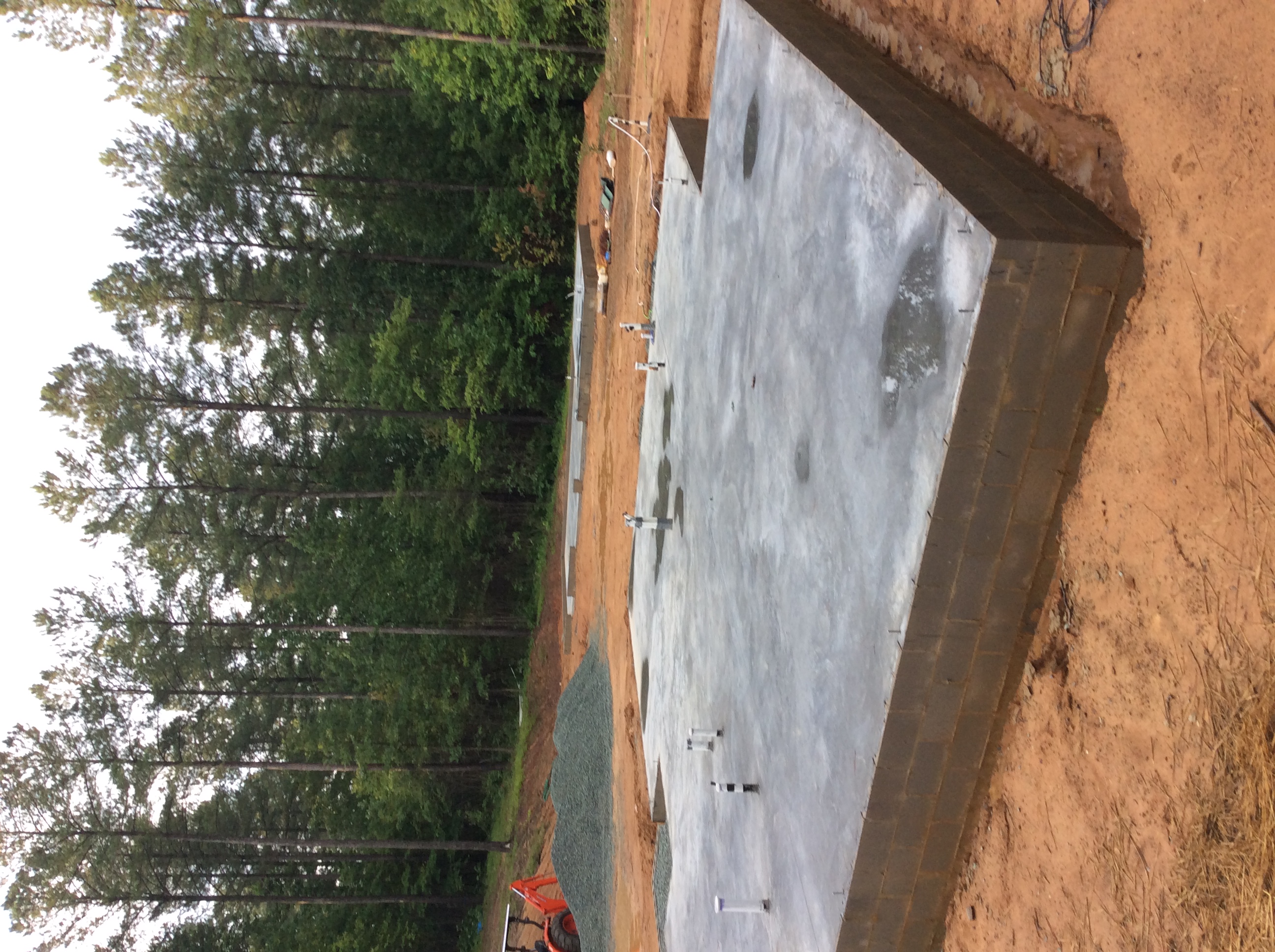

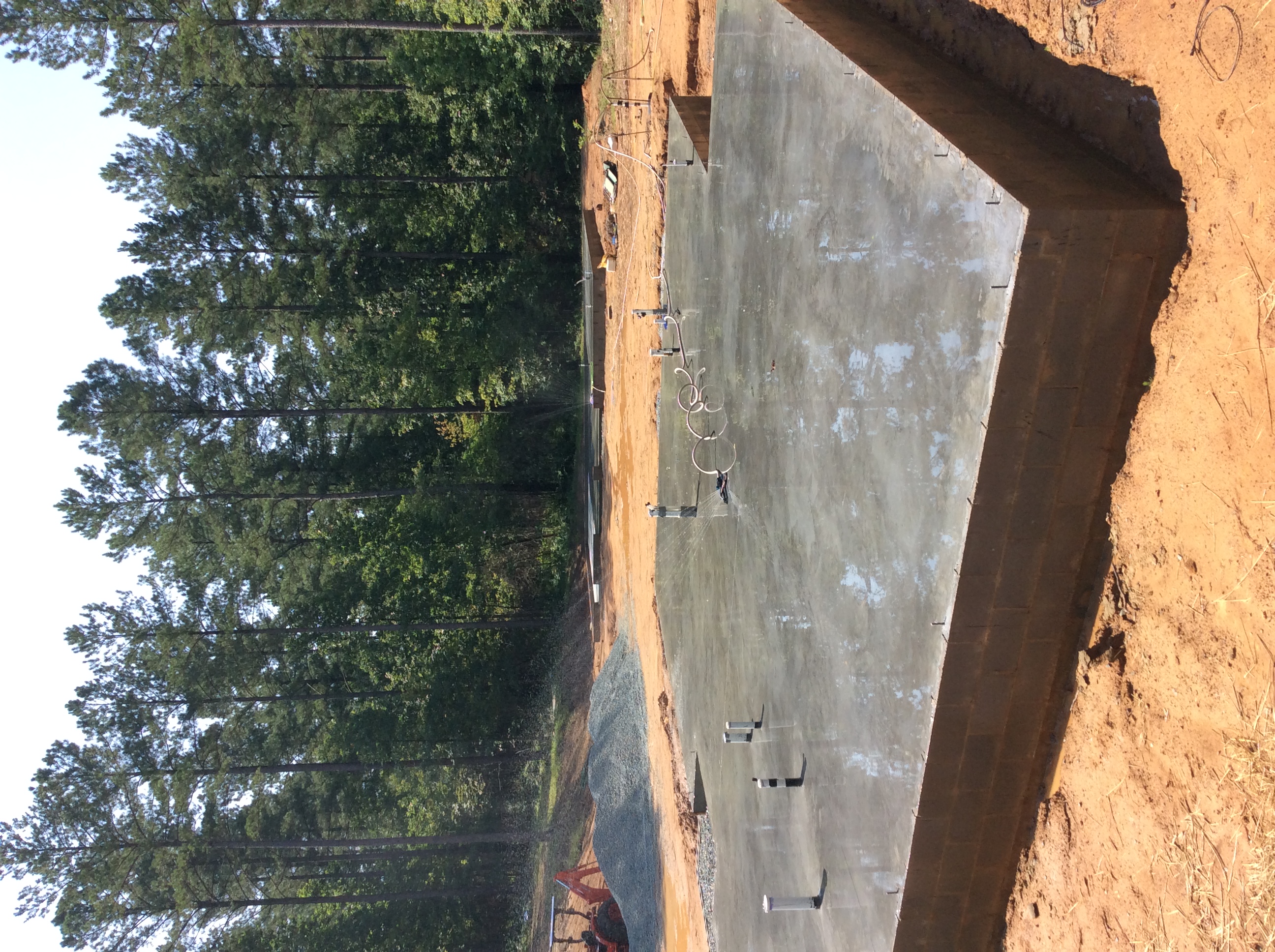

1EEFC8B1-84FE-4FE9-82DB-B60856D95492.jpeg93E56F14-1A99-4C71-8DDE-2EABF4A8032A.jpegCFE93DD0-BA98-4841-A5D2-34E3B52E3312.jpeg
I致e done a few parking slabs but, I知 no pro.
I知 GCing my house and garage but leaving the important stuff for the pros. I write checks and clean up cigarette butts and discarded water bottles, somebody痴 gotta do it right?
It cost a fortune but, oversized footings, rebar in footings, 4000 psi material with heavy wire in the pads. Been watering it for 2 days now! My guy said, by the foot, I may have the most expensive foundation in the county, and that was not a compliment. He thinks I got more money than brains. That ain稚 saying much!
It痴 such a pleasure to watch a big crew, 9 guys, all work together, like a machine.
They got here at 6:30am, 5 trucks later and they were gone by 3. Took me 1 year to get here anD took them 8 hours, max.
I can稚 wait, my house in Pinehurst sold so fast I知 forced to live on site, in a tin can leaky, smelly dumpster camper in a sea of orange mud. It could be worse, it can always get worse.
Should go faster now. Famous last words.
Keep that concrete wet as long as you can. I spent $100 at harbor freight for 3 additional hoses and a 4 way splitter.Too late for me but one guy suggested building little wall around the entire pour and flooding it for 7 days. I致e heard to soak burlap and keep it wet for 3/weeks....and eat your vegetables!
Question for the pro concrete guys out there.
I paid extra for 4000 psi concrete with retarder. If the web experts say, it doubles or triples the strength, are they saying my 4000 psi is going to 8000 psi or, are they saying if I don稚 do it I will only get 2000 psi, capsshe?
My buddies think I知 crazy out there moving hoses in the nasty orange mud in my skivies and a hat, that痴 it!
Good luck!
