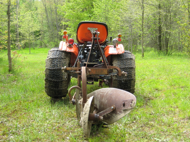

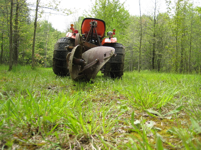

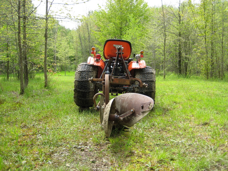

Ok, well I got back out there and hooked up the plow, I'll make my observations:
I parked the tractor on the wood blocks, I see the right lift bar needed dropped more. Looks to me that the plow would leave about 4" between furrows the way it is now, but I could remedy this by moving my tires in to the next hole in the axles.
There is also an adjustment on the plow frame itself where I can move the bar that the lower arms attach to over, I think 1/4" equals 1" plow movement. Problem is the threads are gone due to rust, so I would have to be creative w/shims or something to make that work.
Looking at the frame of the plow, using the front bottom wouldn't work in this case. The plow would pretty much be directly behind the tire, or maybe a few inches inboard. I'm guessing this whole alignment is caused by it being a 2 bottom, designed for a much wider and taller (and more powerful) tractor.

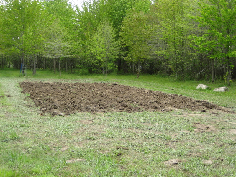

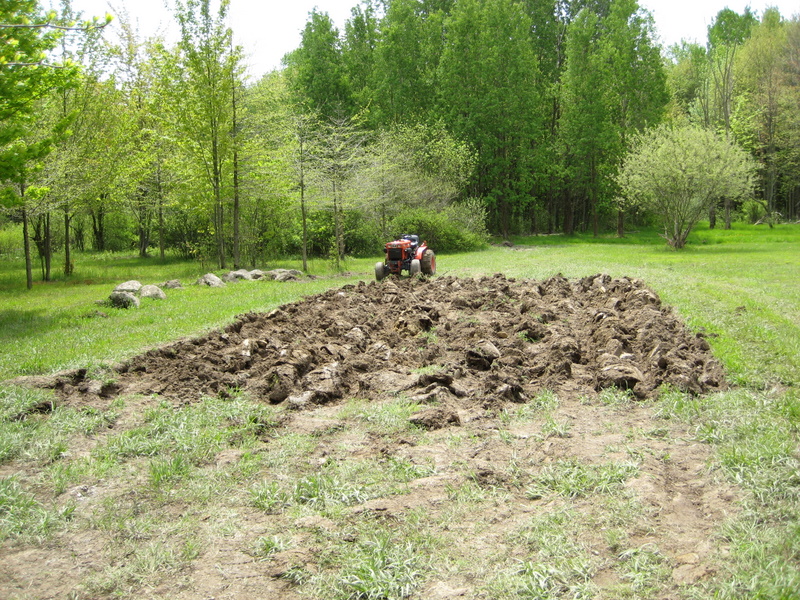

I'm sure this isn't textbook, but what I ended up doing is multiple passes, from opposite directions, only taking say 4" at a time. After a few passes, I think I managed to get the high and low spots leveled off, and it plowed more smoothly. I've attached photos from between a few of the passes, and the last one is where I believe it's ready for tilling.
Comments and suggestions are welcomed, and thanks for the help so far!

The bottom edge of the share should be flat on the ground when you have the tractor up on the block. The tail wheel should be at or just below the surface of the ground when the share is flat on the ground. By your pics it looks like you have your top link too short which will make the plow dive quick, and that will be more difficult to control. If you have both left wheels up on blocks the plow should be adjusted level. If you only have the rear wheel up, then that would explain why the plow looks raised in the rear. If your tractor has Draft setting, use that rather than Position setting. If it doesn't, you have to keep your hand on the control lever and manually adjust it as it dives and surfaces. But if you get it leveled front to back it won't be so bad. Bottom line is that you need to control the depth. I find the correct depth and return the lever to that location as I start each row. My newer tractor does not have draft control so I have to keep my hand on the control lever, but it's only to make minor adjustments as I go.

Thanks, that's exactly what I needed to hear. I think the problem I'm having with the top link is that this plow's frame is so high that I'm near the top of my 3pt's travel just hooking it up, so I shorten the top link to help it clear the ground while transporting. What I need to do in this case is to lengthen the top link every time I start a row to help the plow from diving in like it's doing. I was afraid of that, but your explanation cleared up all doubt.

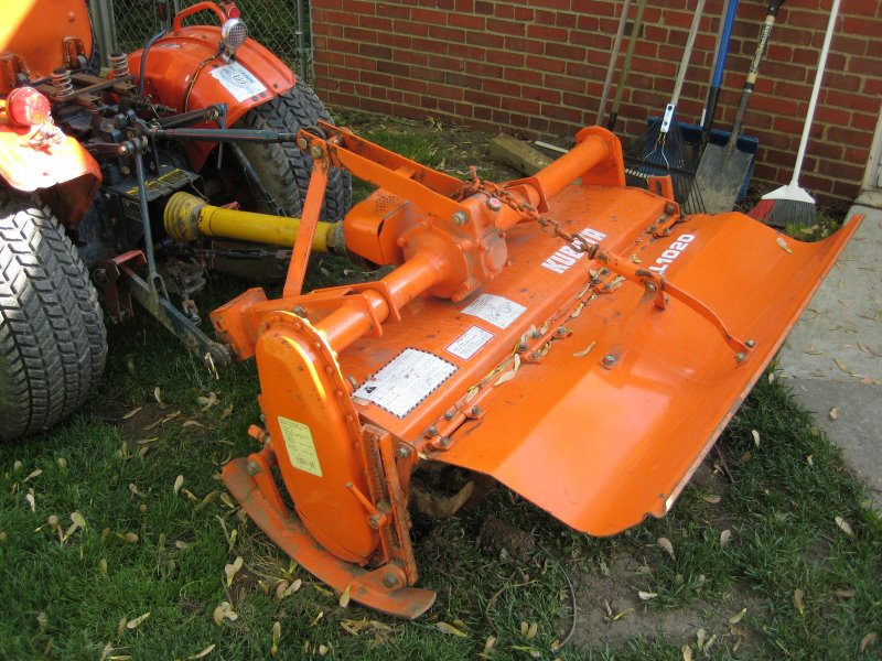

Well, funny you should say that, because I got really lucky yesterday and picked up a rototiller! It's a Kubota FL1020, 42" I believe but I haven't measured it yet. The guy even gave me 3 suitcase weights. He threw a rod on his B7100 last year, sold the tractor but still had a few things for it.
I've been beaten up from a front tine tiller, borrowed a 9hp troybilt which was much nicer, but still heavy, hoping to be grinning from ear to ear while operating this one!:D
