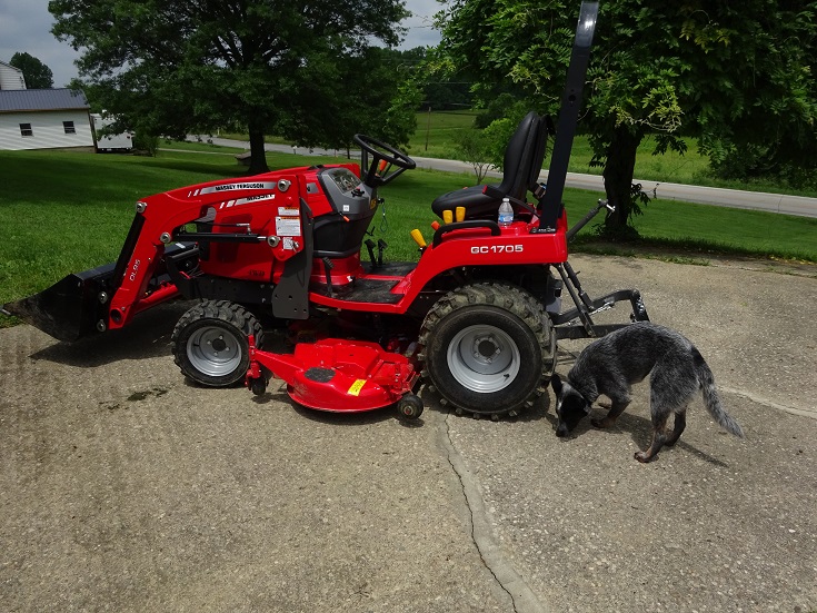

Did some more thinking about that deflector chute while mowing today. I'm going to flip the hinges, that will allow it to open fully, and be up out of the way. I'm also going to add a spring assist to it, a coil twist style over a shaft. May not get to it until winter, so for now I'm going to shim the bump stops to keep it open a bit more. One of my problems with it is the grass coming out sort of windrows, instead of spreading out.
If I could get the chute to flip up to vertical, it would solve my problem, but the hinge is welded to the chute and the hinges are what stops it from going vertical.

I'm just curious as to the desired outcome regarding the mower chute.
Its wide, long, and solid - which is normally an advantage for durability and grass flow. But it gets in your way for width as well as trailering or storage space too. I get all that. However if the emphasis was on getting the chute off or tipped up all the way - then you have a rather dangerous rock or stick "thrower" to harm kids or animals or house siding or windows - and because the tip speed and power of these units is considerable - the propelling power is much higher than a normal lawn mower as well.
So what is the ultimate answer - as it seems to me that neither of the above 2 choices is the answer. So why not look for a rubber chute to replace the metal chute - possibly in a parts department for cub cadet or john deere lawn mowers etc.. The rubber chute could be shorter (or shortened) and could be "deflectable" where as the Massey chute is far to strong to be considered "deflectable". Would that solve your width issue but still offer protection from flying debris - and not reduce the grass flow to exhaust evenly and out.
Just a suggestion.
