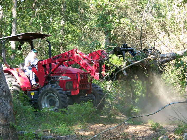

How about some action shots of you using the new grapple. Here is a photo of my action shot.6-2-12 Grapple First Time in Action.jpg

How about some action shots of you using the new grapple. Here is a photo of my action shot.View attachment 502865

Post #110 is the most action I have until i get down to our property in Gonzales, I'll be putting it to heavy use down there.
:laughing::laughing::laughing: That looks like a still portrait to me.:2cents: Anytime you want, you can come up to Willis for some action shots.:thumbsup: I bet your chompin' at the bit to get it down to Gonzales!:licking:
