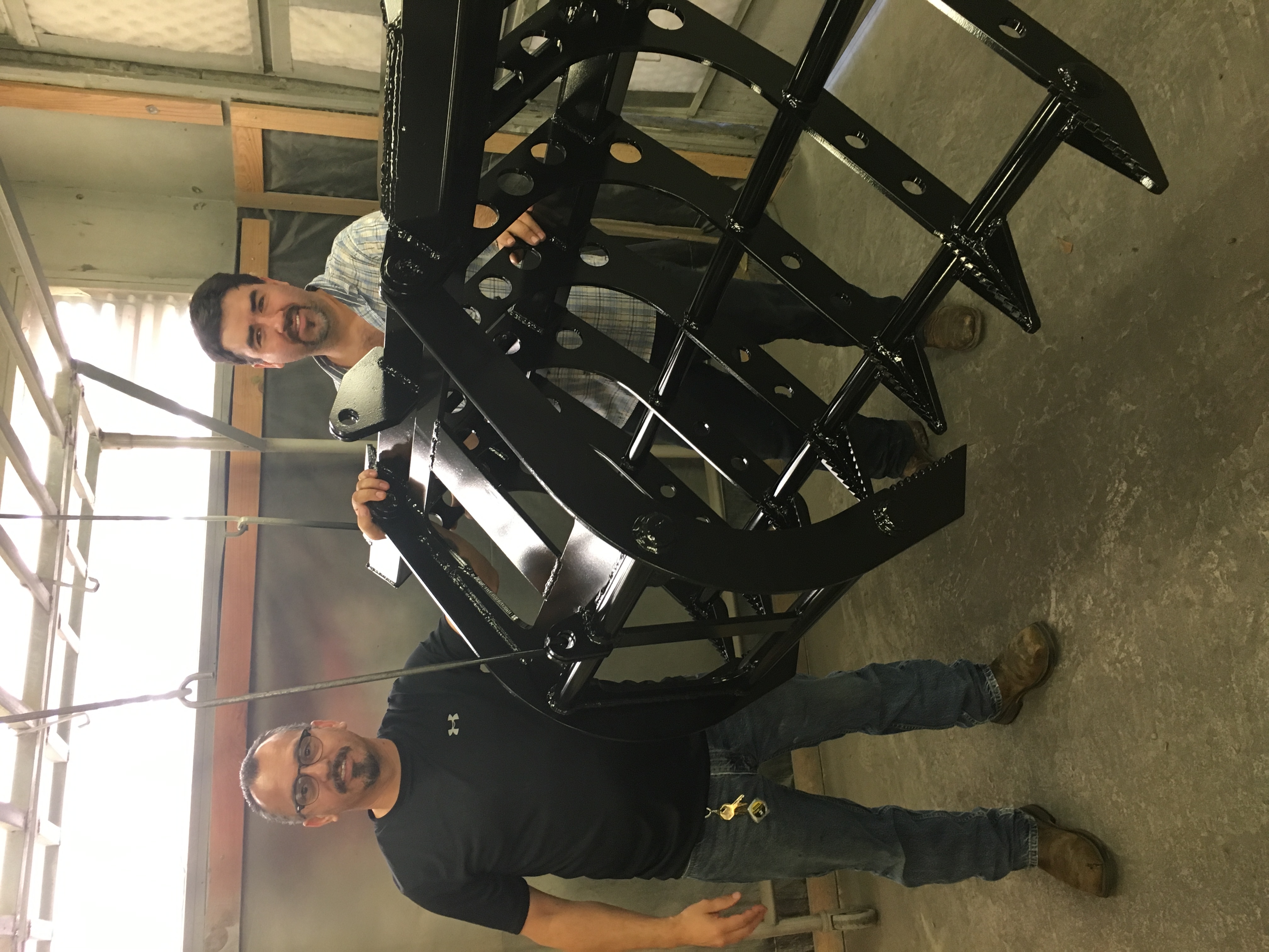

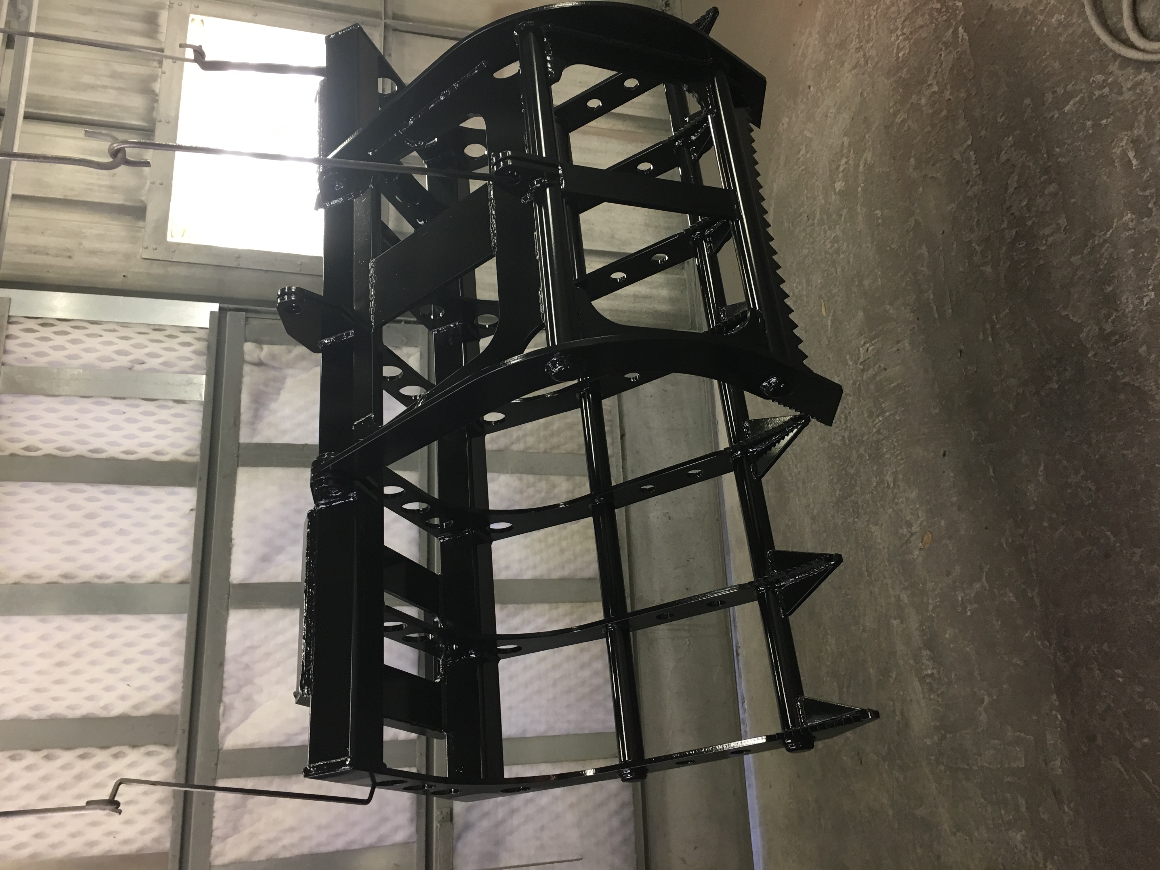

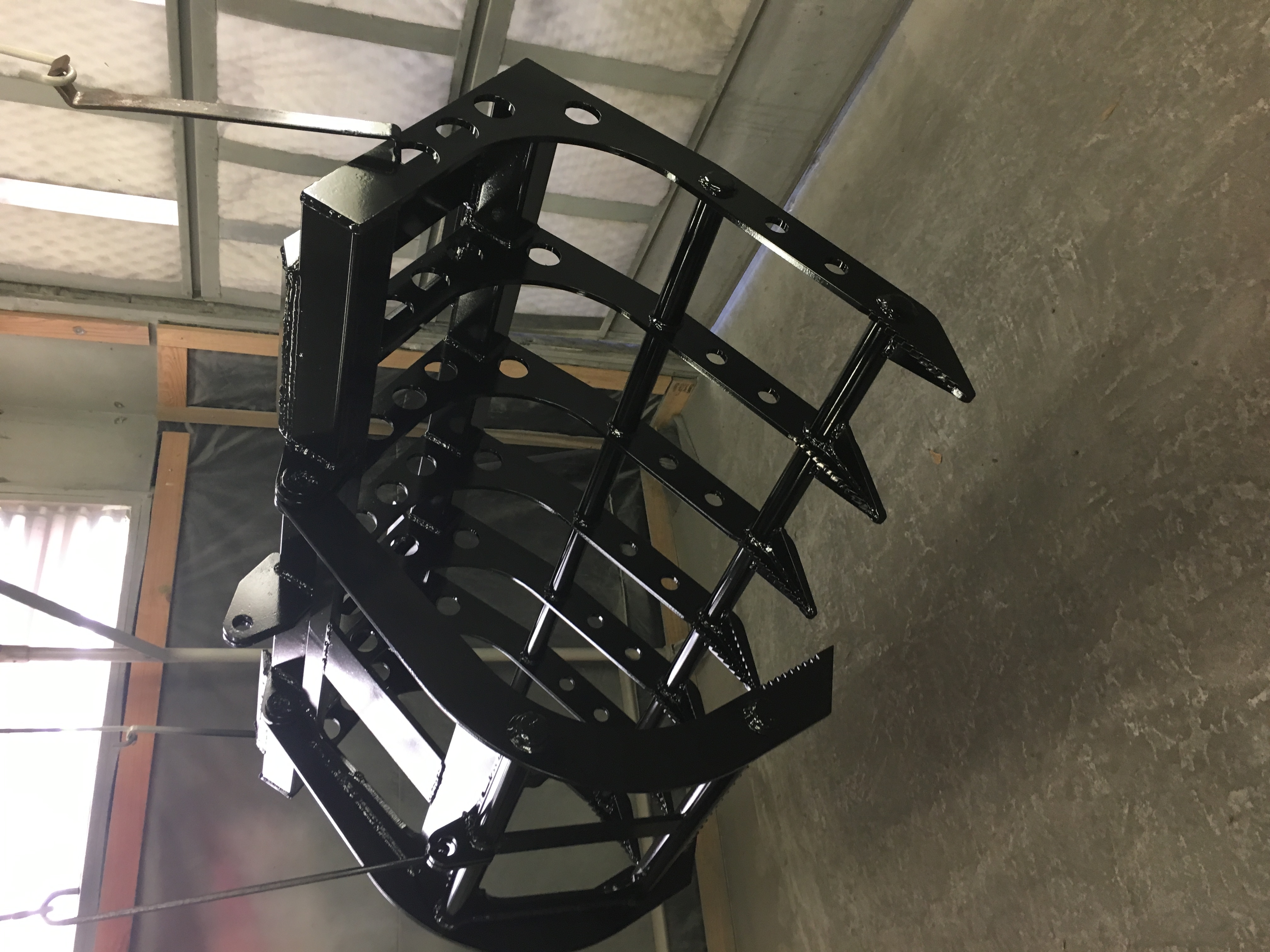

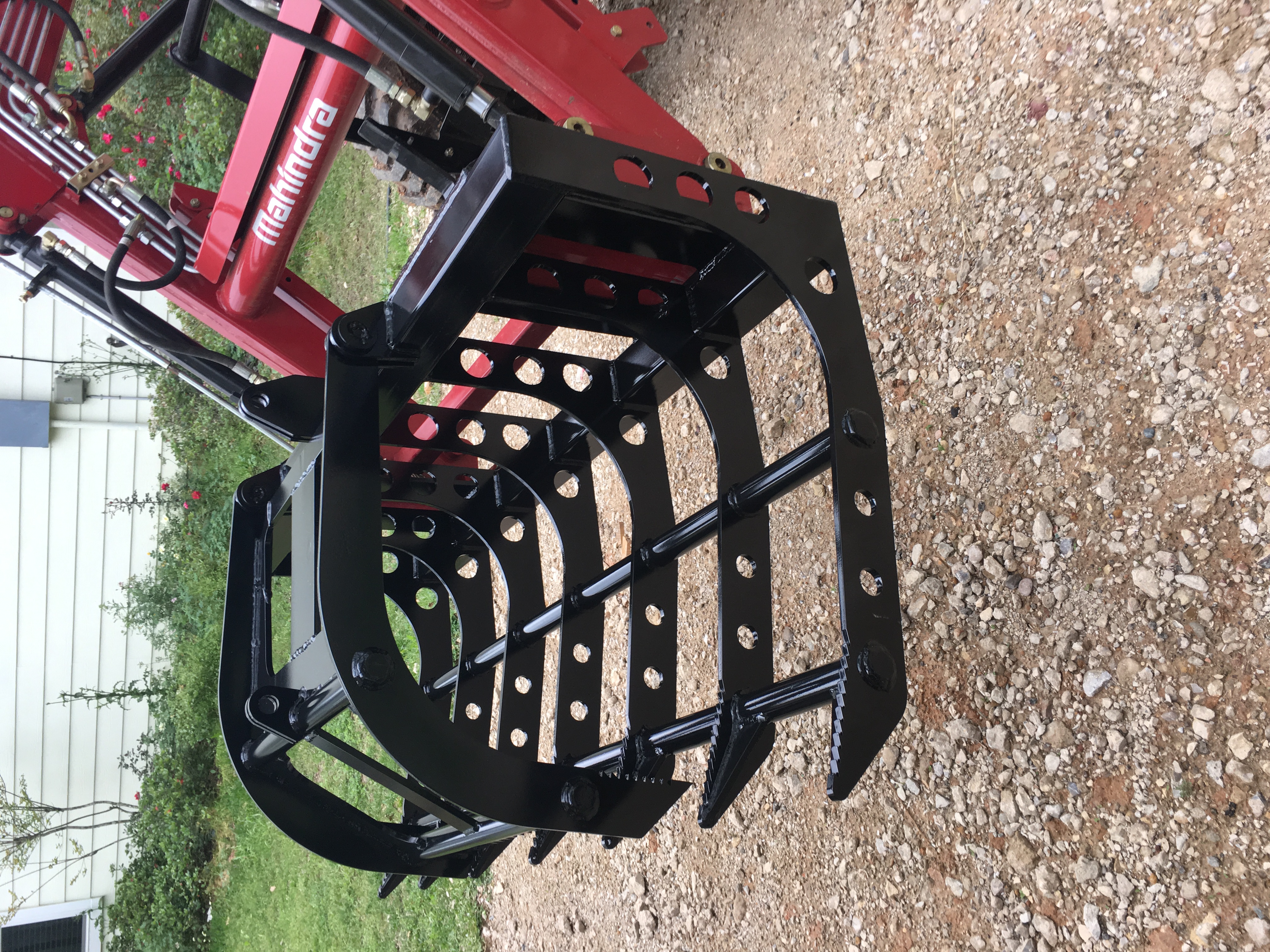

Got the Grapple all painted up and ready to install!
There's my guys there - they help get it all assembled and painted!
Way to go Mario and Esteban!

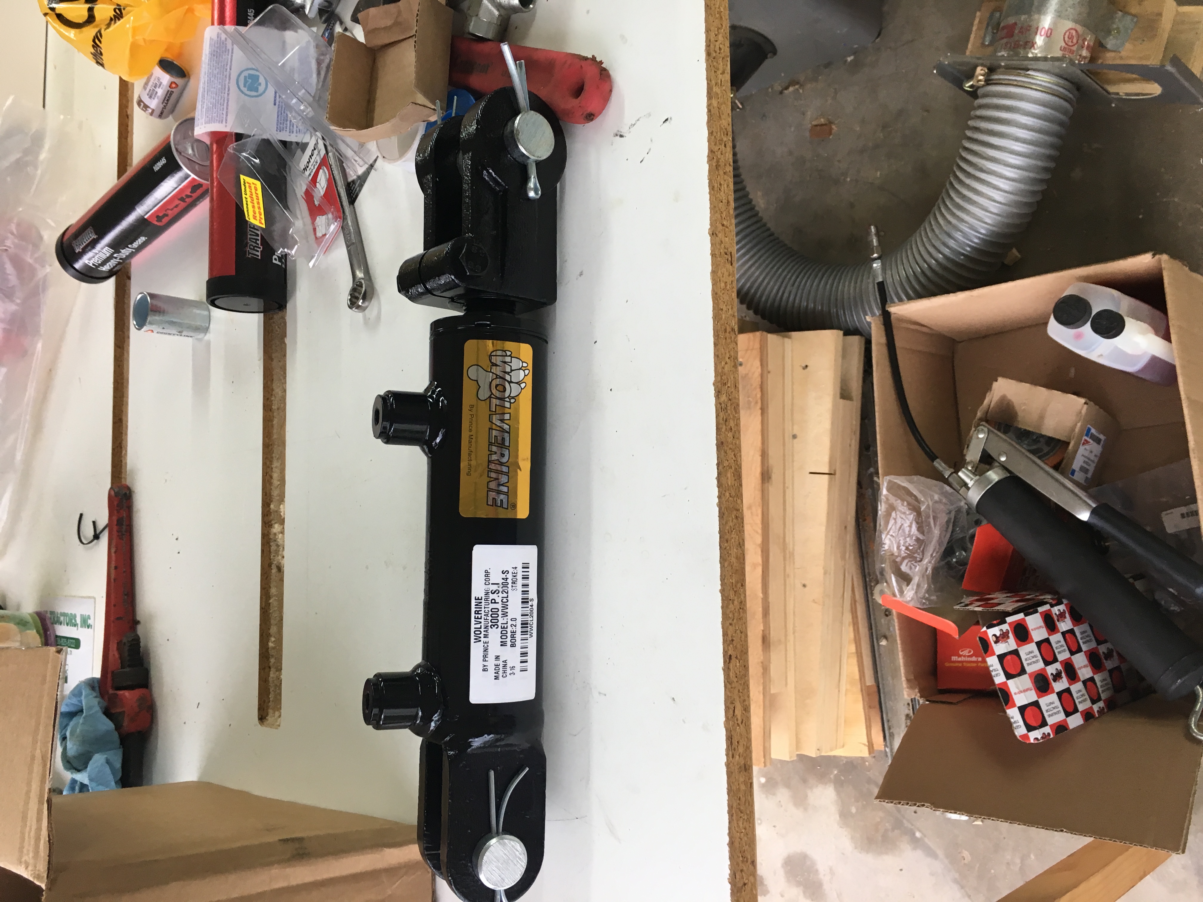

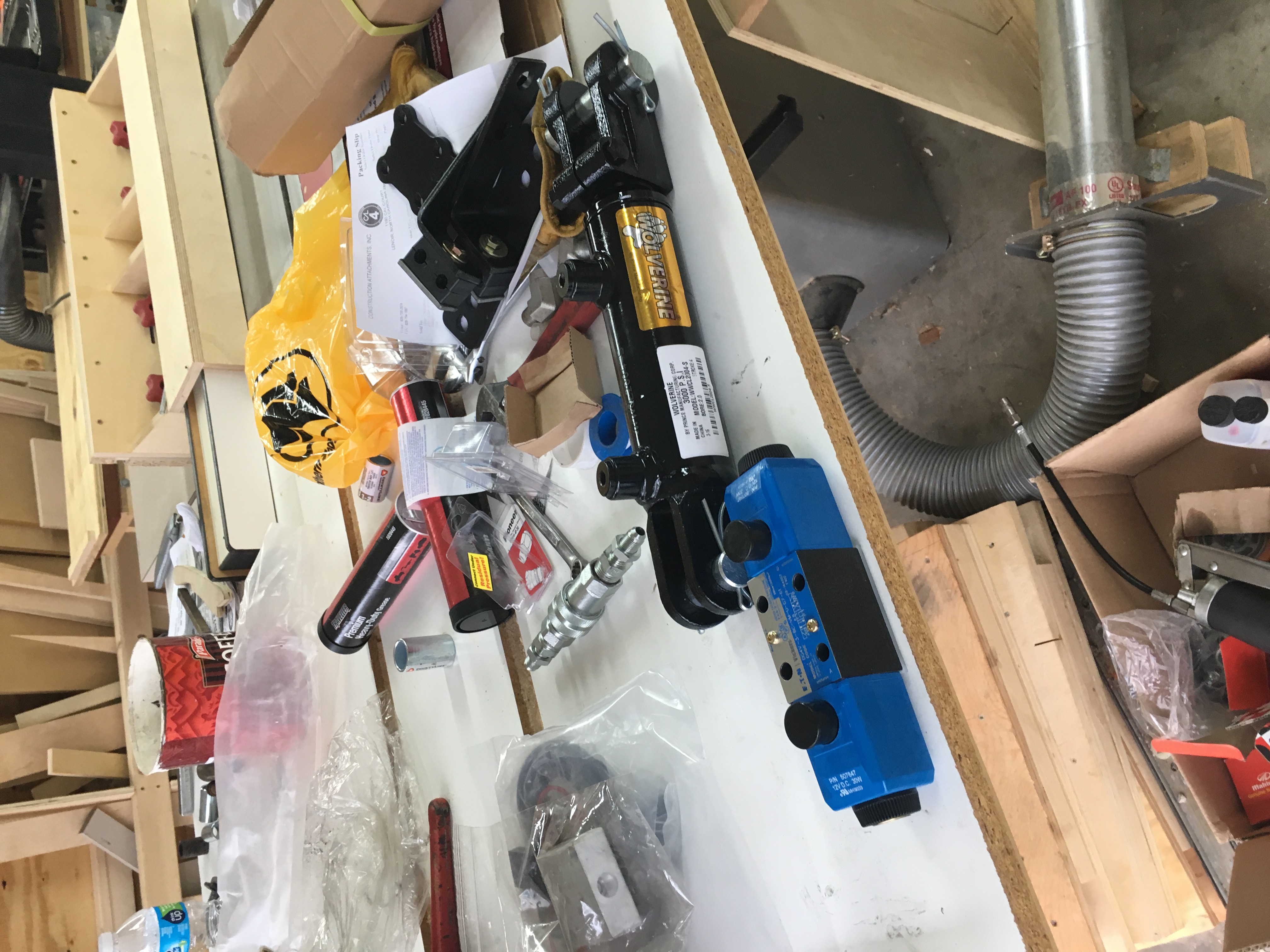

Also got my cylinder and 3rd function in today.
Got the lines all measured up and hoses and fittings ordered.
It'll be a week or so before the rest of my parts get in, I post some more along the way and of course a video once it's hooked up and running!

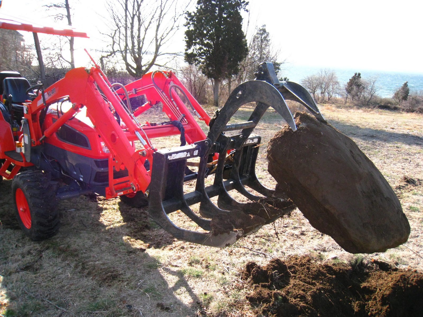

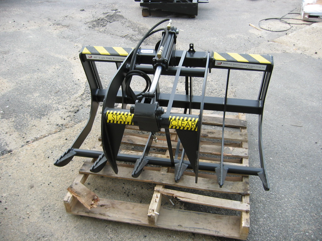

Very nice work. The bottom looks great. I'm gonna suggest that you consider a bit more bracing on the jaw. What you have will work perfectly for moving logs but if you are using the upper jaw to help rip out brush I think I'd add more steel. Take a look at the upper jaw of the EA Compact grapple. They have the best upper jaw in the industry IMO. My own grapple doesn't have much either but I had to heat/beat/weld in some gussets on the tips that splayed out when clamping on big rocks. I've also lost a hose right at the cylinder due to lack of protection from below (yours is fine). I also wonder if your cross tubing is big enough to withstand the twisting forces that are inevitable when you clamp on an odd shaped object like a rock. Mine has thicker tubing and it is still a bit bent after ten years....nothing that affects function but evidence that more bracing would have been better. Here is a photo of mine for reference (photo when new, it's more battle scarred now) and the rock that splayed out the tips.
I have been wondering about how the clam will hold up.
It's on new so we will see, I will make a new lid if it doesn't hold up well.
Thanks

The lid basically looks fine it just seems a bit lightly built. Wouldn't take much to beef it up. Another cross tube would help. Also make sure the tips are supported/gusseted.
