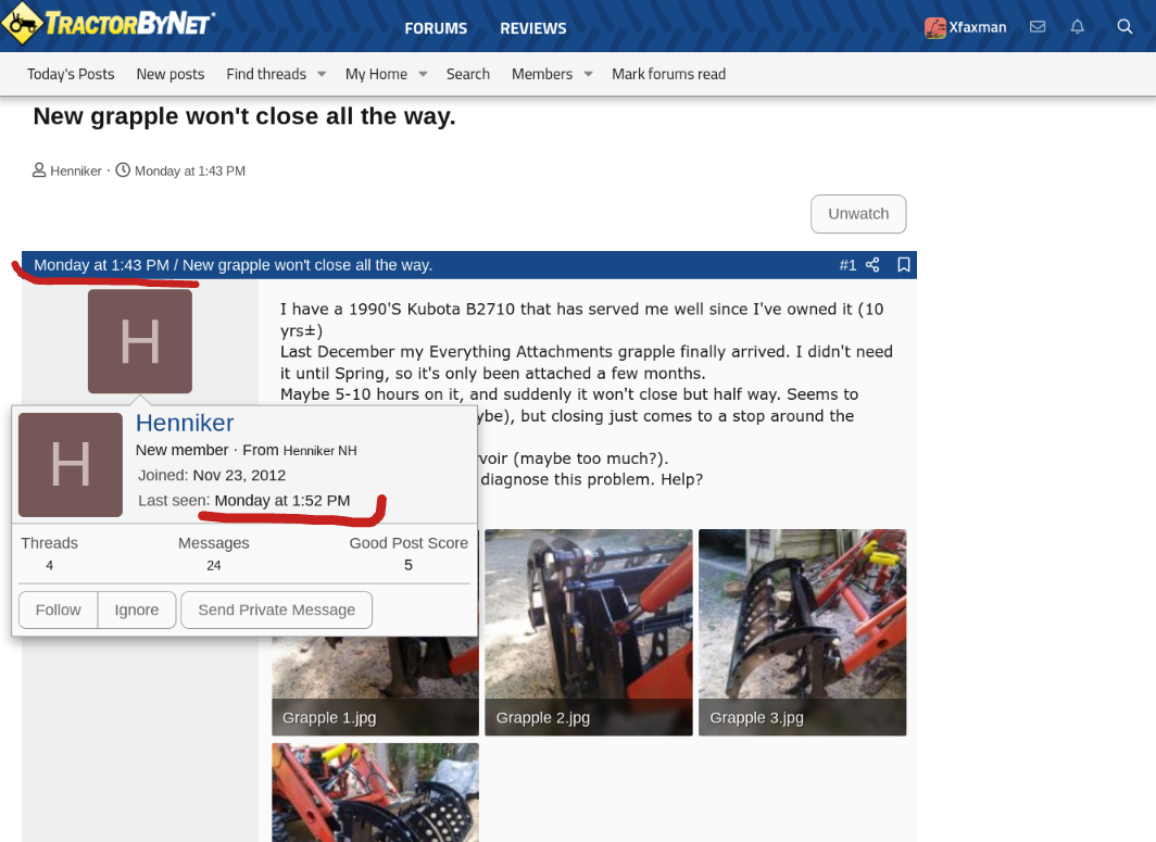

I have a 1990'S Kubota B2710 that has served me well since I've owned it (10 yrs±)
Last December my Everything Attachments grapple finally arrived. I didn't need it until Spring, so it's only been attached a few months.
Maybe 5-10 hours on it, and suddenly it won't close but half way. -------------
I don't even know how to diagnose this problem. Help?

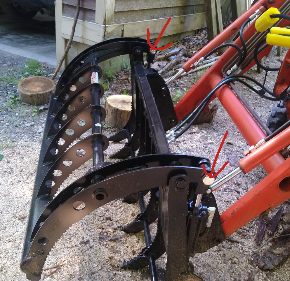

Remove these bolts/pins.
The lid should close.
Operate the lid cylinders, see if they both extend all the way.
   / New grapple won't close all the way. #14
^ Right. By disconnecting the cylinders, you can independently check if it’s a cylinder not extending, or if the grapple can open and close without them without binding somewhere

OMG! Sometimes the simplest solutions confound me...
Sure enough; one of the hose connections had come loose. Plugged it back in tight, and all works great.
SO relieved! THANK YOU ALL for the great suggestions and help!! You've averted me from going into a high-speed wobble....
