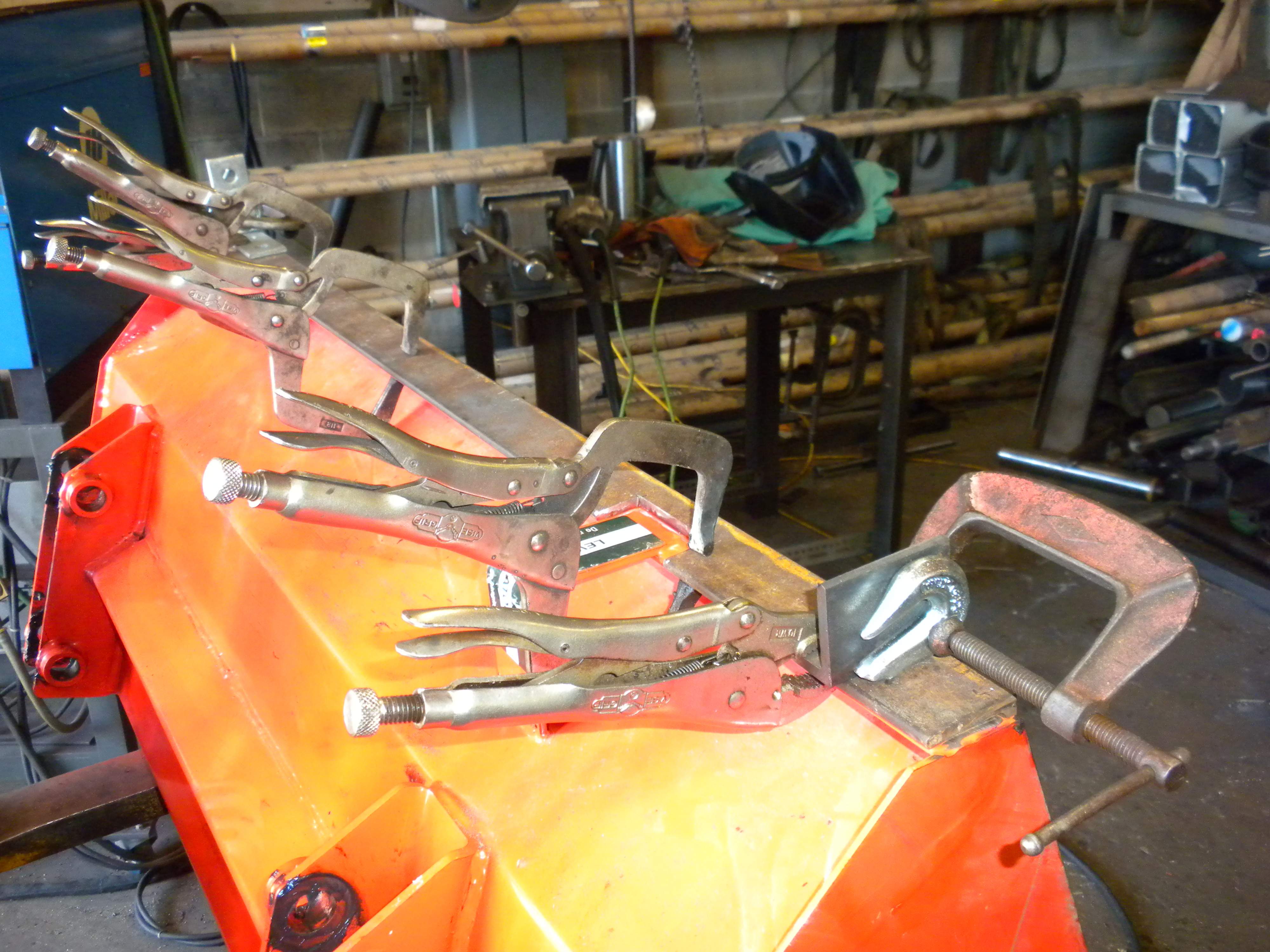

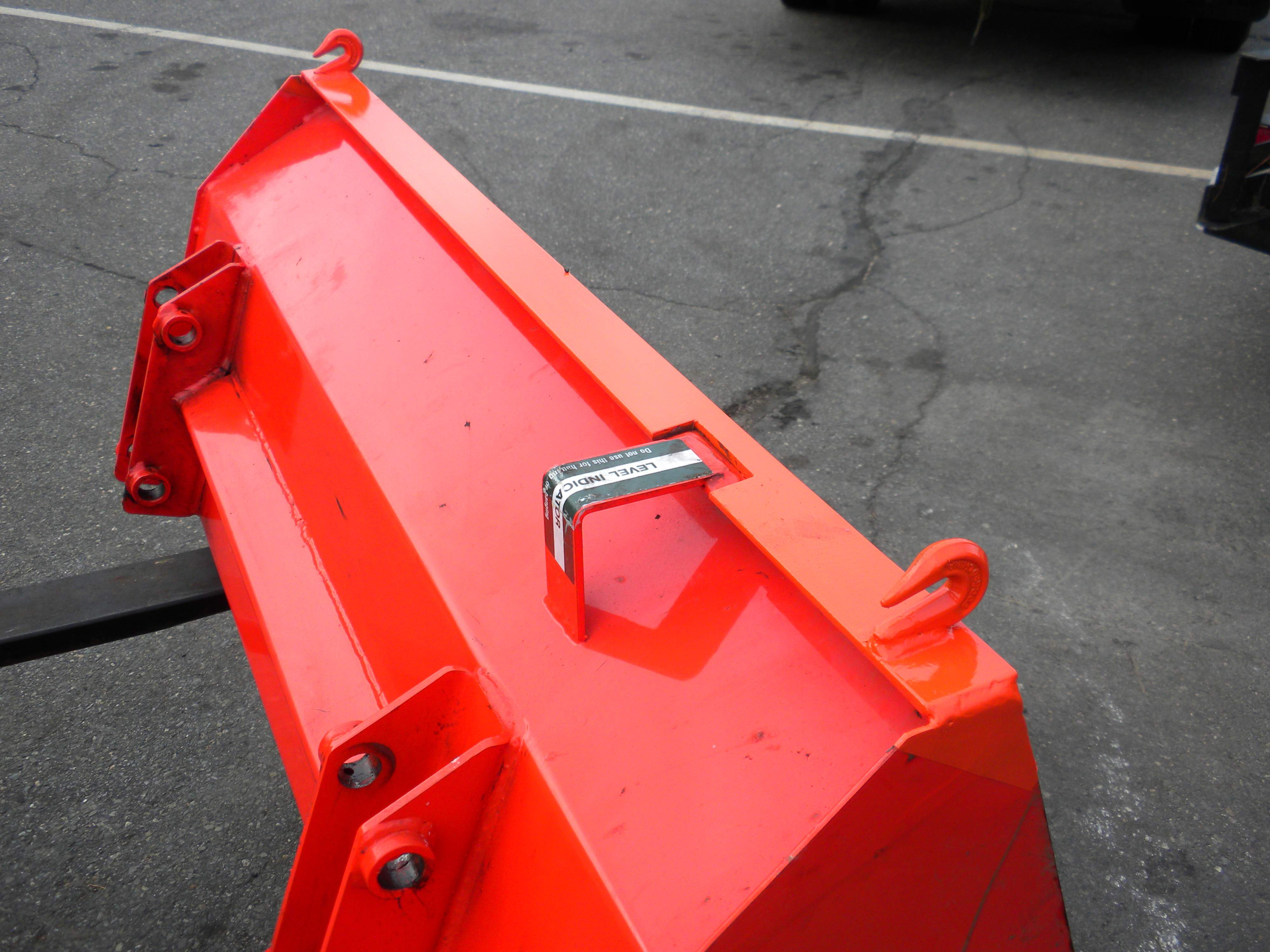

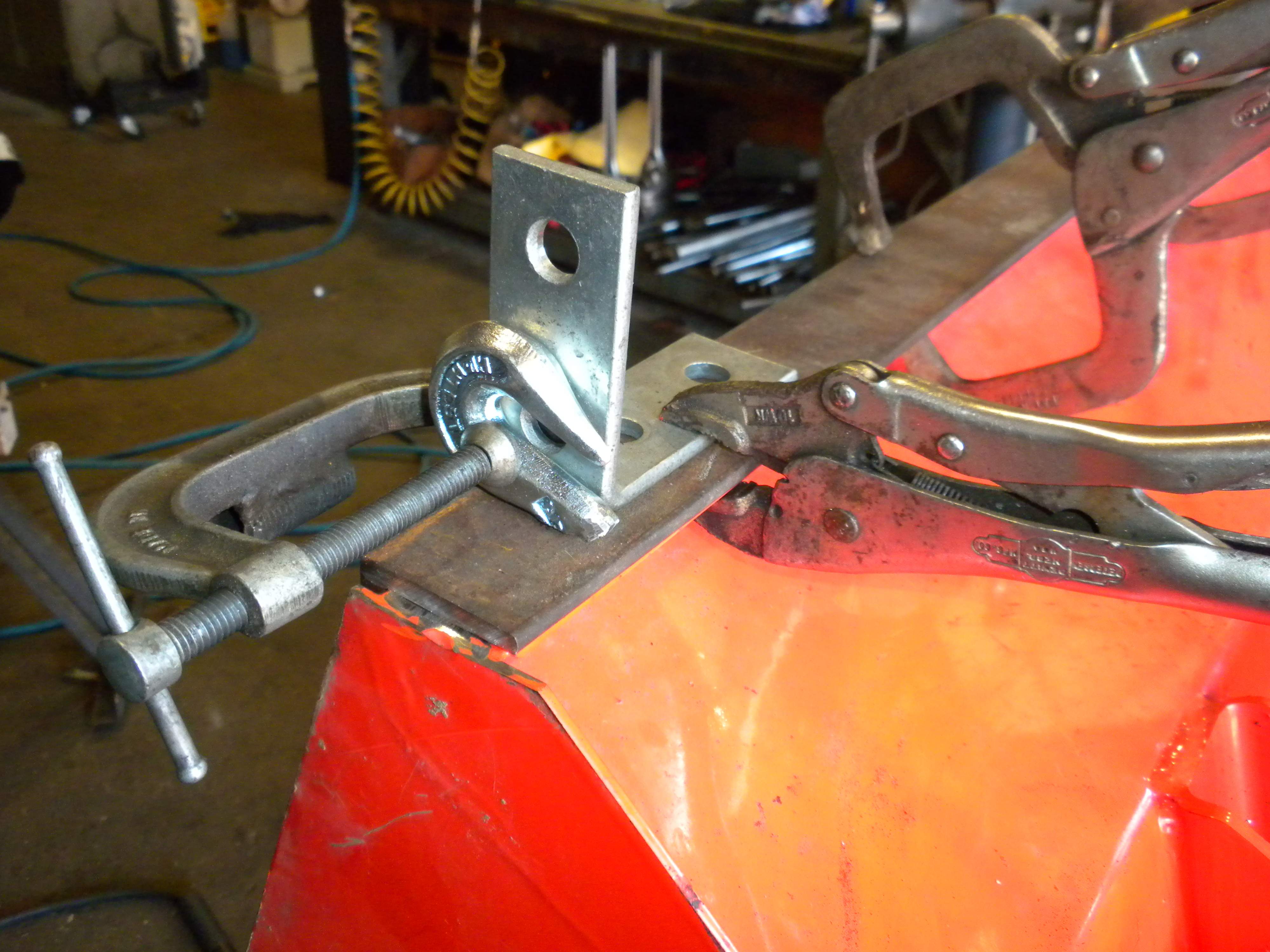

Here's a few pics of my hooks......

wdchyd did a nice job on his bucket hooks but it is a bit advanced for a first timer. Also, reinforcing the bucket to support the hooks is a great idea.
Another option is to weld a pipe under the top lip of the bucket to keep it from collapsing when lifting heavy objects with a chain. 1/2" pipe fit the BX bucket lip perfectly.
In my case, the hooks are welded to a 4"x3" plate and then the plate is welded to an already reinforced part of the bucket.
Do a seach of TBN for bucket hooks or grab hooks and you will come up with an unreadable number of posts - many with pictures.
One comment on hook placement. Don't try to lift from the edge of the bucket or things will get way too tippy way too soon. It also can tweak the FEL if not careful.
Here is a place to get weld-on chain grab hooks. They don't need modification like wdchyd had to do on his. Never had a failure with these.
