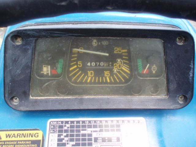

Here's the part that I'm curious about, step #2. engage PTO at 550. My RPM gage show's an RPM position for 540 and 1000:
Do you mean to get the RPM up to the 540 spot and then slowly engage the PTO? Step #3 has the RPM down low and #5 says to bring the RPM up. :confused: Is step 2 a parenthetical comment or is there something you are doing there?
Sorry if that's a goofy question, but I'd rather look silly here than to be getting stitches because I didn't ask the question. :D By the way, a pocket full of sheer bolts is now standard when I mow.
First, I think that 540 RPM is the standard PTO speed, never 550 RPM.
I think he means that you want to lower your revs down to a fast idle and engage the pto slowly as you said you do.
Then, once the cutter is spinning happilly, crank the revs up to 540 RPM on the tacho.
I think you are doing it right allready.
The difference with what Rob said is that his tractor has a lever that engages the pto. But you then have to let out the clutch for it to start up.
   / New guy here...Some brushhog questions #16
Just to make sure everyone is clear on this, the speeds noted for pto on your tachometer are for the engine rpm to make the pto spin at that particular speed. Or in other words, the speed the engine has to turn in order for the pto to be turning the rated speed.(540/1000, etc)
Those are NOT engagement speeds and are subject to tear something up if your not extremely lucky. Engage the pto at the slowest possible speed, lowest possible load, and increase speed/load after it is engaged.

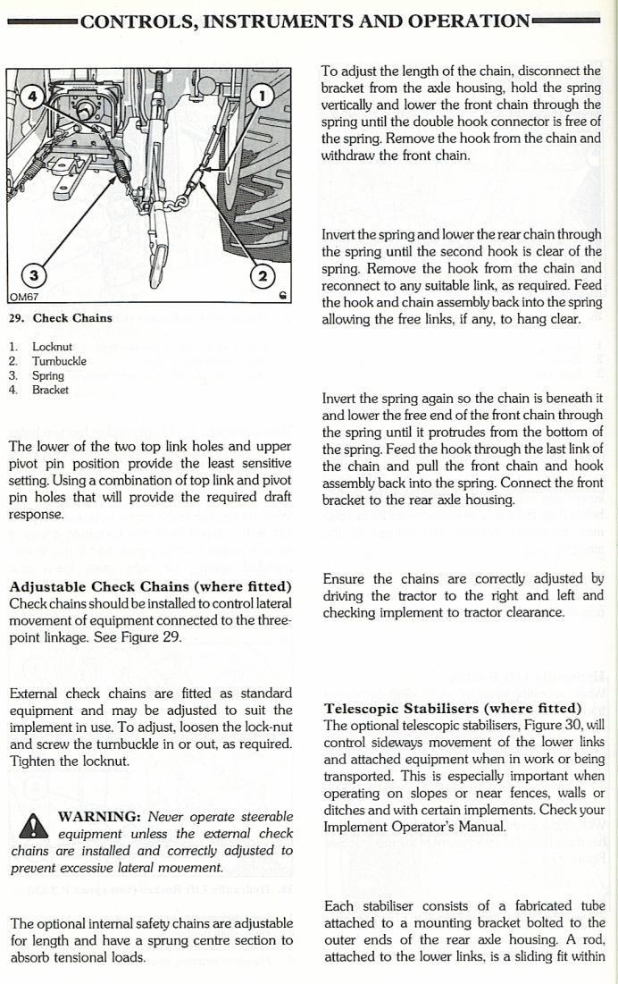

As for my other problem, I have still not conquered it yet. This weekend I'll get under there and see if I can reverse the arms or if there is a pin I can set to keep the arms still. However, it seems like you would not want them to be entirely still, and I only have about 3" of clearance right now on both arms before they hit the tire?
If I can't figure it out, I'll take a picture and post it here, so you guys can see exactly what I'm talking about.

ericinok said:
... see if I can reverse the arms or if there is a pin I can set to keep the arms still. However, it seems like you would not want them to be entirely still...
Yep, you have to be careful there. I realize we likely have very different systems (Blue Vs. Orange), but... do you have telescopic stabilizers? Does your attach point have upper and lower holes? On my tractor you can let the stabilizers allow some sway, and attach the stabilizers to the upper holes and this will limit the sway, or you can use a solid position and eliminate the sway but you have to use the lower positions, there are cautions with either way... you know what... I'll just scan that page from my manual. It will do a better job with pics than I can do with words. Maybe one of you Orange guys could do that to hold ericinok over until he get's his manual. :)

I appreciate the help, Spiveyman. Our set-ups look pretty much the same, so I'll pretend I have a Ford until I get my manual.
Is my monitor blurry, or does your dashboard show 4000 hours? Wow, that's what I call getting your money's worth out of a machine. I was feeling bad about putting 10 hours on mine already, kicking it up to 613 hours.
