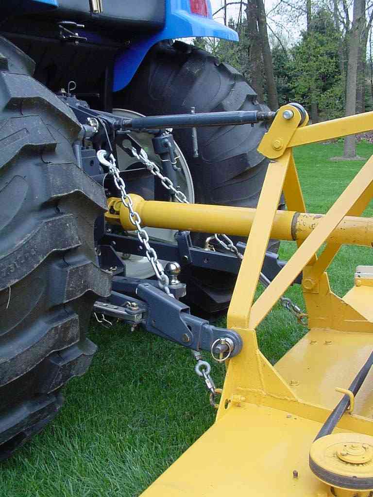

I would try using check chains. Not those shown in the pics from the manuals but like these shown in the attached file. These allow you to leave the tractor alone and simply lower the lower arms all the way down.
Although the picture shows the chains on my rear mower deck, I have the exact same setup on my brush hog. The chains will keep the deck at a constant height as well as minimizing any side-to-side motion.

Djradz:
I used check chains religiously on my old Ford, I have tham for my NH, but did not use them last year :(. They do take strain off the 3PH hydraulics and do keep the rotary cutter deck at a constant height. I use my lower link arms to minimize side sway, but the check chains provide additional support. Jay
