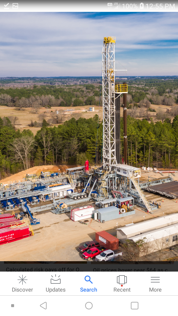

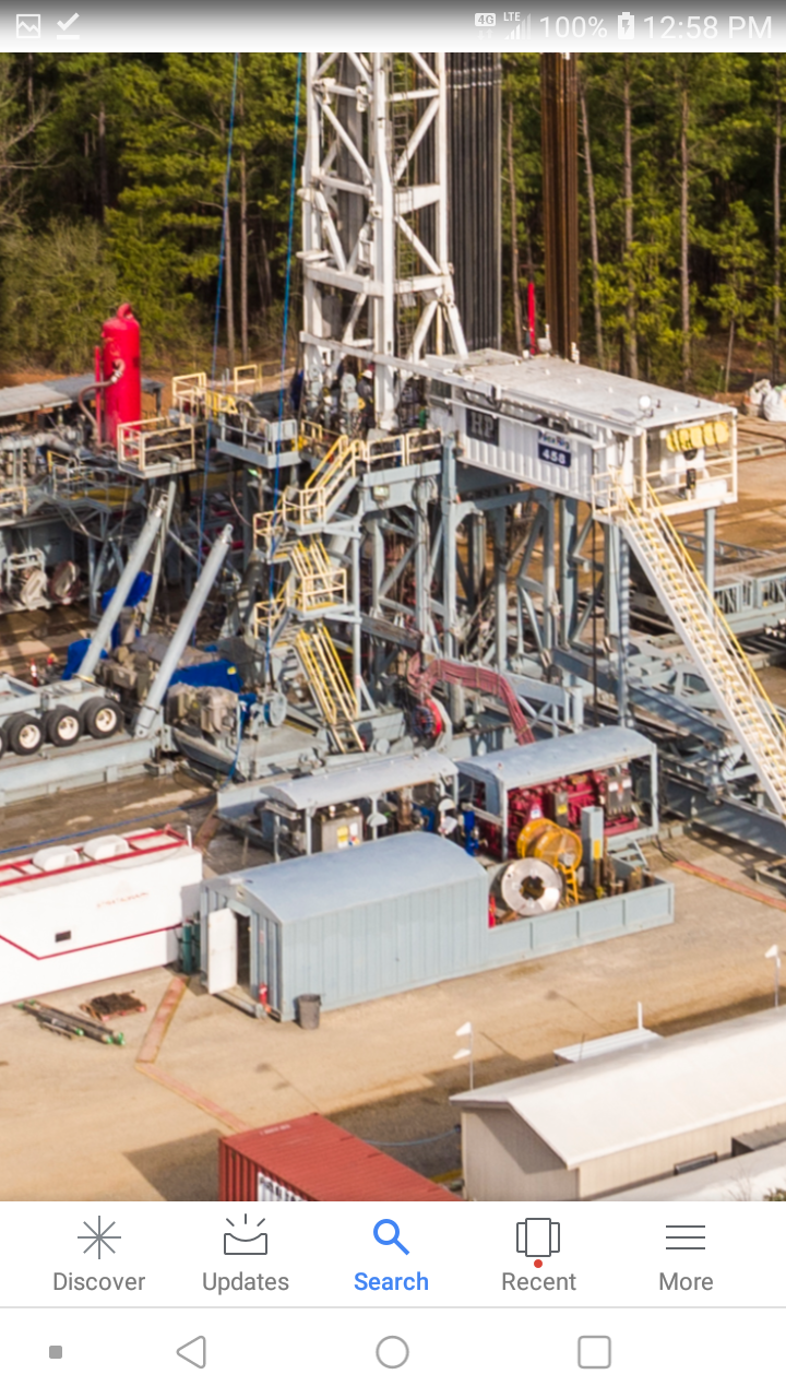

I worked at a drilling rig factory. Ended up being the lead over the sub structures. 40 million dollar rigs and we turned one out each week. Flex4S+ for H&P International Drillers. I didn't have to do much welding but I had to stay on top of the welders. My job was to put everything together. I had to mark what and how much weld and make sure they did right. It was all 100% seal welded. I built derricks for a while when we were ahead on sub structures. I worked 7 12 for a couple years.
