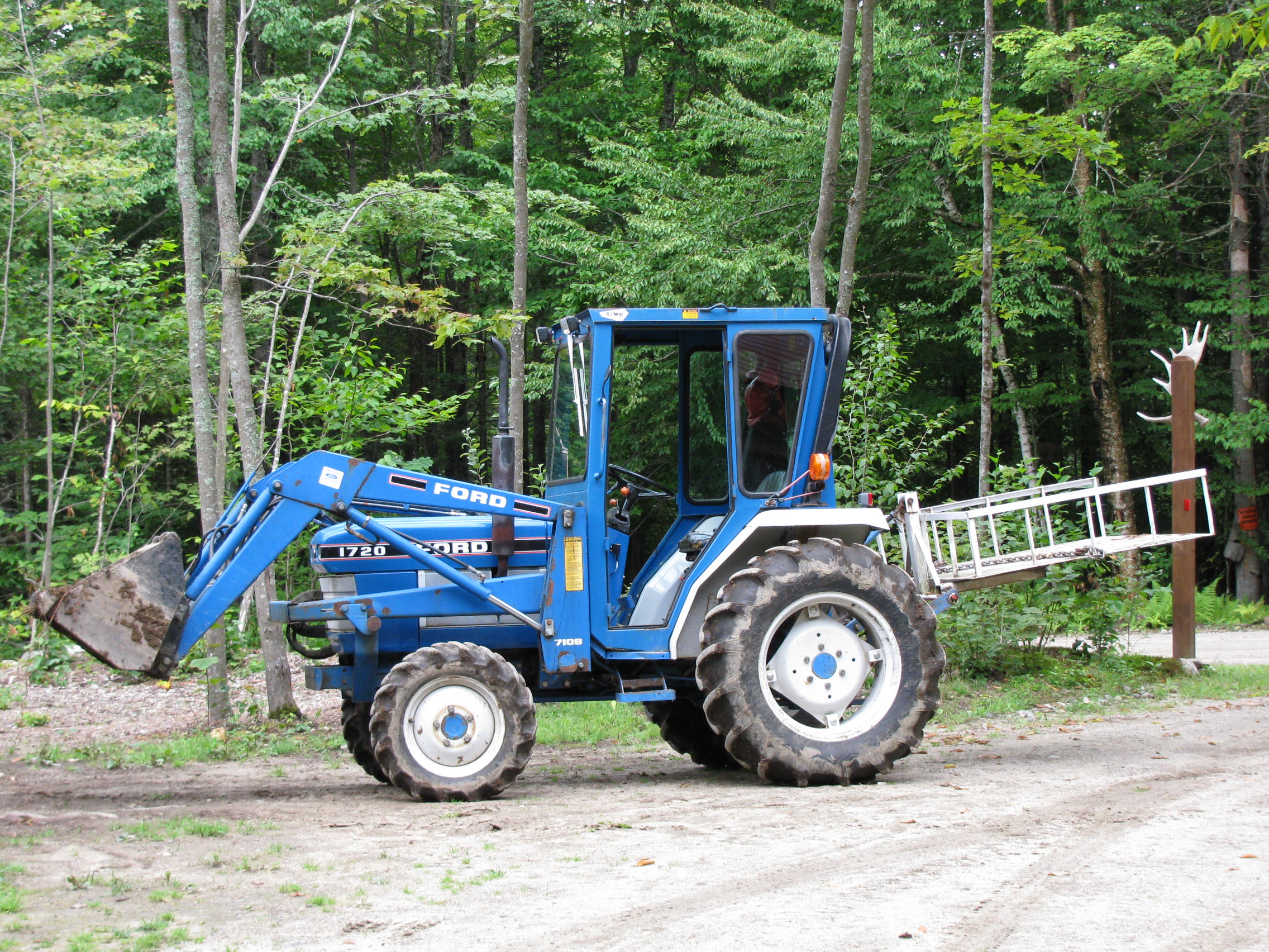

I have a 1992 Ford 1720 with about 2030 hours. It has a sims full metal cab with upper and lower doors with glass. I primarily use it to haul cord wood, Split and chip wood and remove snow. I also use it for improving my lot.
I just bought a used Woods BH with subframe that is being removed from a
'94 1720 NH. The previous owner is going to give me the parts for attachment and Hydo connection which I will put on my 1720. Then I need to get my 1720 to his place an hour away to attach the BH and bring it home. Seems like a crazy process but the only one we can come up with...
My pto clutch doesn't work but the drive clutch is very strong. I am going to have a mechanic check the adjustment and peek to see if the pto side is rusted.
