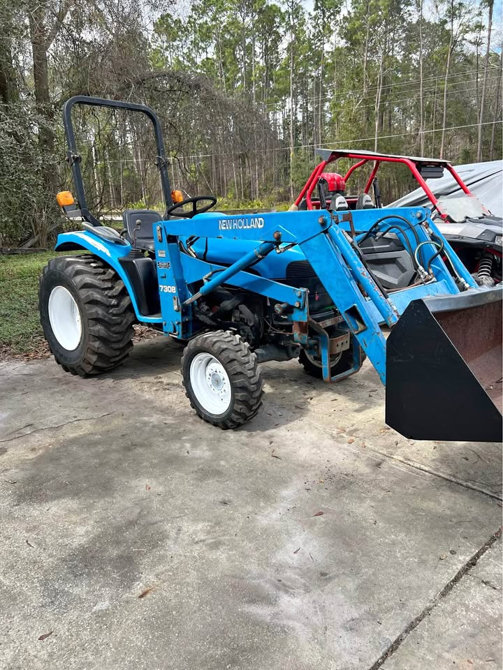

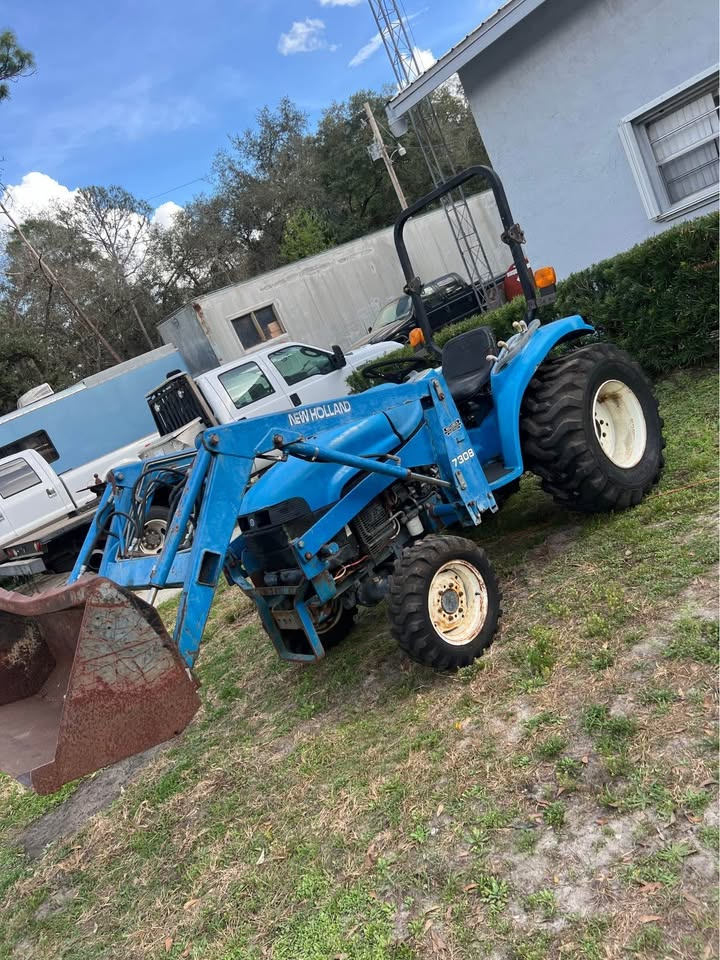

I don't need much of a tractor, just around the home 5 acres clearing a little brush hog, 25hrs a year.
Found this one for under 8k, thoughts.
I know it's older and bucket is pinned and bent.
I know about Tstat removal for over heating but overall thoughts with 1500hrs Hydo drive?
How hard is it to fit inverter for FEL? I guess just match flow rate?
/ New Holland 1925 #2
For the money not a bad deal for 34HP tractor. It has seen some rough treatment - no headlights, front grill upside down, but if everything works and no odd noises or mechanical issues or hydraulic, leaks etc. its worth it.
If you clean it up and put a new bucket or add a QA setup bucket it would be a decent machine.

I had a New Holland 1925, and it was a real nice tractor. I think you could buy a couple of rectangular LED lights on Amazon that would fit in the grill well enough.
Is the bottom of the bucket straight?
Why was it overheating?
Did it ever get real hot?
Does it run in the middle range without a thermostat?
If it is mechanically sound, that's a good price for a pretty capable tractor.

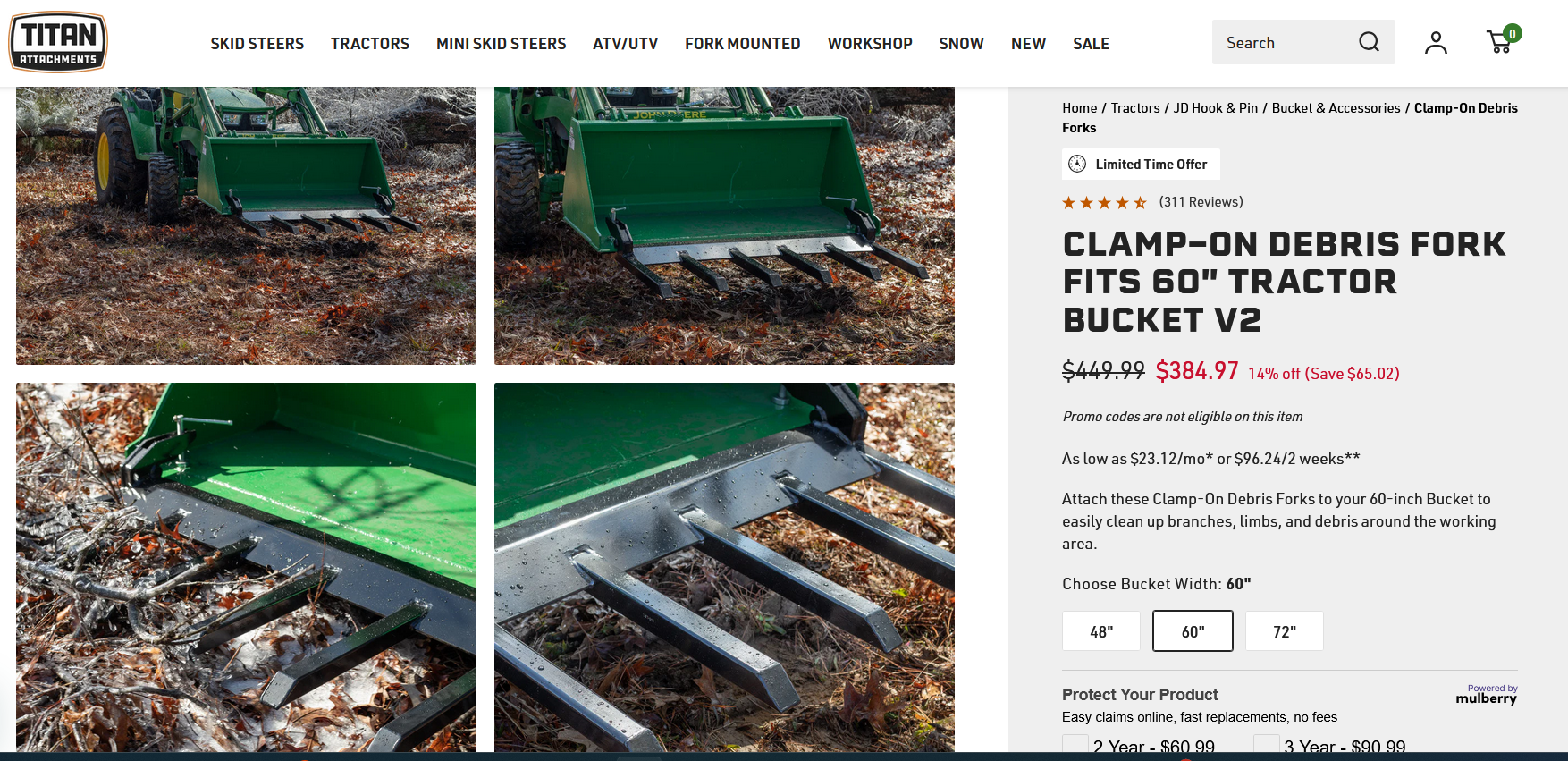

If you are looking for a grapple primarily to move brush, it would be a lot cheaper to buy clamp on debris forks.

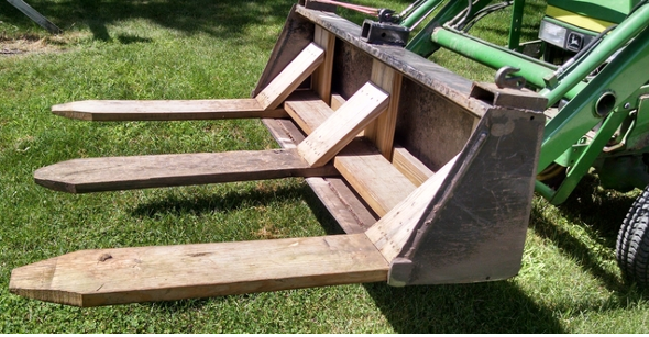

Or, make your own,
