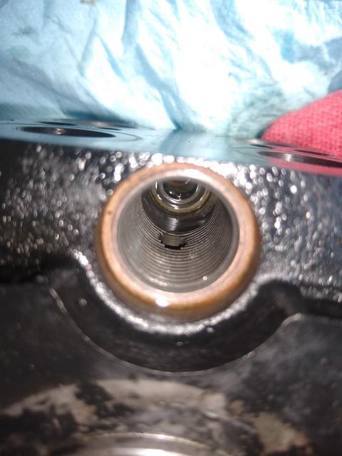

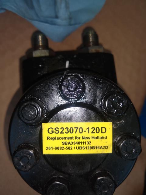

Today I took the orbital valve(steering) apart and I may have found the problem. I also don't know what I am looking at really so I could be totally wrong. :D

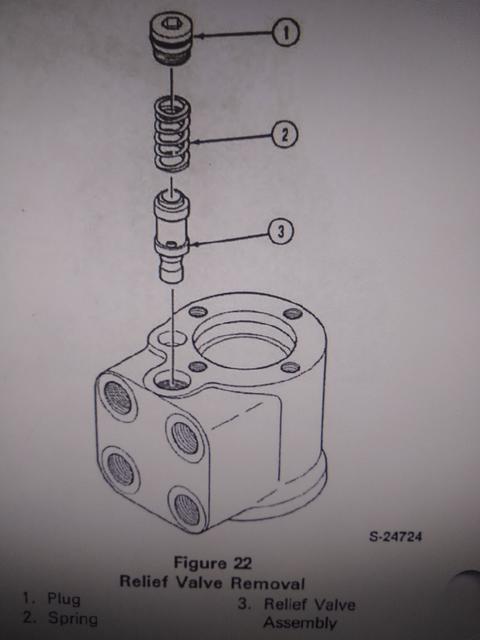

Here is a drawing of the valve(I think it's the same)

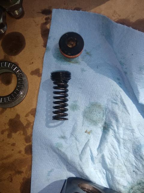

The relief valve I took off my pump(follow number 2 on the drawing all the way to the left).This is the plug for the hole, the cap to adjust the spring or hold it in place and the spring. According to the drawing there is a piece missing. A plunger looking thing.
It looks like it could have been new or reman.
I put it back together because there was no reason to let it sit in pieces. Now air flows through from the pressure port out the return line. I guess I can put it back on the tractor and see if it steers now. Any other idea?

This is what I think the relief valve looks like in mine. If there is a piece in the bottom of the hole(#3) it does not budge.

It looks like you are missing the plunger in the relief valve. If that were the case, you wouldn't get any steering even if the pump was working. You would just pump oil back to the tank. Any chance you dropped it by mistake? Could be a rebuilt that was rebuilt wrong.
I believe the plunger is missing, it would be nice to see a picture of one. I didn't drop it...
I went out to double check and found it on the ground. Dang it. Glad you asked, I had everything laid out as I pulled it apart.I thought there was zero chance I dropped it. Going to put it in and test it with air again.
