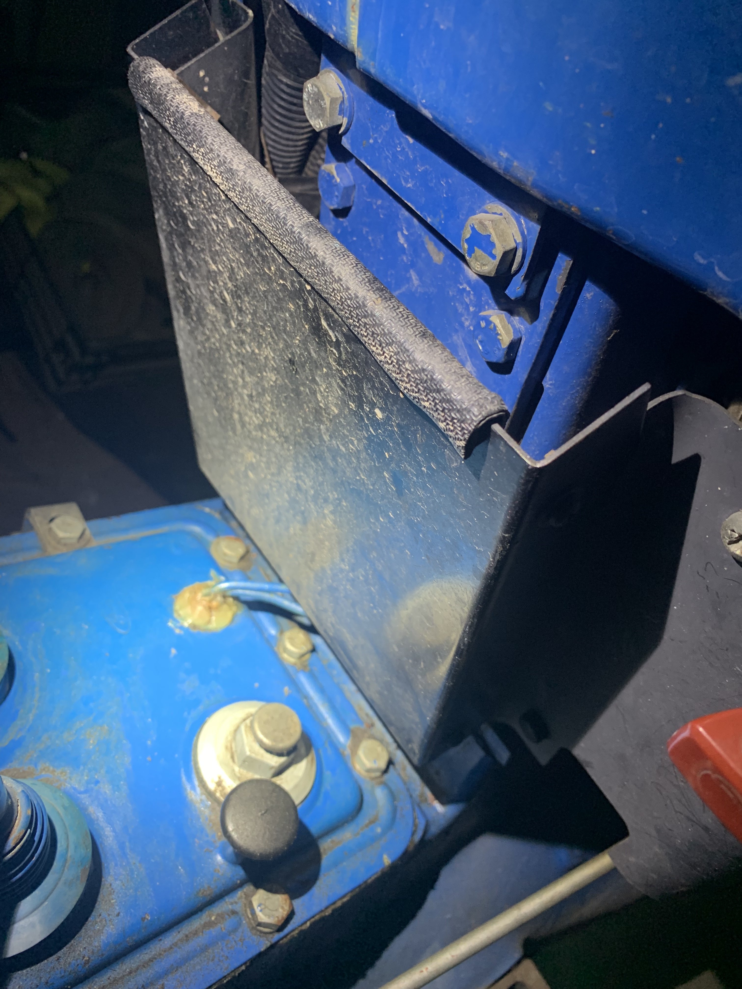

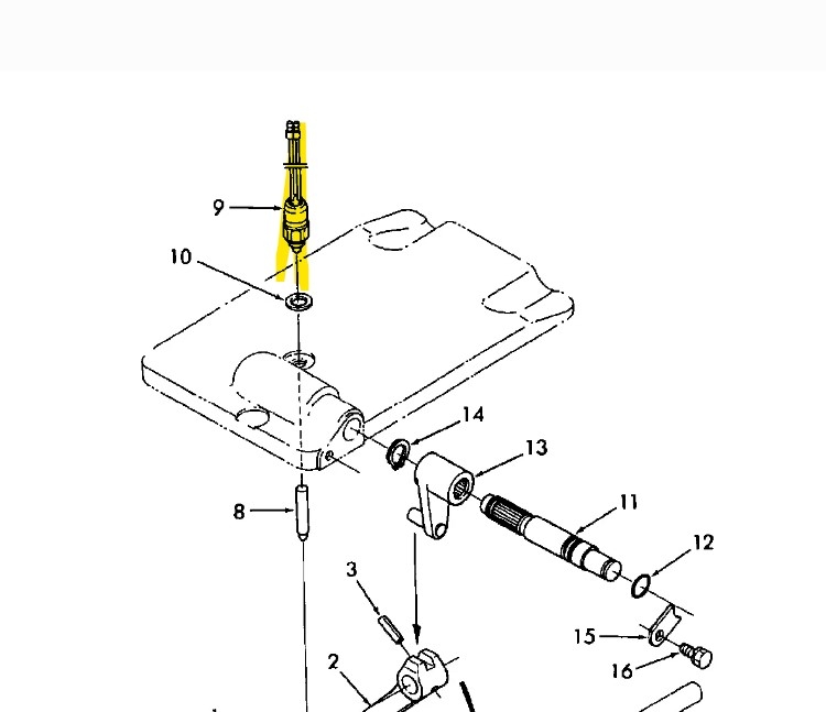

I have a 1996 New Holland 3930. I replaced the safety switch and wiring harness along with transmission cover gasket. I have transmission oil slowly coming out the safety switch wiring as it exits the cover. The filler cap and the small breather vent cap is located on top is approximately 6” away from wiring but shows no oil leaking and the vent is clear. I purchased another wiring and gasket and installed again making sure everything is installed properly. I’m still having the same problem with this 2nd install. Oil level is ok. Any Suggestions?
