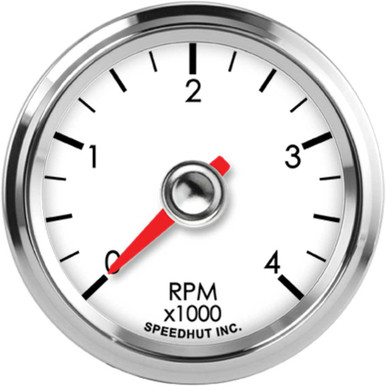

Yeah, My dash is mostly dead from the canbus short. I wired in new RPM, oil pressure light, temperature gauge, hour meter. The fuel gauge still works, it doesn't go through the ecu.
The hour meter I did on a 5 pin relay with the oil pressure light controlled by the oil pressure switch and powered by the key. Oil pressure light is normally open pin, hour meter is normally closed pin.
The ECU seems to still be running the glow plugs for me, although the light is dead. I haven't verified with multimeter but it started in the winter so... I need to do a glow plug light.
I need to put in another temperature switch to an alarm and light for overheat condition, since that protection is gone.
Good idea on the fuel return. Someday i want to get rid of the egr, air pump, etc.
Can you explain what RPM and hour meter you used? Also how hard was it to wire in? Having the same issue with a mostly dead dash and not having RPM is driving me crazy.

I used this tach:
Spendy, but quality. Theres probably something cheaper on amazon, but if I remember right I was having a hard time finding lower rpm tachs and all that china stuff has very mixed reviews. It wires into the key circuit for power, a light circuit for backlight, and a wire up to the W terminal on the alternator. It has a button to calibrate the rpm range. I just set it to the high/low in the specs of the tractor and haven't verified with a laser tach yet. Right now the gauge is stuck to the side of the dash in one of these mounts with some command strips.

I used this tach:

Yes I was reading the same reviews about the cheaper tachs and got skeptical about it. Thank you for all the info this is extremely helpful!
