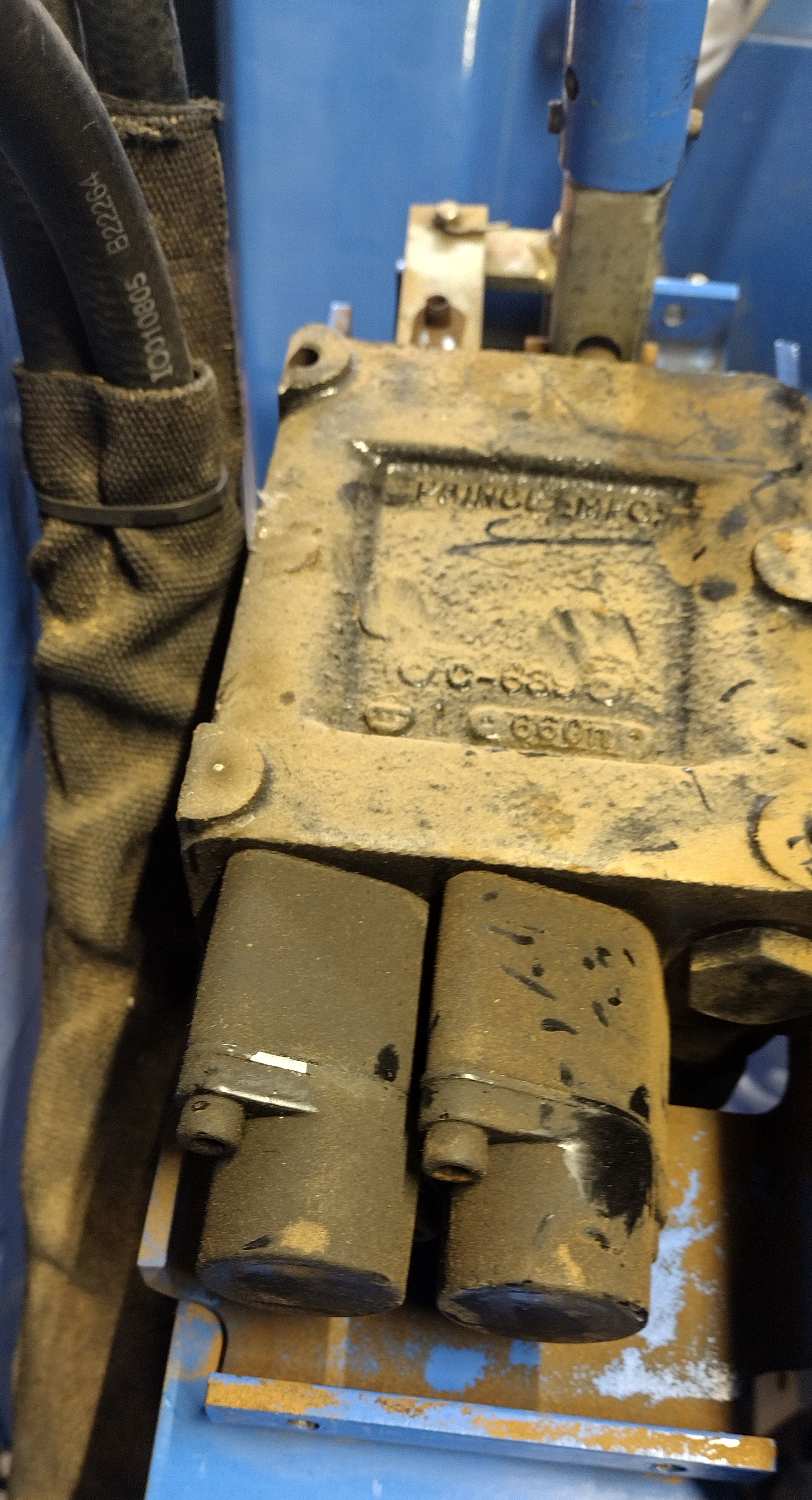

View attachment 1970651View attachment IMG_20241207_133501228_HDR - Copy.jpg

All loader valves that I am familiar with are made as the attachment explaines.
Note there are no internal seals and only O rings to keep the oil in the valve --- better than dripping down your pant leg and into your shoe---- If you look at # 2 in the diagram note the multiple circles arond the center lands of the spool They help the oil seal between the internal lands of the valve, no O rings needed. note 17 and 23 are only used at the ends of the spools Those spools are usually select fit and are usually not interchangeable.
Most loader valves are monoblock -- fancy word for one piece -- and have two spools in one block although they can be purchased single spool and three spool.
A backhoe usually uses a sectional valve with single sections stack together to get the number of curcuits required.
A valve can be activated by a lever, or a lever controlling the valve thru a cable, or electrical solenoids.
When I played with farm machinery the combines used a valve very similar to this except it used a plastic poppet to keep the load from changing. That was until the controlled the header height by an electric controlled valve.

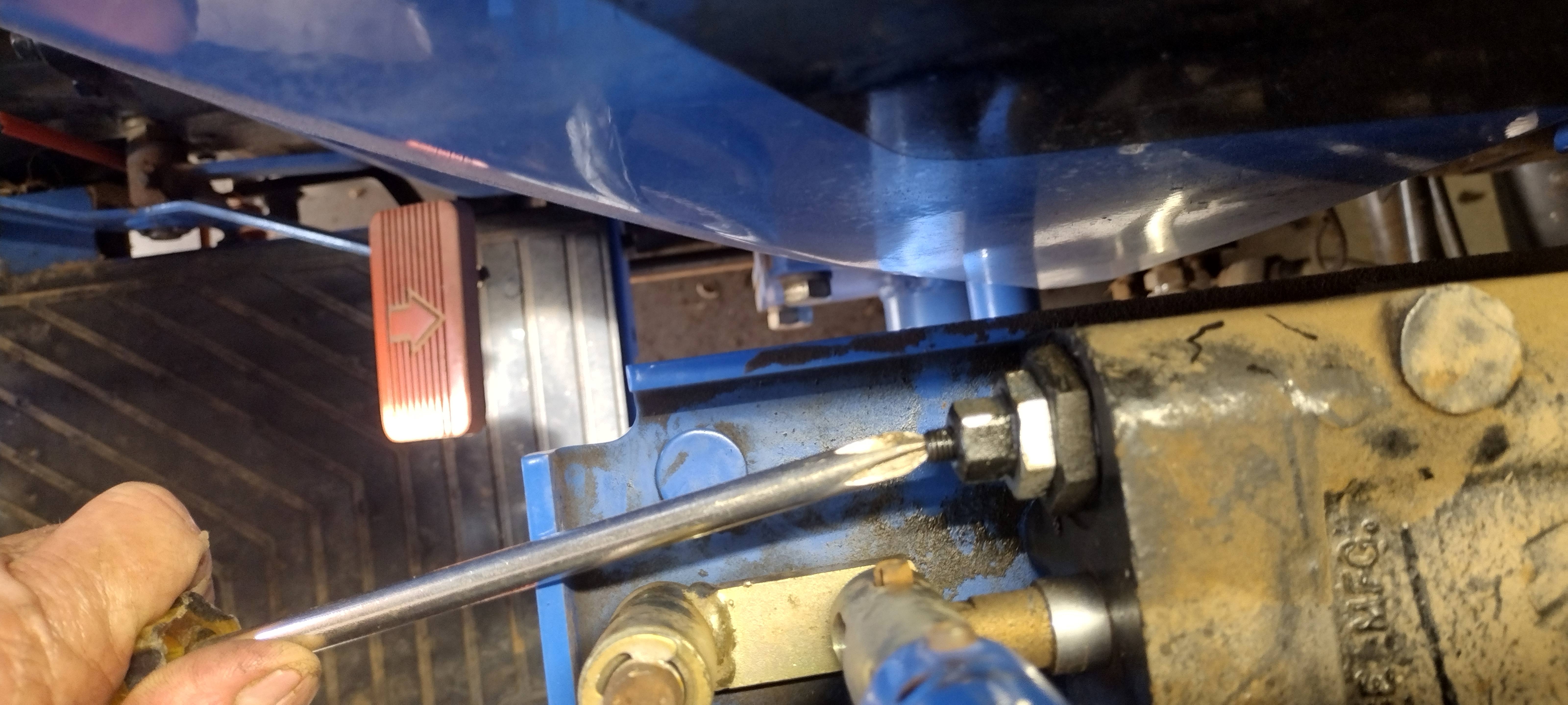

I read your post as bucket not lifting tractor, but loader is limp or floating; got it.
Since it won't stay in float, is it possible the spool has some broken parts in the end cap?
Other question is does the loader hold in position when it is raised off of the ground?
Spool valve is good. I switched the hydraulic connections from the boom to bucket and the boom arms still will not stay down when curling the bucket, and the curl is still strong on the boom connections. It must be boom hydraulic cylinders need rebuilt. Seems odd that both cylinders go bad at the same time????
