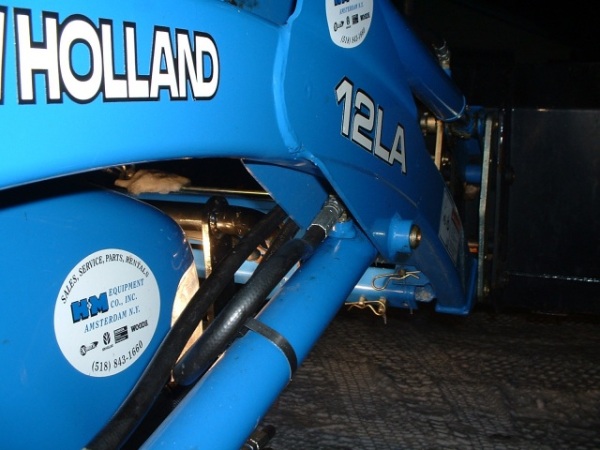

I went out to look at mine and it is a real problem. On mine, more so on the right (starboard) side. The hydraulic line fitting at the front of the lower cylinder is a right angle fitting and mine has hit the loader arm repeatedly to the point the paint is chipped to bare metal and the fitting shows wear. The other side is also chipped and worn, but not quite as bad. The right side is leaking hydraulic oil slightly, appears to be from the threads of the fitting from repeated stress. No pics as it is dark here in the northeast.
I think it was an excellent call on NH's part. Mine will be in ASAP. I've worked around enough heavy equipment to know what happens when a line ruptures.

I tried in the dark with better results than I expected.
Here is the general view of the hydraulic cylinder location.

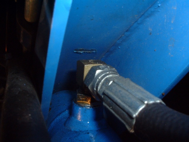

Here is a close up of where the fitting is hitting the loader arm. I set the camera on macro and acutally got a better view sticking the camera inside than I was able to see with the naked eye. Notice the dirty area on the cylinder, this is the hydraulic oil leak. Not much, never dripped. Just enough to coat the area. Who knows how long its been leaking. The other side is not leaking yet.
They probably could do a house call, I'll leave it up to them. I would think a warm shop, which I do not have, would be their preference to work.
Brad

Wanna bet they turn those cylinders over so the fitting is on the bottom?
   / New Holland LOADER safety notice! #10
</font><font color="blue" class="small">( Wanna bet they turn those cylinders over so the fitting is on the bottom? )</font>
That sounds like the easy solution. Of course, our tractors with the 16LA loader have the front fitting on the side, offset 90° from the one on the back. I doubt NH will replace the cylinder with one similar to ours. They'll probably fix the problem the easier way by rotating the cylinder 180°, putting the fitting on the bottom. It will be a bit more exposed, but not get smashed by the loader structure.
You have a special understanding of how these interference problems can happen, don't you? /forums/images/graemlins/wink.gif
