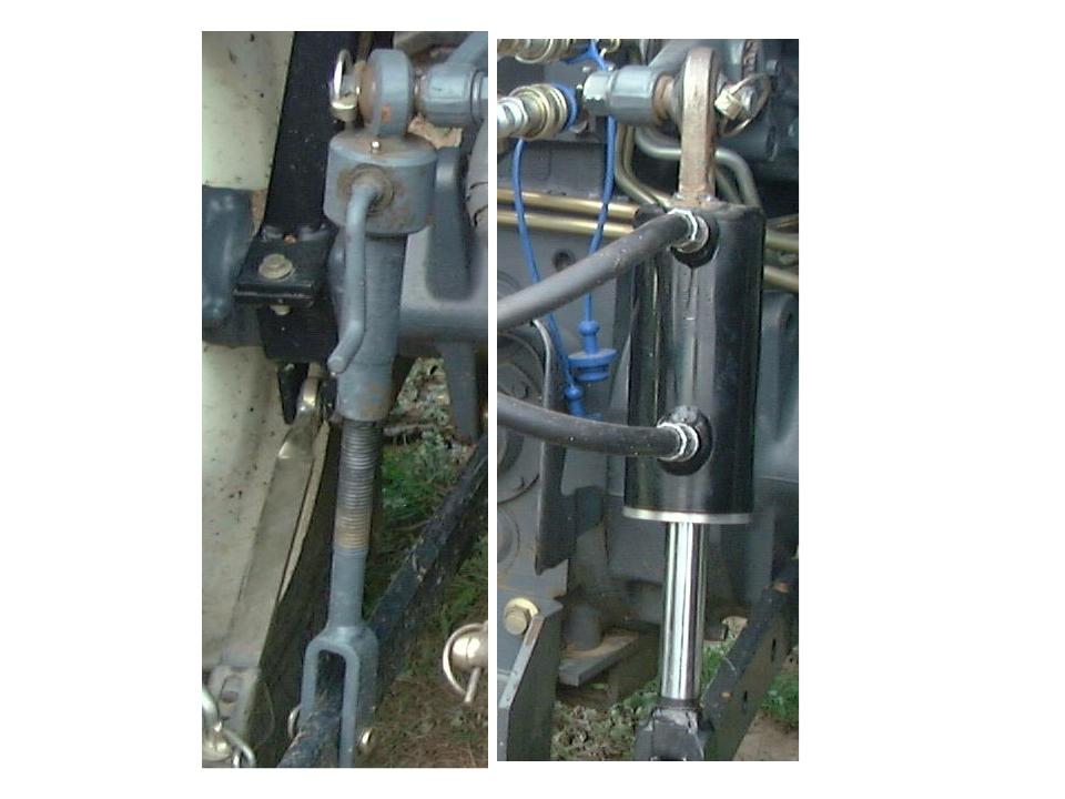

Chuck, as Brian says, you can make your TnT setup work much better by matching the length of your hyd sidelink to your adjustable sidelink. I don't remember exactly what I measured, but I believe my adjustable sidelink was 15" to the center of the top/bottom pins when the jackscrew was adjusted to minimum. As you can see in my attached composite photo, the top ball hitch on the jackscrew it much shorter than the one on the hydraulic cylinder. It will take two cuts and two welds to get your cylinder to the proper length, but if you are going to do it, you might as well do it right. Measure the minimum length of the jackscrew link and then measure the minimum length of the hydraulic link. The difference is what you need to remove from the hydraulic link to make things work perfectly.

Thanks Jinman, so I will shorten the jackscrew link and hyd one as far as they will go correct. When I can put my hands on it again I will check it out, thanks again for everyones help.
