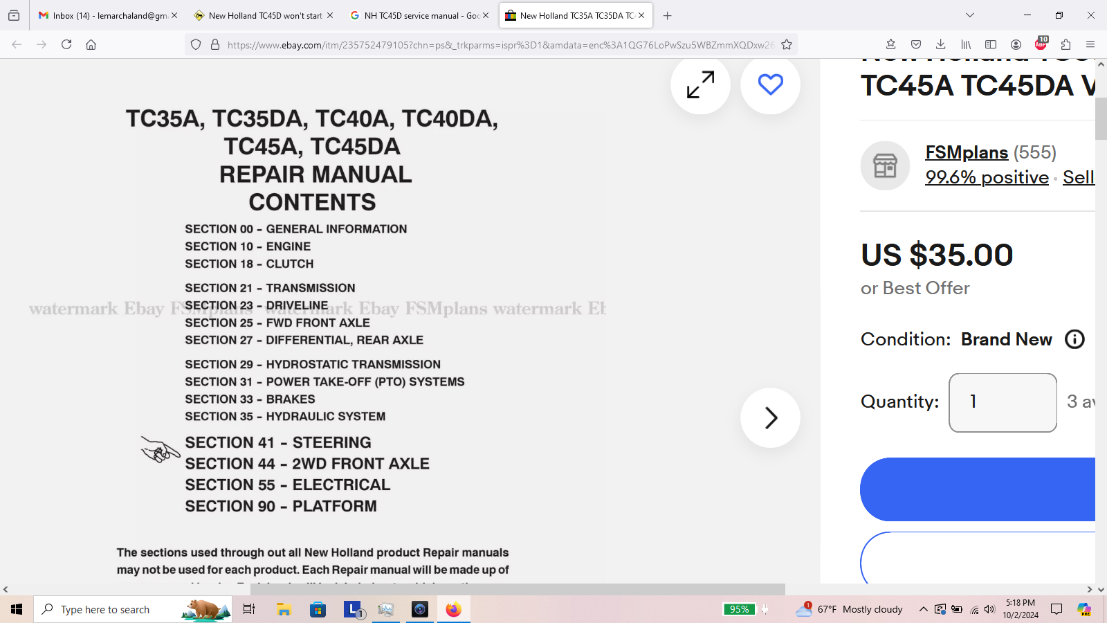

It looks like section 4 of the NH manuals has the electrical, the manual for my NH 8160 is about 4 inches thick.
I did find an electronic down loadable copy for just a few dollars.
This might be a good candidate.
New Holland TC35 TC35D TC40 TC40D TC45 TC45D Manual

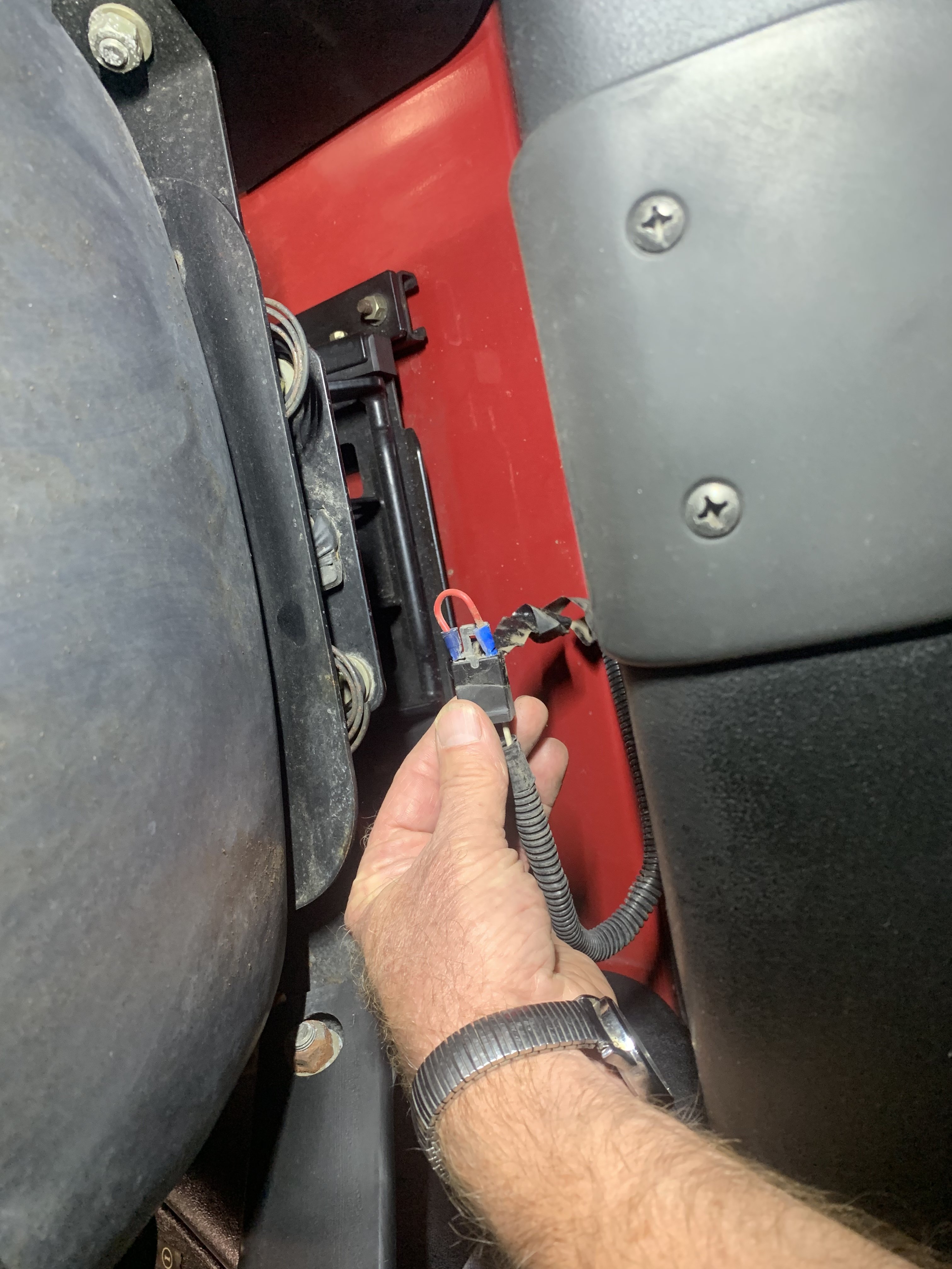

I’ve got a dx35 which I’m quite sure uses the same electrical layout. Before you order that relay have you eliminated the seat safety switch? Easy to do , it’s directly under the seat backrest . Unplug it and jumper a wire across the pigtail connecter. Mines been this way since I bought it used, works fine .
If this seat switch is bad it won’t let power through the relay to fuel solenoid way I’m reading schematic .

The seat switch and the parking brake switch will not stop the engine from turning over, however they will cause the fuel solenoid to shut off... Make sure you check both of those...
If I'm not mistaken there are only 2 type of relays used in the TC's... Meaning you could temporarily swap out another relay to test... but check / bypass seat switch and the parking brake switch first to eliminate either of those as the issue first.

I will have to track the seat switch down as I have never seen it. Bought the tractor used and the previous owner had already disbled it
