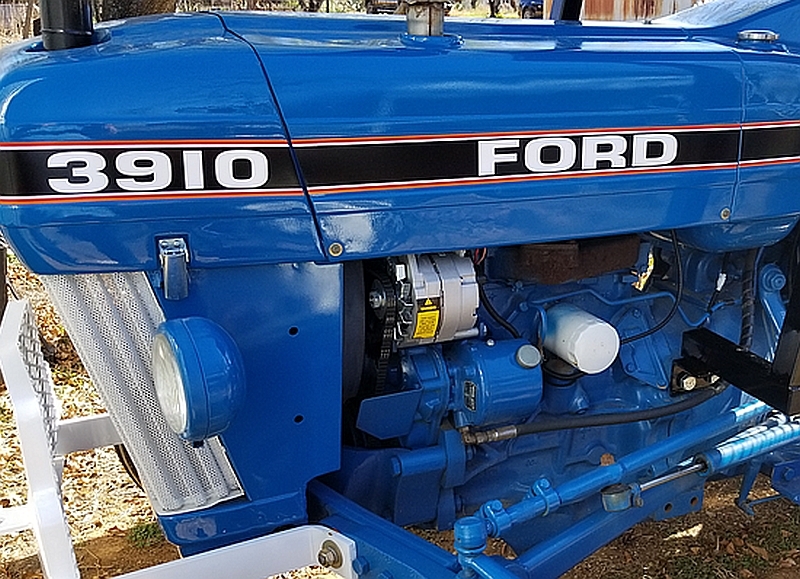

Might be a voltage regulator on the other end of that third wire. In any case, I'd be doing a conversion to a GM alternator if that's where the trouble is. You can get those for $60-70.
Here's mine on the Ford.
